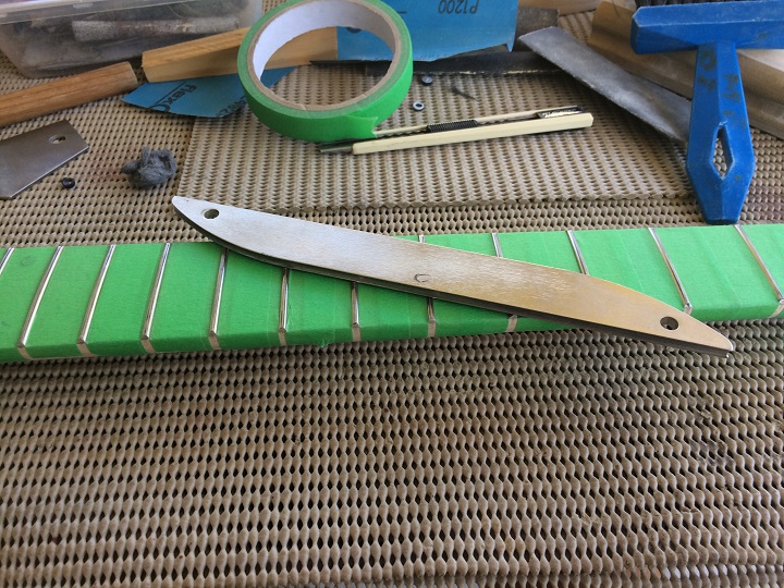

    By now some (or most) of the frets have a flat crown so it’s time to get out the Fret File and re-crown the frets and get rid of the flat spots. Mark each fret with the felt pen as before, but this time you want to leave a very thin line of ink running down the centre of each fret. Be sure to try and leave some ink the full length of each fret. The frets should now be nicely domed. It’s a good idea to check them as well with a Fret Rocker just in case there are some obvious boo boos.
    Fret File

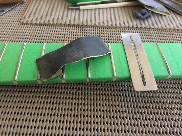

    Fret Rocker
    Then polish them up with wet and dry paper and finish with 000 then 0000 steel wool. When you’re finished you should have removed all the files marks from the frets and they should be nice and shiny. Being a belt and braces kind of guy I will also use a fretboard protector…… you know, just in case.

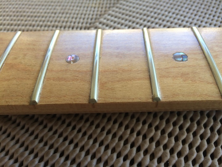

    I am usually a devout Tru-Oil man, but seeing as I still had some MinWax Wipe-on Poly left over from my last guitar I used that instead.
    The fretboard got about 14 coats of Poly, the neck 7 coats and the headstock the full monty, 21 coats. It has ambered up a bit more than I had hoped, but I don’t mind it. I think it might be getting a bit old and thick. Oh, hang on, I think that’s me.
    Fretboard
