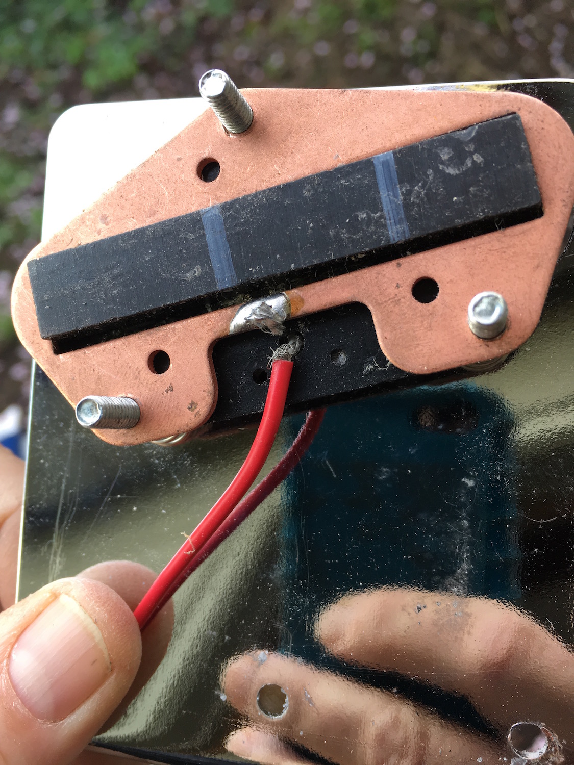

    Can someone field another dim question for me? Shouldn't there be an earth cable attached to this bridge pickup..?
    Mark

    Hi Mark, the earth usually goes from each of your pots to the bridge plate, not from the pickups. See the link below:

    Hi Mark. Yes, the bridge plate is normally connected to the pickup ground wire. From your photo, from the blob of solder on the bridge plate it looks like the braid on the red wire was once connected to the solder, but wasn't soldered well and it's pulled away from it.
    Cue Mission Impossible music....
    Your task, should you wish to accept it, is to do a better job and reconnect it so that it doesn't pull off again. It might be easier to wrap some bare wire round the braid, solder that to the braid and then solder the wire to the base plate.
    https://www.pitbullguitars.com/wp-co...f/PBG-TL-1.pdf
    Oh, ok. Thanks Franken
    This post will fail to self-destruct in 5 seconds.
    Once I've done all that I'll have to go and lie down in a dark room, with a cool flannel over my eyes, and a mint juelp in hand..

    You'll be right. I think making a little bridge wire as Simons suggests is the most sensible approach. It'll give you a bit of flexibility with moving the wire around during install and you won't have to worry about it pulling away again.
