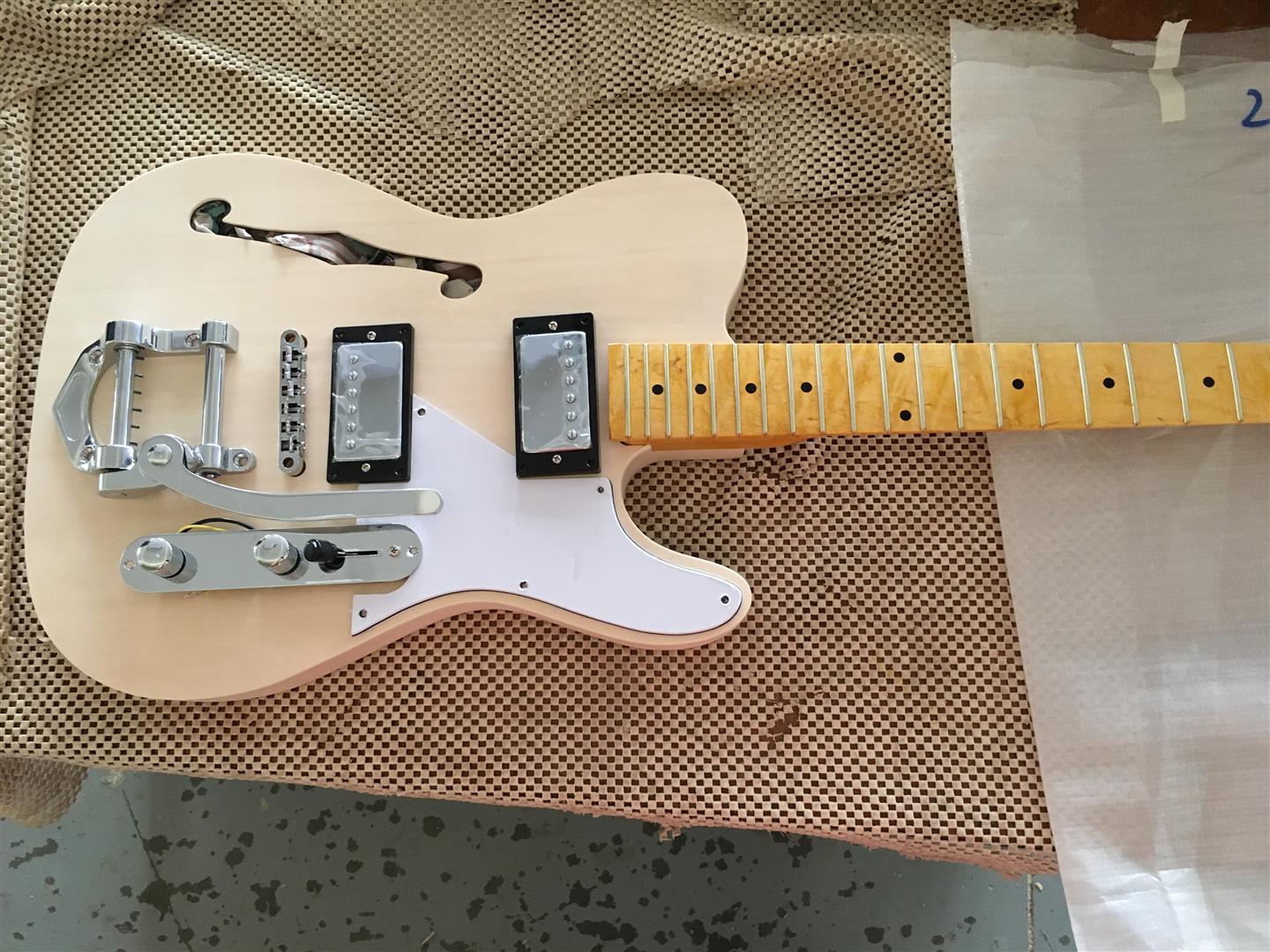

    While waiting for neck to cure, I revisited the body mock up:

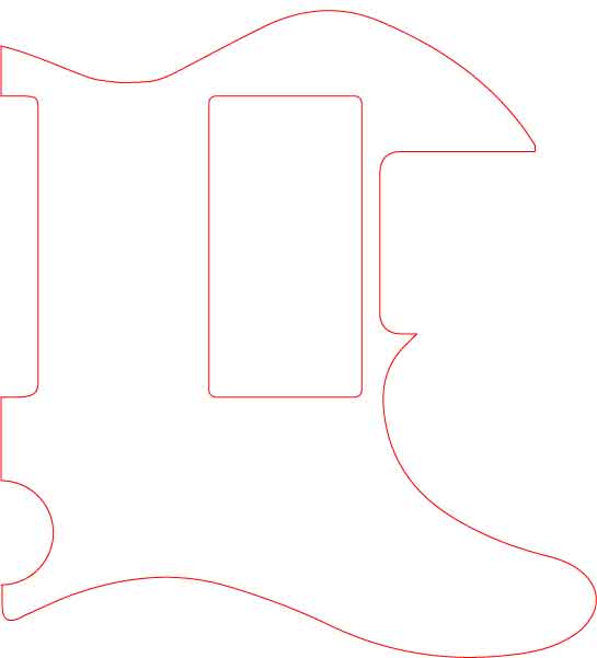

    As I wanted to fill the void underneath the 22nd fret, I considered making a custom pickguard.
    The kit pickguard is of a weird shape for the TL-1TB kit.

    Looking at other people who have built this, none of them seem to have used a pickguard at all, maybe that shows that most have mixed feelings for the custom pickguard.

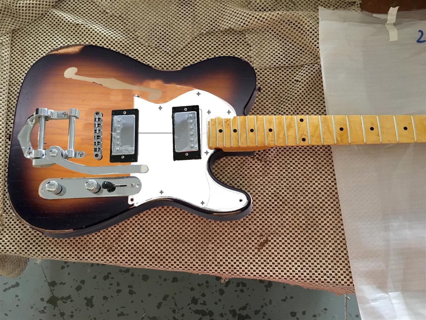

    I used Adobe Photoshop, and Illustrator to make a new pickguard which takes into consideration of the 72 thinline tele, the stock PitBull One, and a standard tele to frankestein a new one.

    I printed a few copies and cut them out to make sure the holes are at the right spots.

    Won't be able to achieve a 3-Ply effect with a custom one, but I should still be able to chamfer the corners

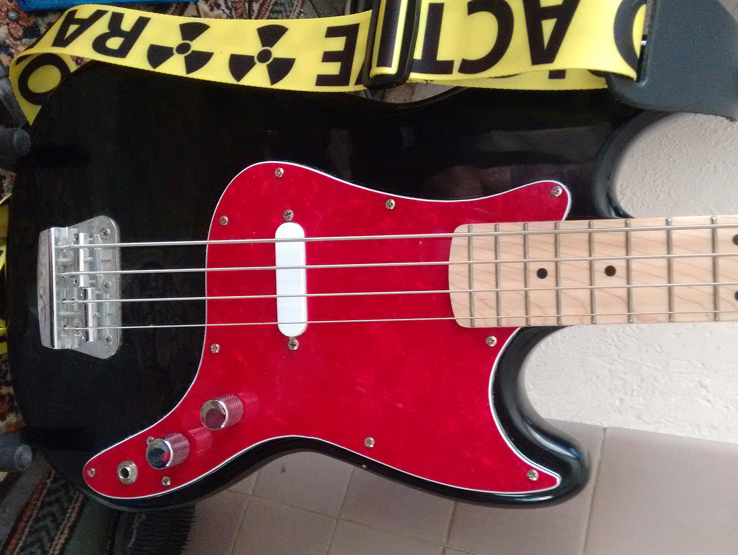

    Quote Originally Posted by Old Tooth Hopkins View Post
    Huh? I bought a blank rectangle sheet of 3-ply red pearloid off e-bay.
    Turned out too red for my taste but managed to carve one out for my daughter's Bronco bass.
    cheers, Mark.

    This was just standard acrylic sheet. I am not so fussed about the 3 ply effect personally.
