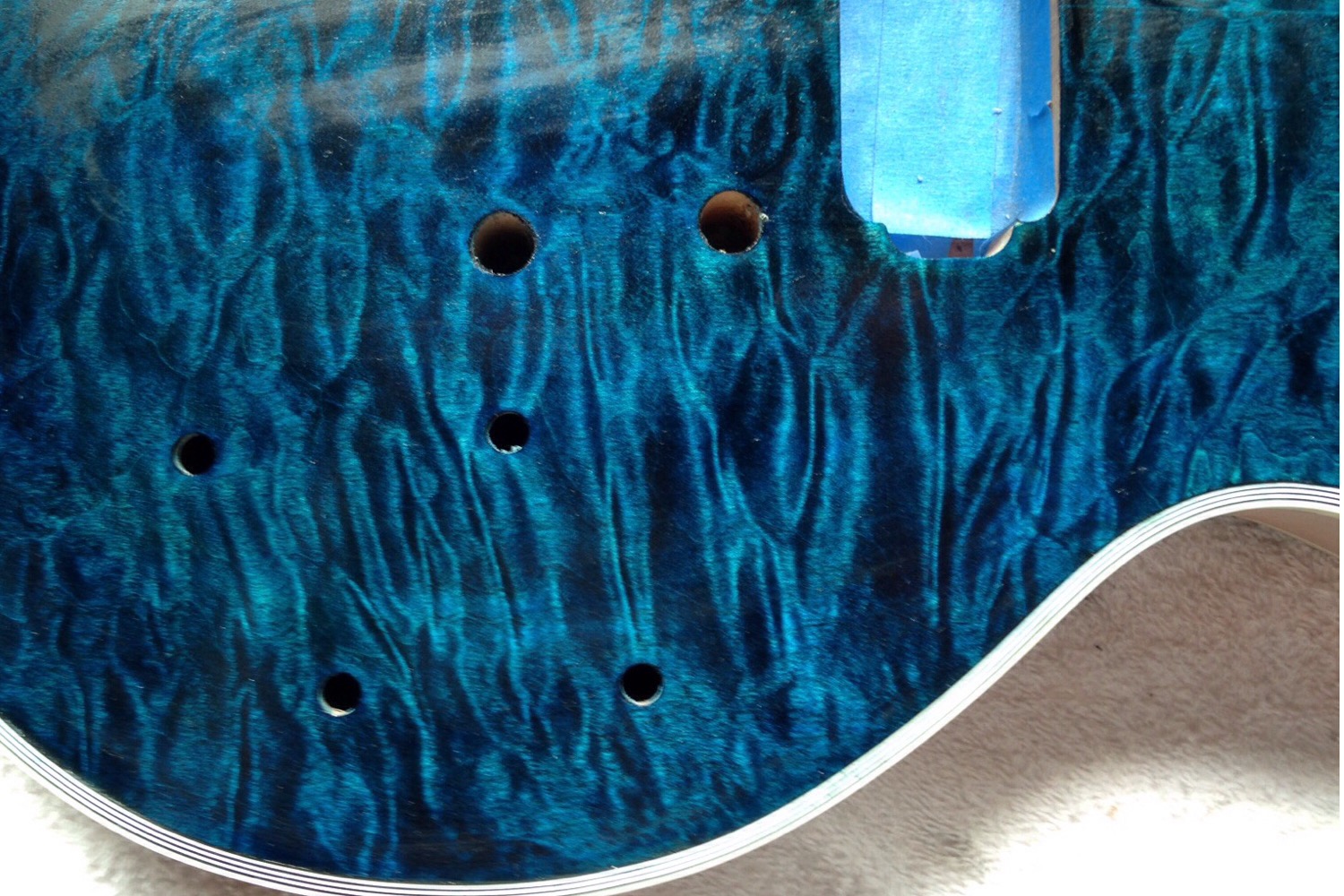

    I have now put a couple of coats of oil on the top of the body , the first 3-4 coats have been largely absorbed into the timber. This las coat see picture is the first to get some gloss to the finish. And it is starting to look good

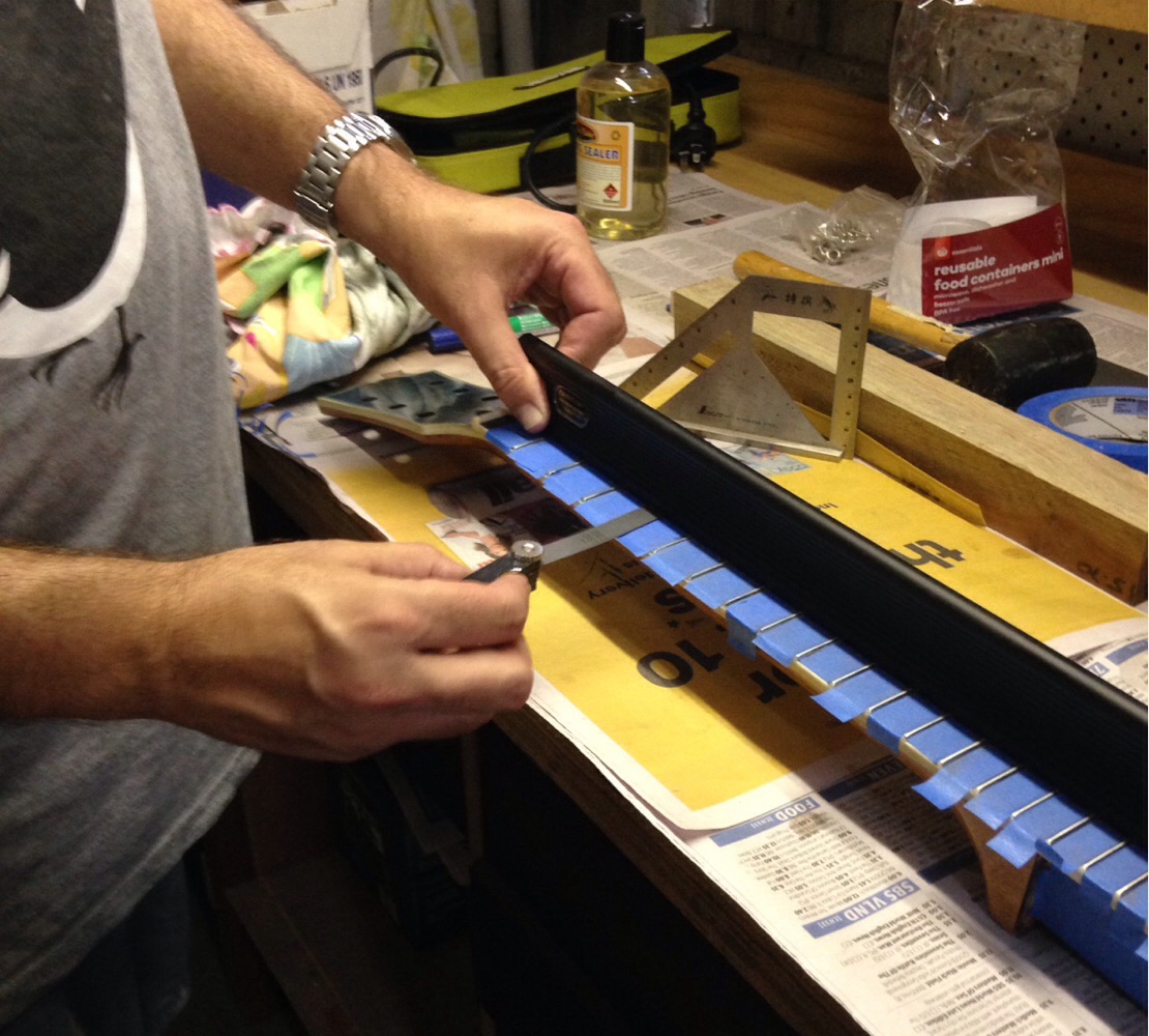

    While waiting for oil coats to dry, I decided to look at the neck and the frets and to try to level them.
    Using a straight edge I checked the neck as it came from the factory, it was slightly convex, as should have been
    Using a small square I found 2 frets that were sitting high.
    I then used the truss rod to straighten the neck and put the straight edge on the frets and used a feeler gauge to look for high and low points
    I used a blue marking pen to highlight the frets and used some 320 grit sandpaper around a piece of milled hardwood to carefully level the frets

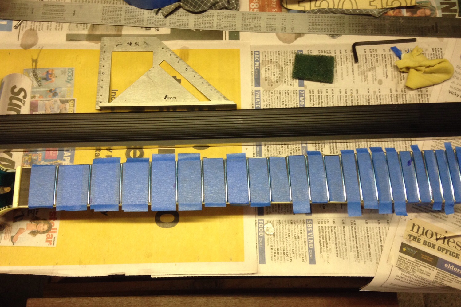

    To check flatness I put the straight edge back on the fret board and tried the feeler gauges again, this time it would not go under any of the frets.
    I believe I now will need to reprofile the frets.

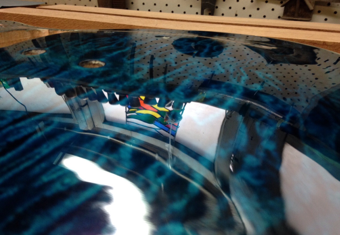

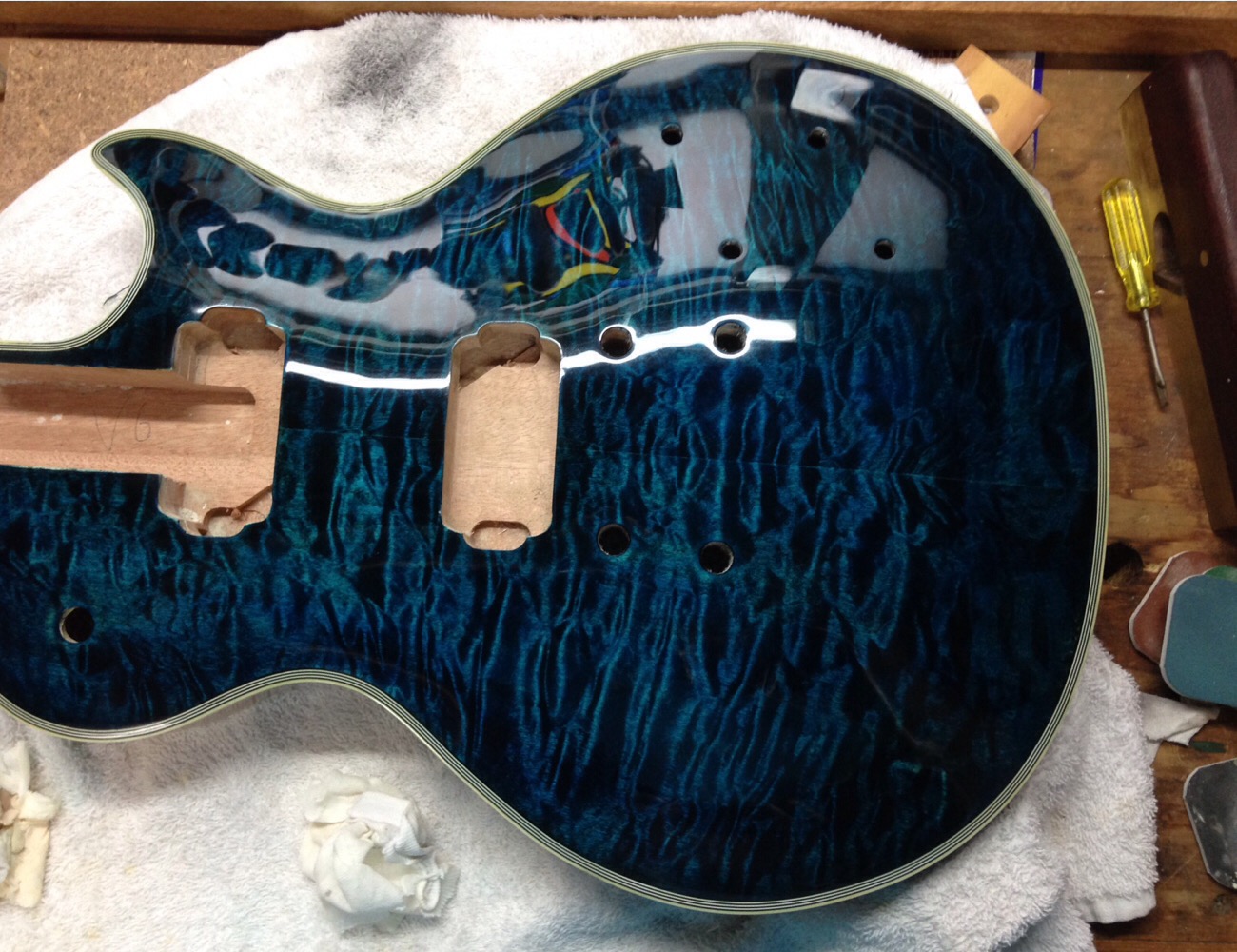

    I have allowed the Tung oil to cure for about 10 days, the body has then been wet sanded with 800 , 1500 and 2000 wet and dry sandpaper
    It has then been polished with meguiar's ultimate polishing compound
    It is getting a lovely mirror finish.
