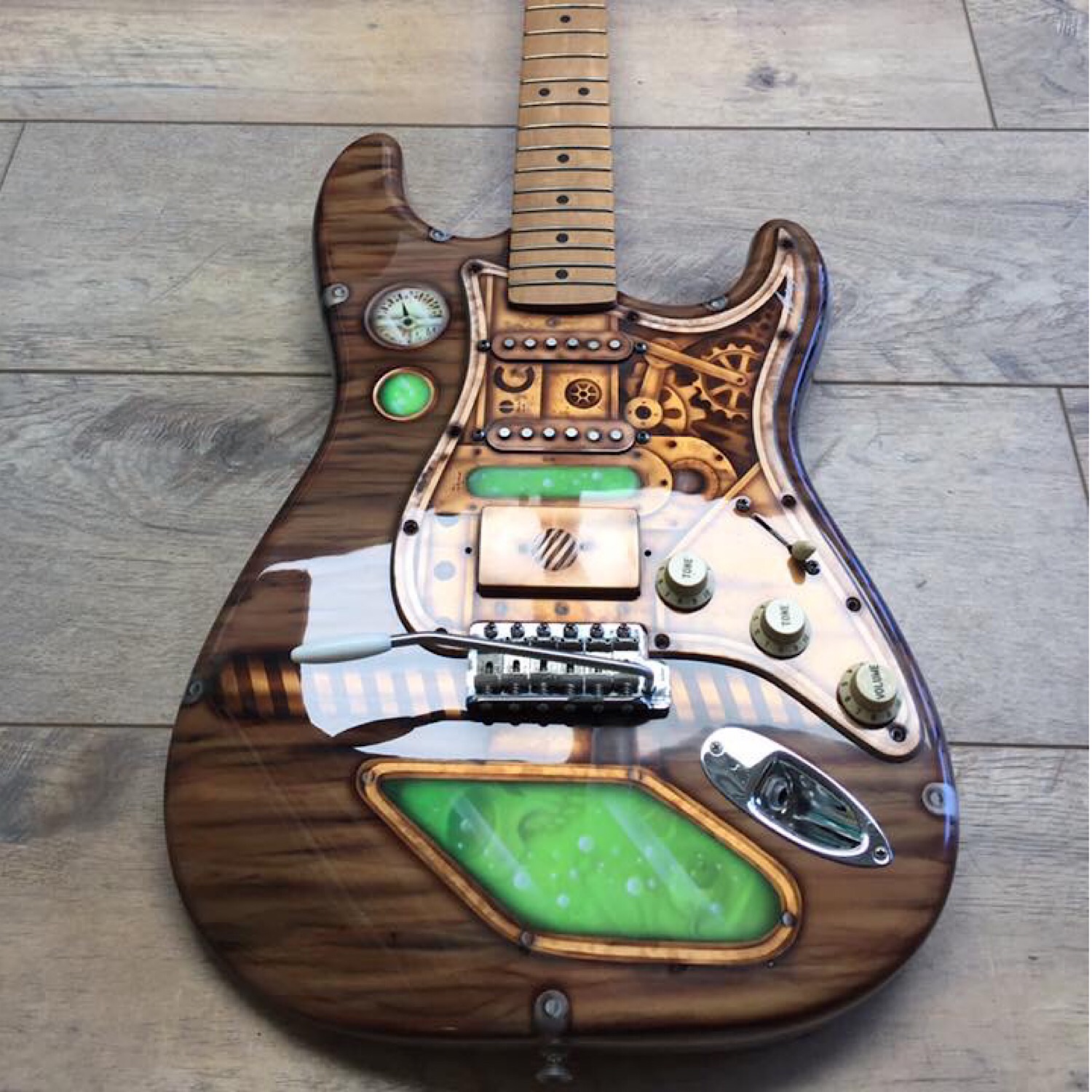

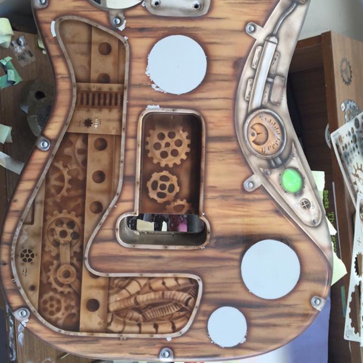

    Hey Sonic, I found a couple of pics of an air brushed steampunk by “Holdfast custom paint and guitars” thought you might want a look. Might help you out a bit.
