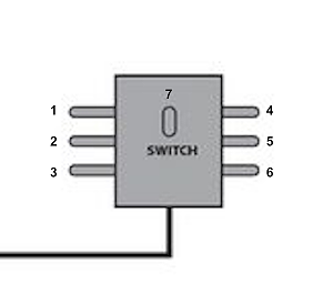

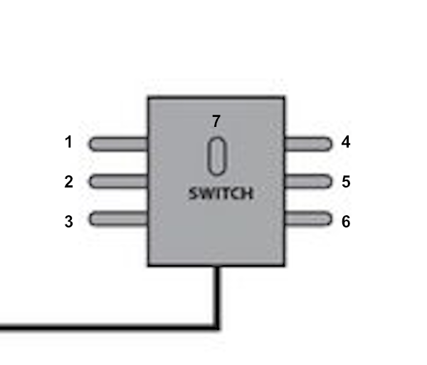

    Yep, as per above, I'm assuming the switch works like this:
    Across the 5 positions:
    1+6 -> 7
    1+2+5+6 -> 7
    2+5 -> 7
    2+3+4+5 -> 7
    3+4 -> 7

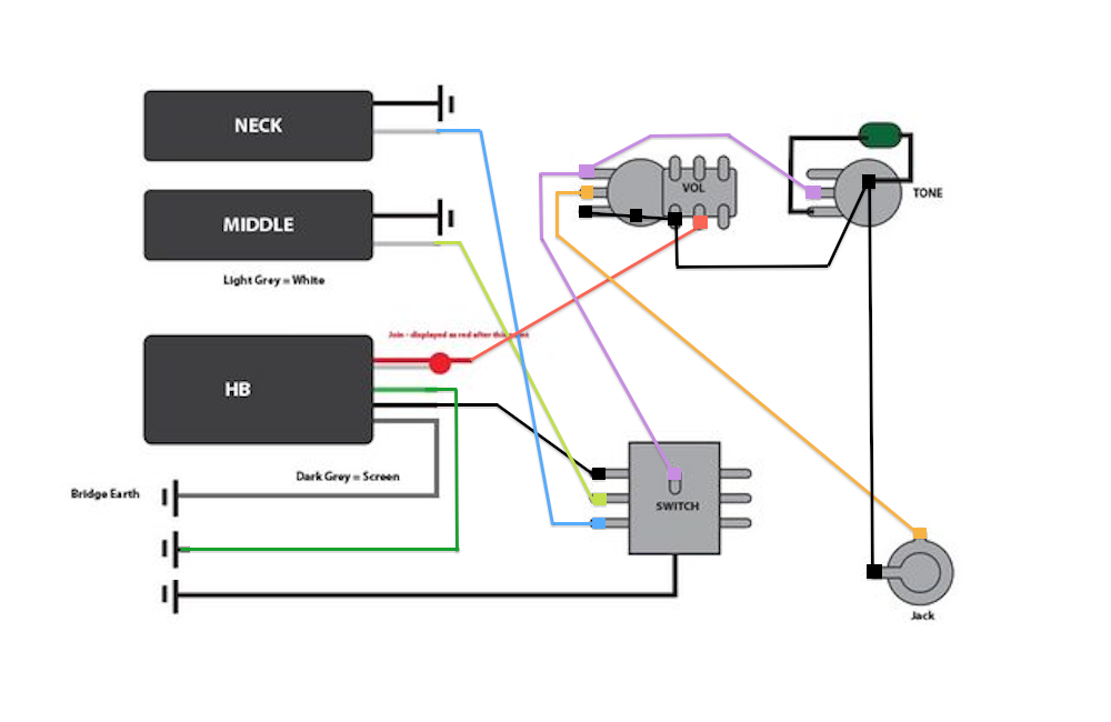

    If it does, then this should work for your wiring:
    If your pickups are a mix of different manufacturers then there's a chance you could have some phase issues, and/or not get hum-cancelling combinations when the bridge is split. But, that can usually be solved by swapping the way the humbucker is connected or its coil ordering.

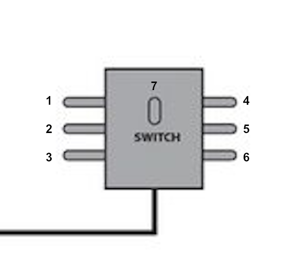

    1+6 -> 7
    1+2+5+6 -> 7
    2+5 -> 7
    2+3+4+5 -> 7
    3+4 -> 7
    Attachment 24436
    Now, as payment we need to to dress as the princess, re-enact the above scene and post the video here...
    Good onya WeirdBits, that's actually very similar to my solution, some Humbuckers use a green wire as the main signal-out wire and use the black wire as the ground wire and then the red and white wires are soldered-together.

    I take it the tone/jack should be earthed to the back of the volume pot as well?
    Yep, that's what I was indicating with the black from the push/pull to the back of the vol to its lug and then a ground point.
    Typically, you run the ground from the jack to a single point, like the back of the tone pot, and then connect all the grounds to that point. You could connect all the pickup grounds together at the switch and then run a single ground to the volume and then to the tone etc.

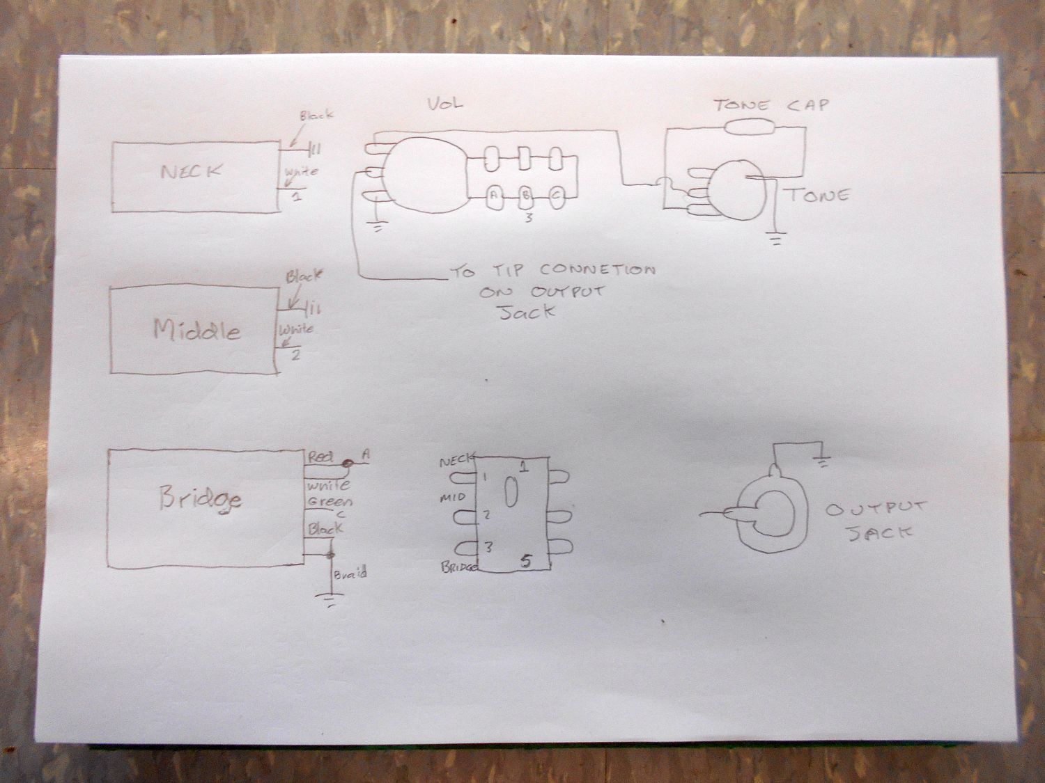

    Here's my wiring solution:
Name:	Wiring Solution_resized.jpg
    Hope it all goes well, let us know if you encounter any more problems.

  8. #48
    I think I'm all good. Thanks again to both of you for working through that, it makes sense now I can see it, I was over complicating things, all good learning.
    I have after school/dinner duties today, but I'll try and get back out to the workshop and and wire it up later this evening. Or possibly in the morning as its a public holiday....
