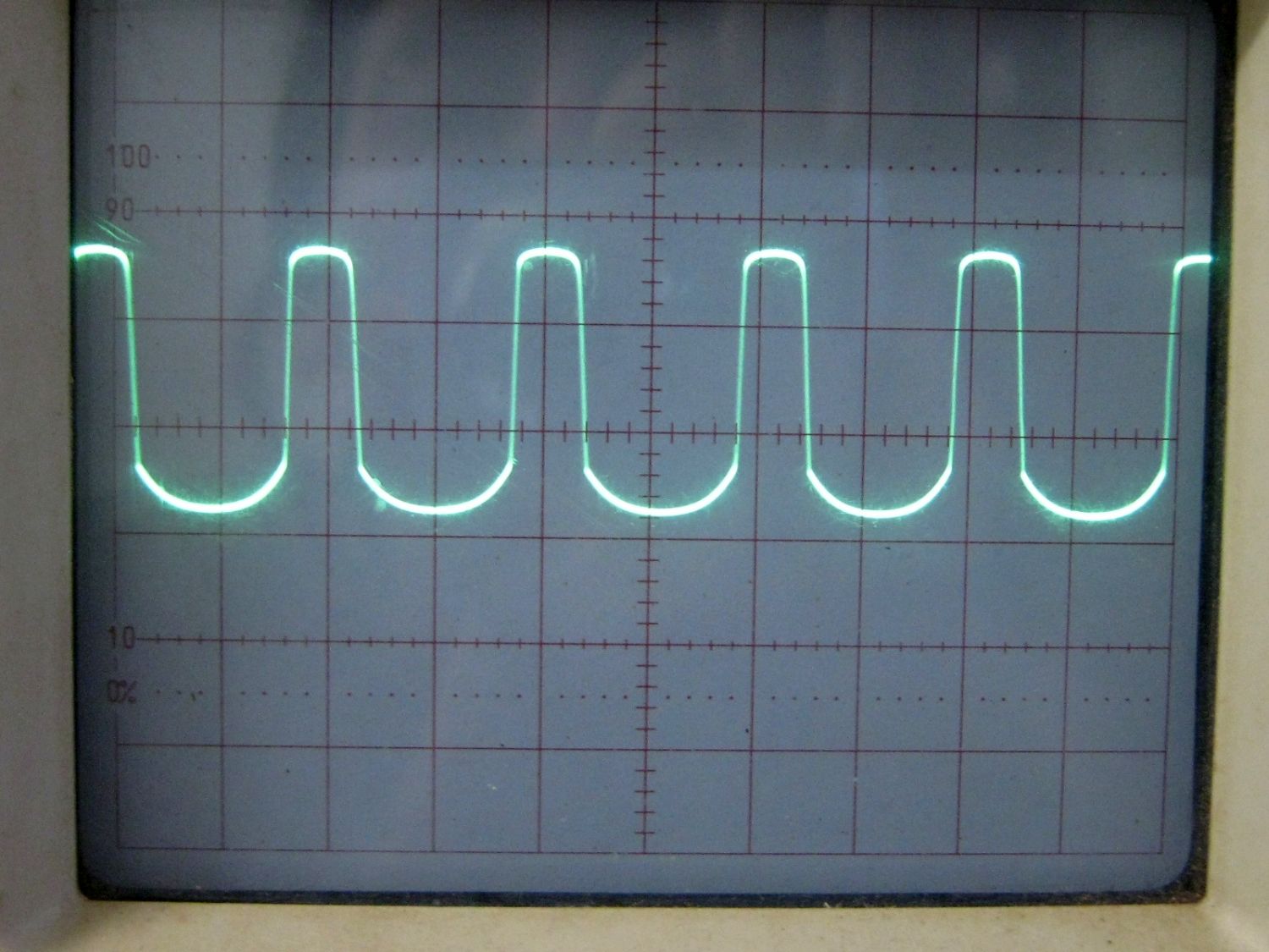

    You could also try replacing the collector resistor (typically an 8k2) for the second transistor with a 10k trimpot, this will allow you to easily set the collector voltage to around 4.5V, the smaller value resistor (330 ohms or 470 ohms) can then be increased to 1k to increase the output level a bit.
    As a sidenote, the collector voltage on the second transistor plays a big part in determining the sound you get out of a Fuzz Face, if it is around 4.5V, the result is a smooth squarewave sounding fuzz tone, below this the Fuzz Face tends to sound a bit sputter, which some guitarists tend to like, above 4.5V, the Fuzz Face gets really smooth, but you also lose a bit of sustain. most of the commercially manufactured Fuzz Faces tend to be biased so that they clip the signal asymmetrically, I seem to remember playing around with the Fuzz Face circuit, after breadboarding it, and managed to take some pics of the waveforms I saw on my Oscilloscope, I think I still have the pics on one of the slave HDDs in my studio PC, I'll post them here as reference.
    I managed to find this one, if your Fuzz Face build is working and biasing correctly, you should see a waveform like this on the first transistor's collector, the waveform on the second transistor's collector should look like an inverted and more sharply clipped version of this waveform (assuming that you've set the Fuzz control to maximum):
Name:	First Transistor Collector Waveform_resized.jpg

    The exact results I got Doc are a bit hazy as I did measure lots of things lots of times, however 8.5V seems to stick in my head as the collector voltage on Q2. And I can't be sure but I think it was set there pretty hard.
    When I drove the FF with the Comp I did get a asymmetrical waveform similar to the picture you showed. Mine was much more squared off in shape, and the squaring off varied slightly depending on the frequency. Lowering the signal generator input level could result in a sine wave pulsed shape, and with full gain and enough drive will result in a near on full square wave. So I'm sure the circuit works, but as you say it needs the right bias and where to set that bias to is the million dollar question. Seems like a Q2 collector of 4.5 to 8V would be the optimum range.
    Yep, I agree with Q2 being biased anywhere from 4.5V to 8V, based on my experience from breadboarding the Fuzz Face circuit using the standard resistor/cap/pot values, to my ears, any Q2 collector voltage from about 4.0V to about 6.0V tended to produce a pretty good sounding Fuzz tone, for Silicon transistors the sweet spot seemed to be about 4.5V, and for Germaniums, it seemed to be about 6.0V, that's assuming that Q1 had an Hfe that measured around 82, and Q2 had an Hfe that measured around 120, I noticed that if you substituted a transistor with a higher Hfe for Q1, that increased the amount of sustain you got out of the Fuzz Face circuit.
    The trick is to measure Q2's collector voltage with your multimeter probe directly on Q2's collector solder joint rather than where the 10nF output cap joins at the junction of the 470 ohm and 8k2 collector resistors.
