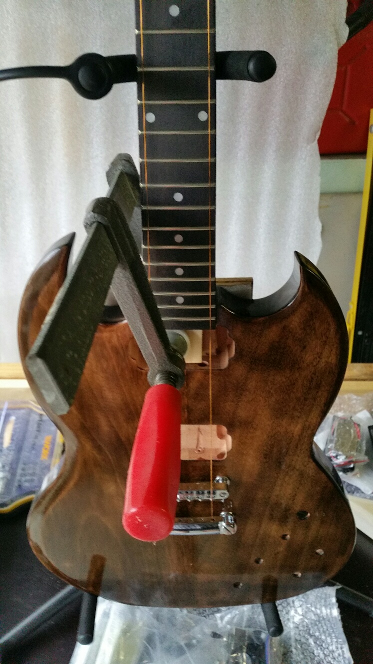

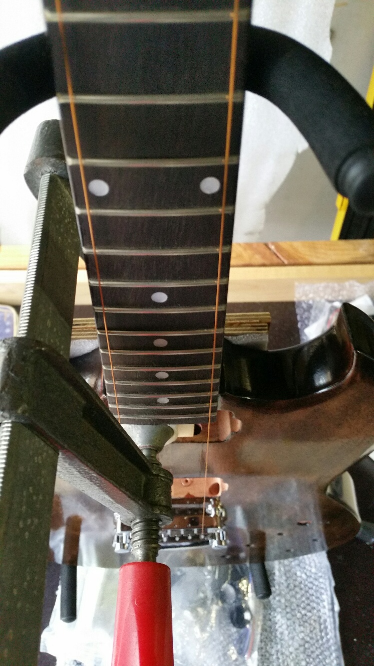

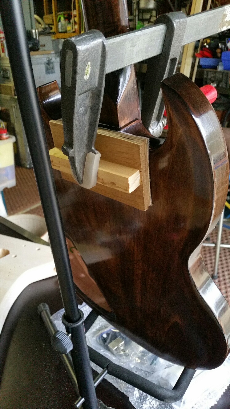

    After applying a few more full strength coats of TO to the body over the past few days I made the choice to set the neck today.
    The 'strings' you see are 0.5mm enamelled copper wire held taught at the headstock with only a little twisting. The wood pad on the back of the body is a purpose made device with high density bubble foam attached so as to protect the finish on the body while spreading compression force evenly across the back area near the neck pocket. A.small pine block in the PU hole confines the compression force of the G clamp to only the tongue of the neck in the neck pocket.
    TiteBond original glue used so 24hrs from now should see this neck fully set.
    Interestingly the posts for the bridge and stop bar only required firm hand force to press in most of the way, and only a few taps with a small shoe tack hammer to be fully home... I am more than slightly concerned that the stop bar may work itself out of its hole over time.

    Might be worth pulling the inserts out (I hope you remembered the bridge earth wire) and sticking them back in with Titebond and maybe a few scraps of veneer in the holes to make the inserts more strongly attached.
  6. #46
    Mentor Marcel's Avatar
    Apr 2017
    Bouldercombe Qld.
    1,168
    The post with the earth wire is the tightest Simon. Quite solid, but its partner above it I dare say if I used a decent pair of multi grip pliers I'd probably be able to pull the post out with minimal effort...
    Including a dab of Titebond in the hole beside the post is most likely all it needs.
  7. Liked by: tage
  8. #47
    Unfortunately having pushed the insert in once, the hole will now be wider and so the insert will be looser when pushed in again. hence the suggestion of sticking some thin bits of wood around the sides, as well as some Titebond.
  9. #48
    Titebond won't stick that well to the metal, so it won't make the insert impossible to remove if this is ever needed at a later date, but it will fill out some of the gaps.

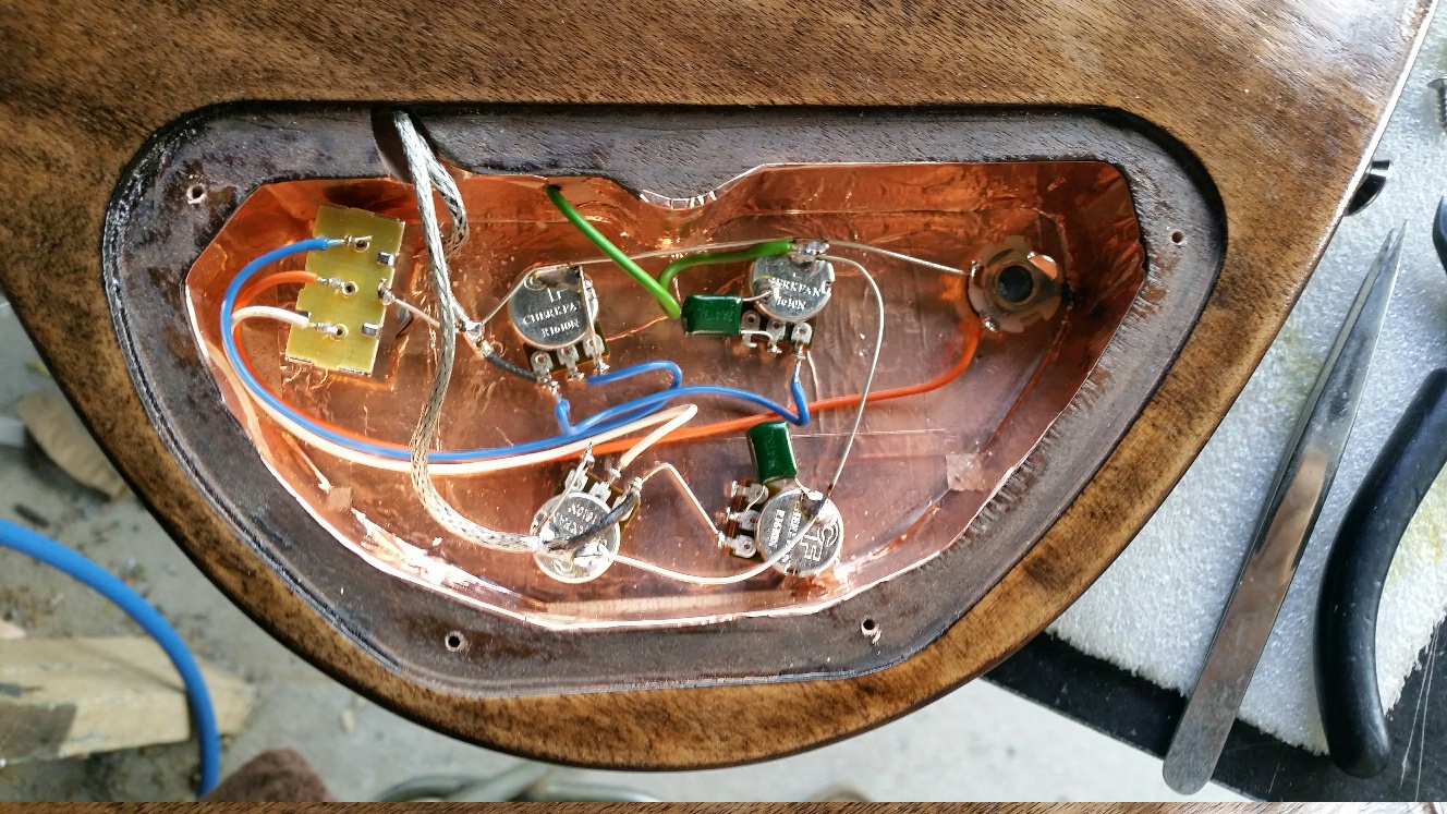

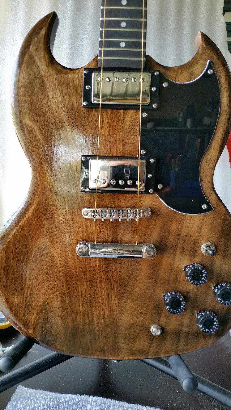

    Fitted all the hardware, shielded the control cavity. completed the electronics using kit parts for now, so most of the actual build part is done
    Just waiting for my headstock label thingamy, then I'll fit some strings...
