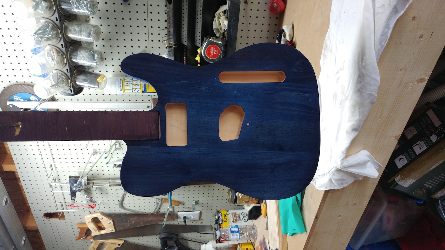

    So it took me a while to decide on the finish, but after ordering a variety of dye powders, I decided on this. Click image for larger version.
    I'm going to fine tune this, and add some shine. Then on to the neck (I think?)
  5. #45
