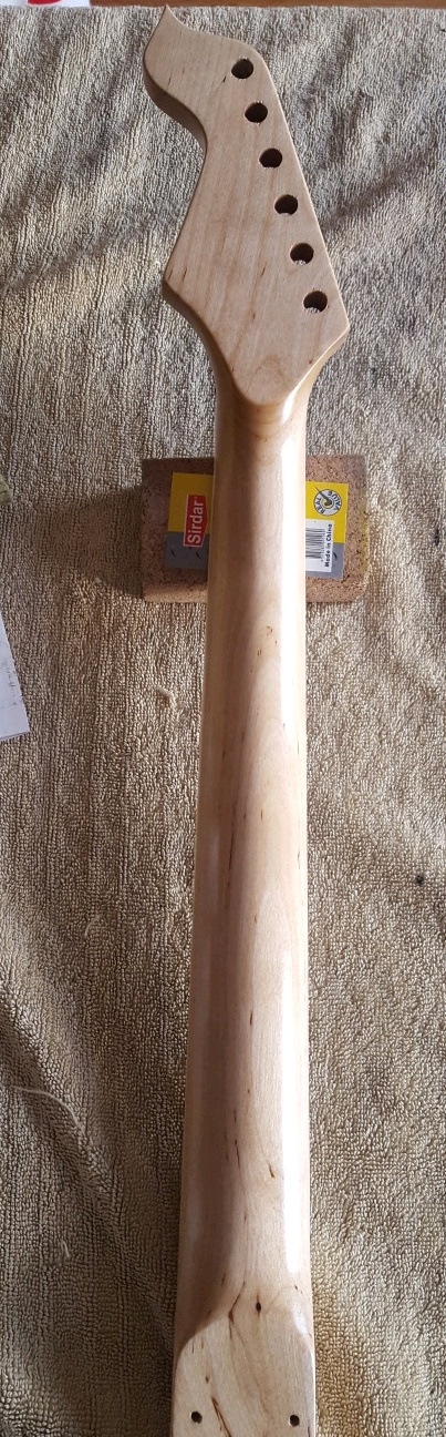

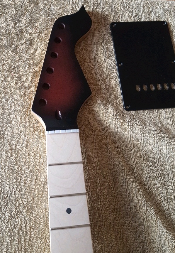

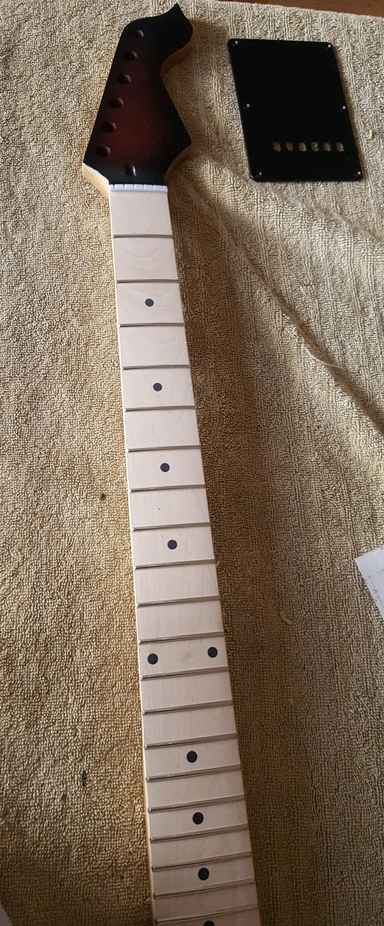

    the Neck.

  3. #43
    good job on the headstock burst ! should match well with the body

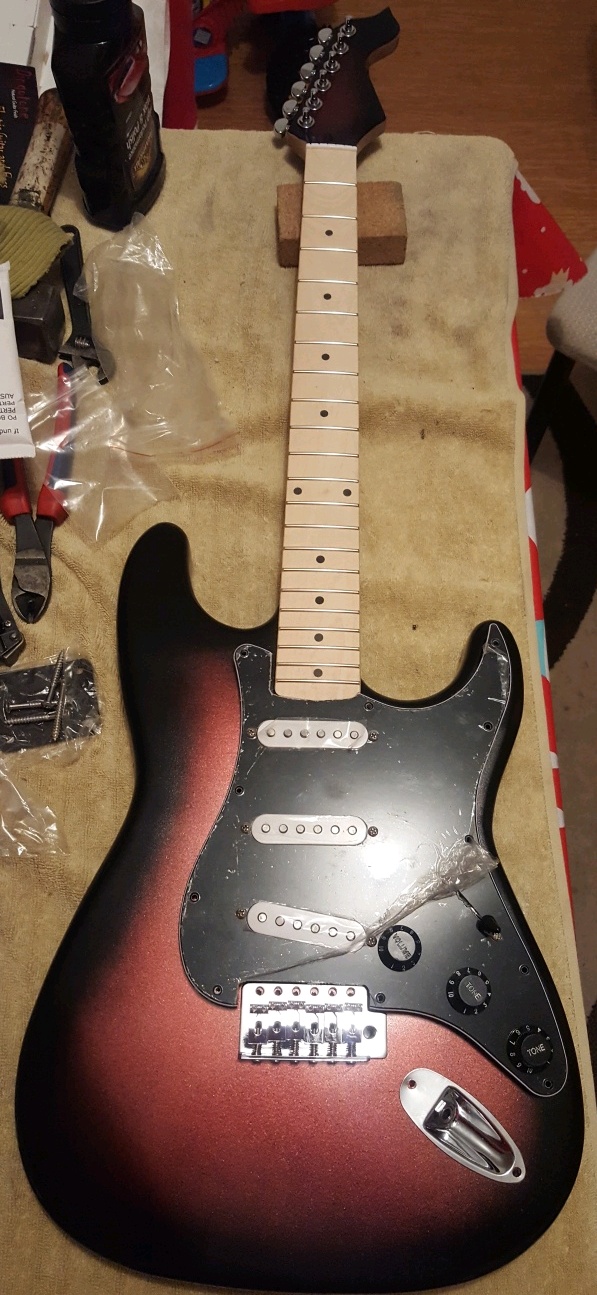

    just sat the bits together just to see how it looks. it actually looks good with the white pickups.

  5. Liked by: OliSam
  6. #45
    With a maple fret board maybe white accents is the way to go .
  7. #46
    Love the way that burst works with the pickguard. I think the whit and chrome tie the fret board to the darker body and head colours.
