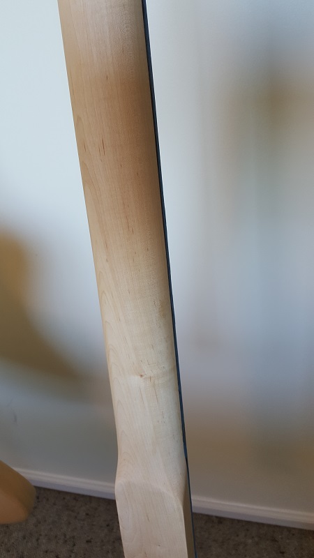

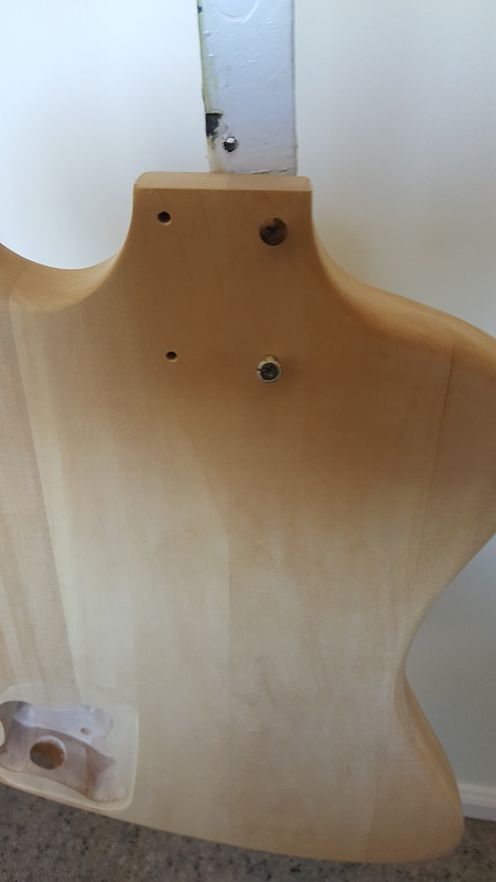

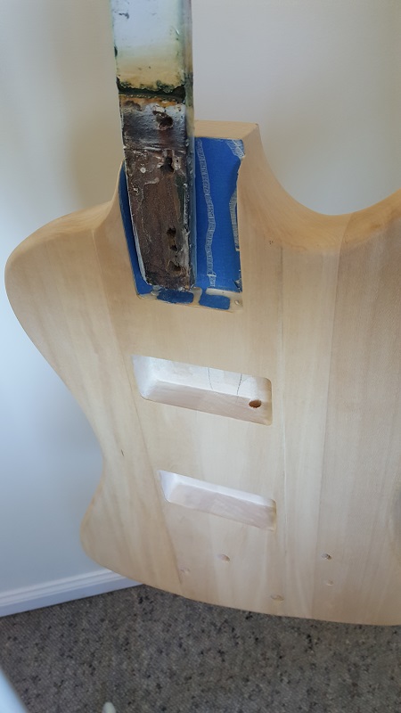

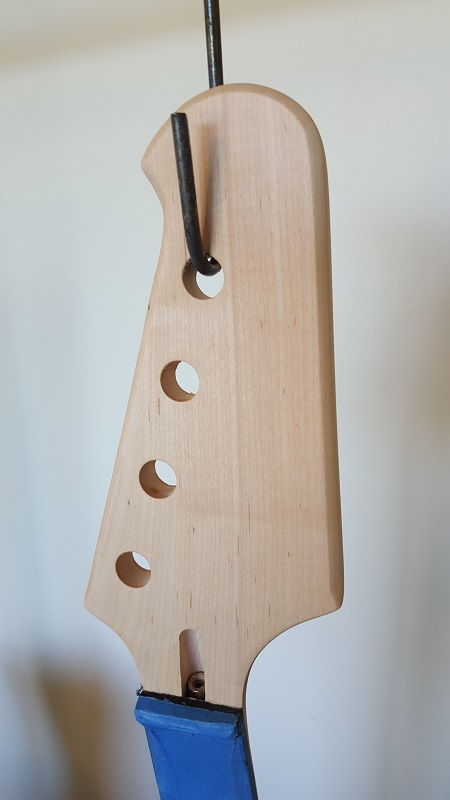

    Anyway....today I sanded at 240 grit all over the body to remove the timbermate....and cleaned up the neck as well.
    Then the fluffies got a fair workout. Two times over with the damp cloth and left to dry and then lightly sanded to 320 grit.
    I then made up some fresh sanding sealer...shellac...and gave the body and the neck two light coats with an hour to dry in between.
    That is it for today....depending on work....oh hang on....staining tomorrow.
    The piccies are about 3 mins after the last coat of shellac....so little colour differences.
    I am liking this kit. It has some wonderful end grain and the shape gives you more figure on the leading and trailling edges.
    Cover me in honey and toss me to the women in comfortable shoes. (Robin Williams reference.)

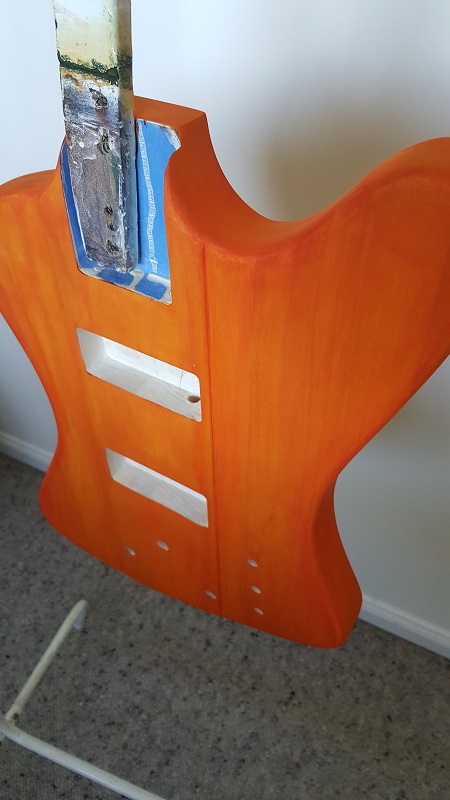

  10. #50
    Mentor ozzbike's Avatar
    Sunshine Coast, Queensland
    1,109
    Insert Graham KENNEDY crow impersonation....

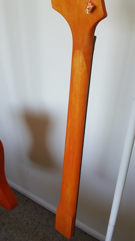

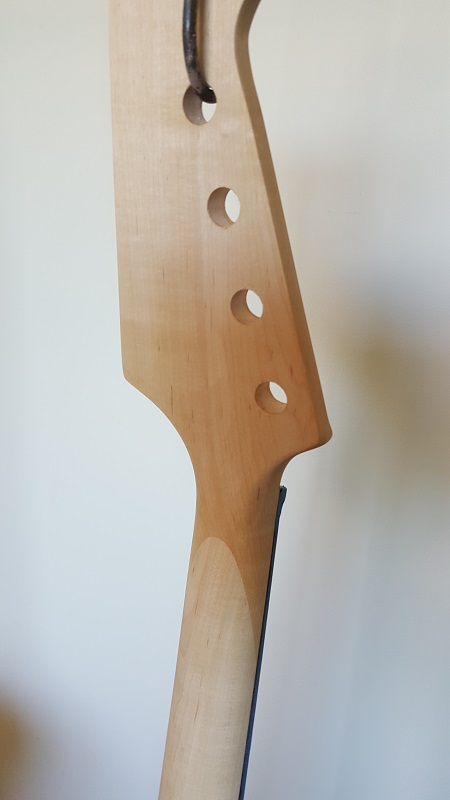

    Note to self....regardless of how I feel....or what I read on the net....stop sanding at 240 grit.....water based stain at 240 grit...no more.
    Brain fart moment and I went to 320 grit....super smooth and the stain just slid around.
    Even after two coats of sanding sealer it still made tide marks....gathered in globs....I worked it and worked it.....two coats with an hour in between.
    Nah.....time to sand. I shall practice the long taught art of SAN-DING. Taught with great aplomb by Sensei D.B. of the W.A. Dojo of luthiery.
    Phaark. !!!!!!!
