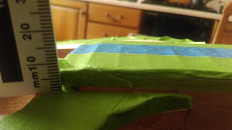

    It does sit right back in the pocket, there was a slight rise where the router hadn't done the job dead square but that is out now and still sits to me too high, leveling that bit in the pocket hasn't made any noticable difference. The 12th fret distances are only a couple of mm out, but noticed a slight bow in the neck which i know I can straighten with the nut. Putting a straight edge along the neck to the bridge I calculate the bottom of the bridge will be raised about 5mm, The Bottom of the fretboard is sticking up around 3 mm, excuse the crappy pic, I need a new phone....

    bridge heights are designed to be adjusted for just this reason.
    However the other options are to either take some out of the neck pocket, or the neck heal or both.
    Take care as you don't want to change the neck angle
  6. #45
    5,666
    I'm not sure that there is an issue there TBH Chris, I'll check with my LP kit when I get home but that sounds pretty standard to me in terms of height at the back of the board.
