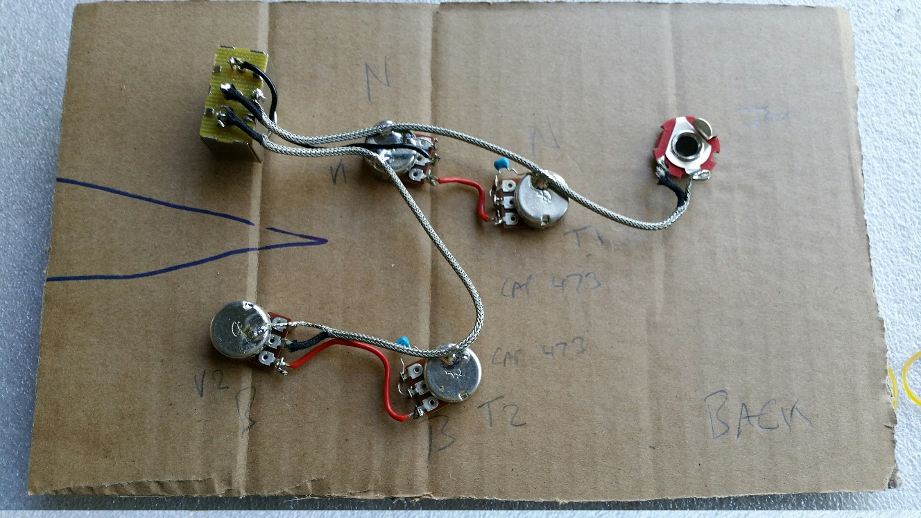

    Diverted back to my home ground of electronics today. I think the pictured wiring harness should work okay. Even though I got some CTS pots at the same time when I got the kit I'm going to stay with the kit supplied Alpha pots as I can get a better match of resistances per the Gibson Memphis factory spec. https://www.youtube.com/watch?v=at6-mhJ-OaU The tiny Blue dots are 0.047uF 250V caps.

    Nice loom Marcel, good to see the treble bleed in there
