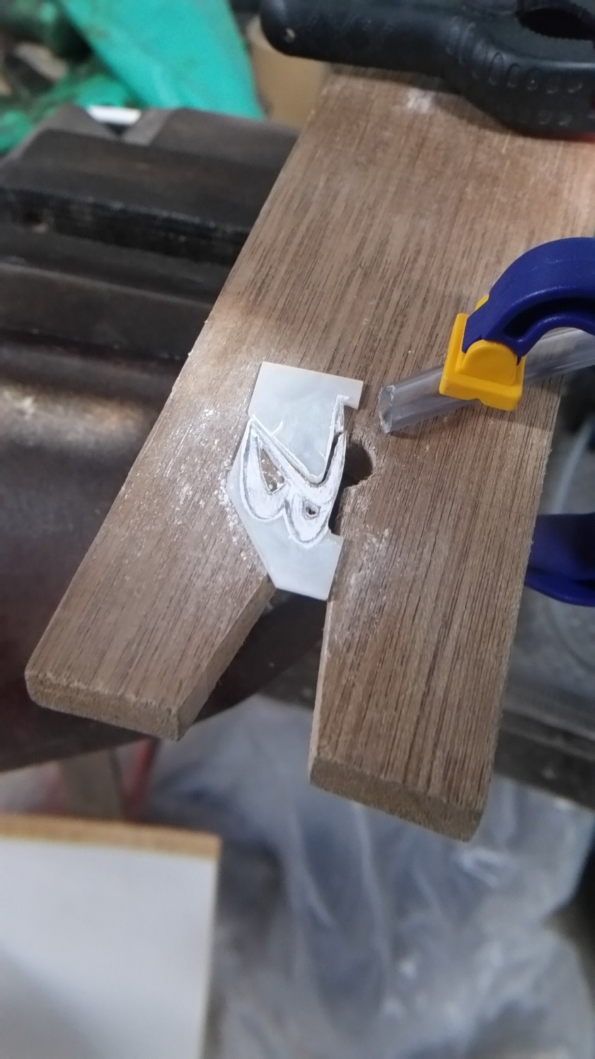

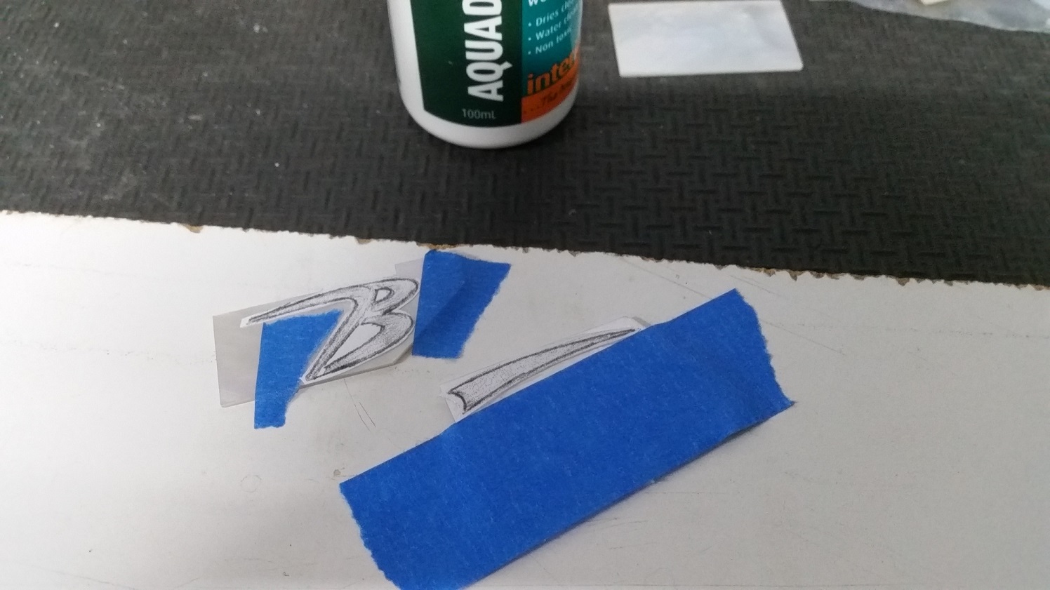

    Been trying to make some progress with this one, more adventures in inlay making.
    Scanned and printed the sketch, cut out and glued to the pieces of white MoP shell.

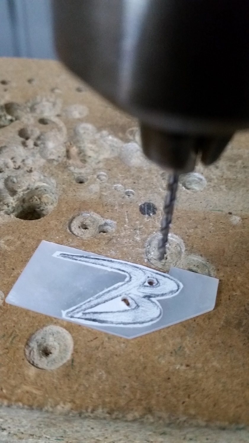

    Used a 2mm drill bit so could get the jewellers saw blade in to cut the inner shapes.
    You may notice I managed to break off the pointy bit of the back of the B, oops, call it a design change.

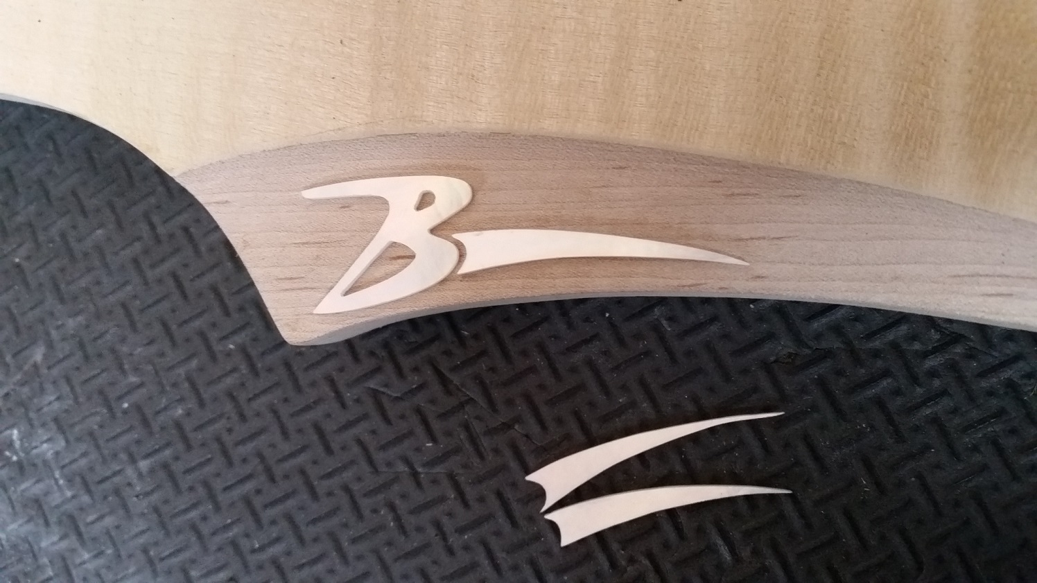

    Took three goes at cutting the separate flourish thing, not entirely happy but not willing to waste any more shell on it, should look OK from across the room.

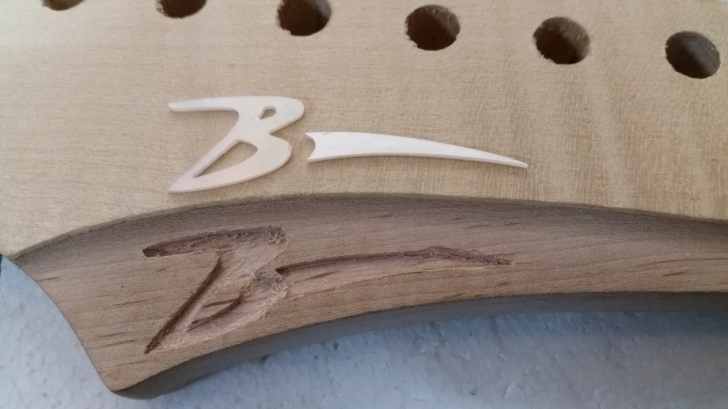

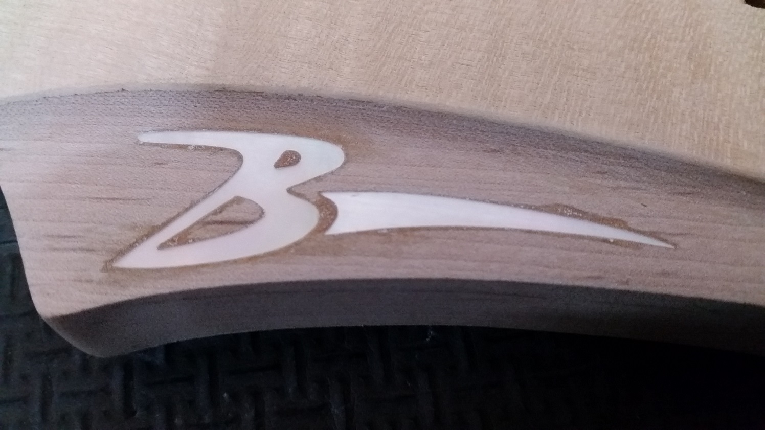

    So, had a go at cutting the recesses for the inlay pieces and all did not go well, thinking the B should stand for butcherous. Did the B first, broke off the small part that would go inside the upper loop of the letter, then did the flourish recess and as I was getting close to the right depth the piece of maple between the two cut outs broke off. Red mist descended, many many bad words said.
    The raggedy mess, since cleaned up, should title this 'what an inlay cavity should not look like'.
    Shell pieces in place

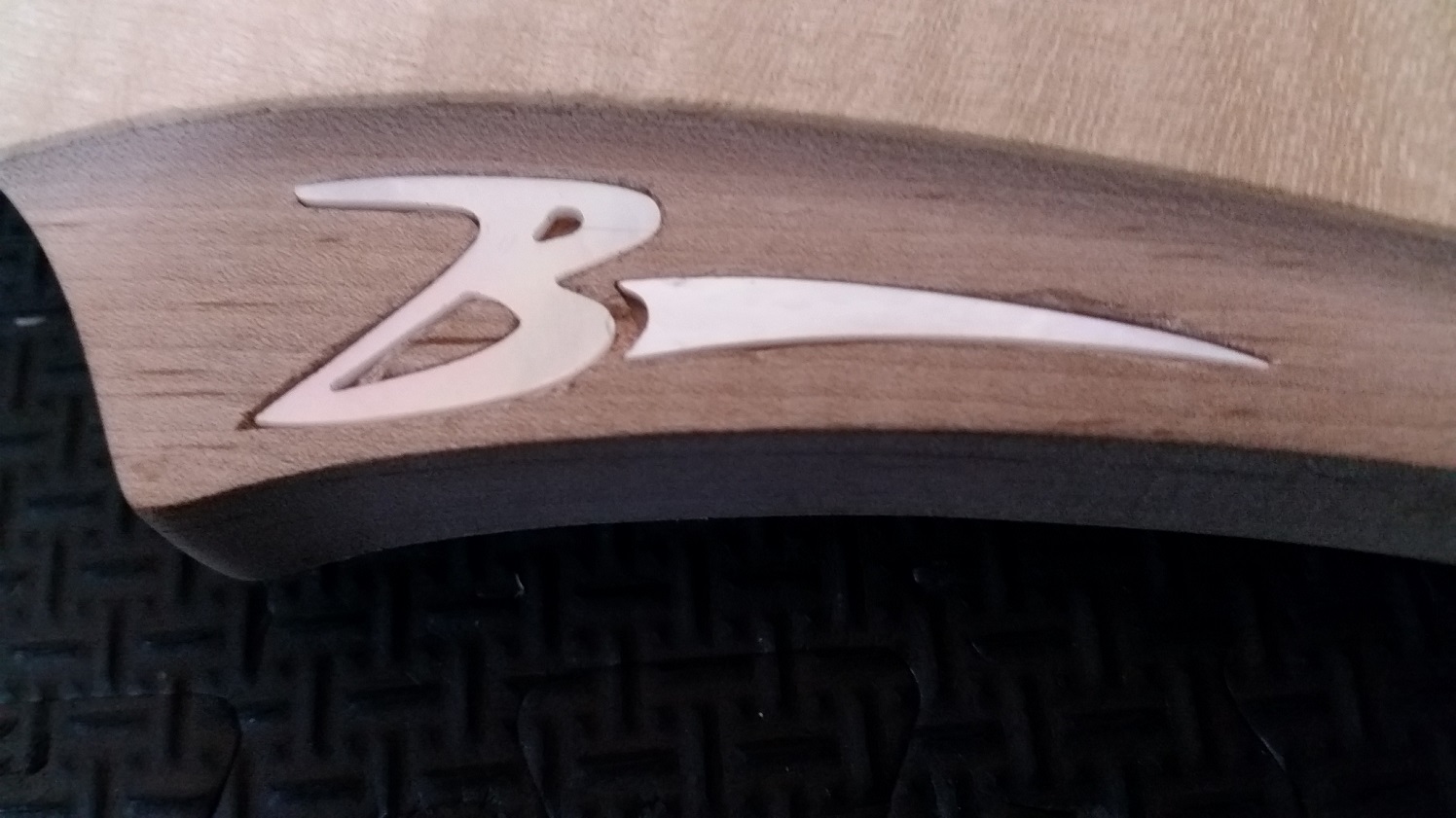

    Used white glue to hold the inlays in place and then mixed maple sawdust with titebond to fill around the pieces (pays to keep any offcuts from headstock or body shaping, may come in handy for jobs like this). Because I'd done such a poor job, took two goes to fill the gaps.
    Sanded smooth, the white flecks are shell dust which should clean out. Now to sand the rest of the neck, round over some edges where needed and get ready for stain. If the glue fill doesn't take stain too well can paint that section, it was always intended to be black.

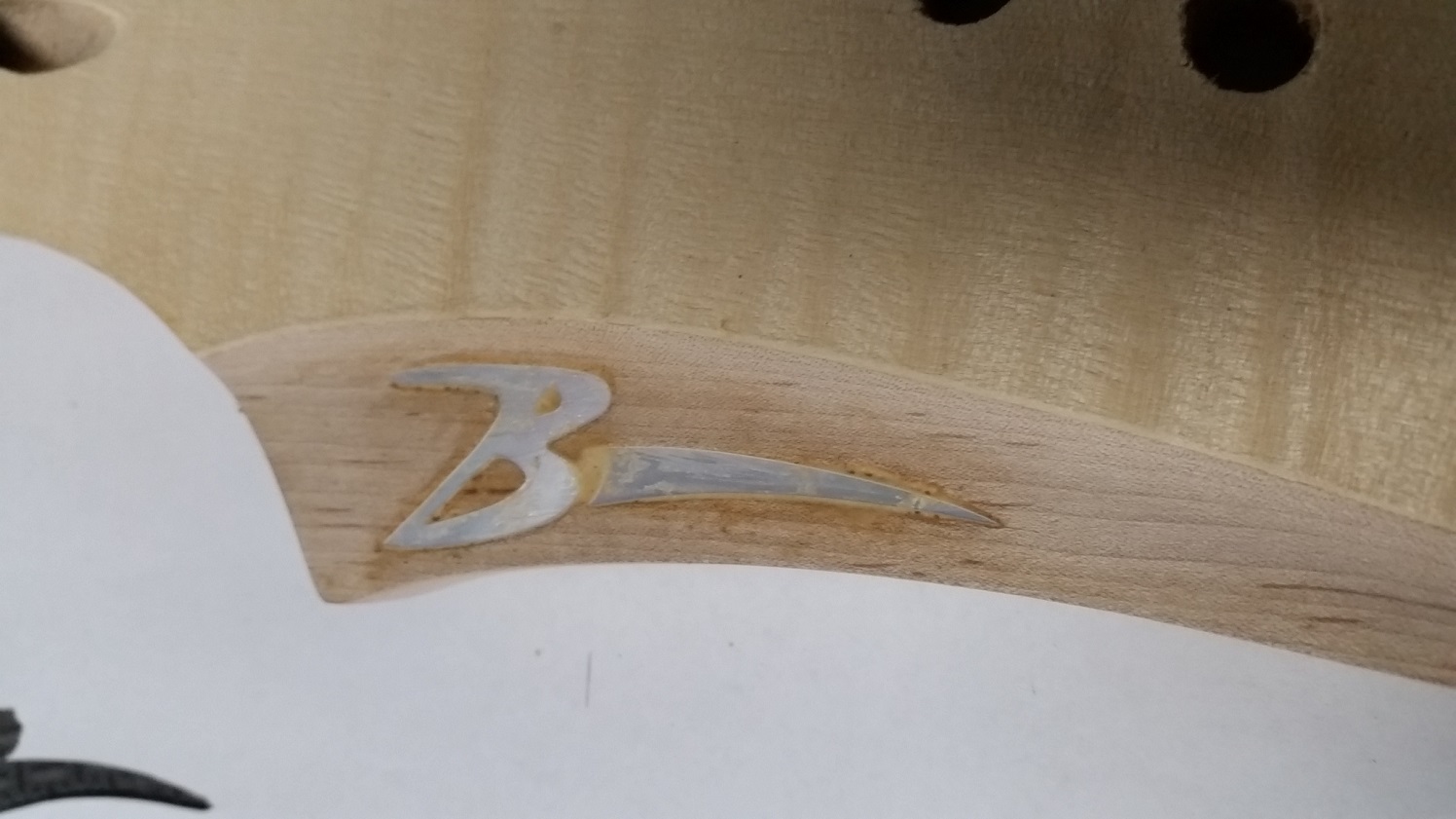

    Grant

    Congratulations on attempting the inlay. The glued wood bits won't take the stain - not without it being very noticeable at the very least - so I'd progress straight to the paint for that area.

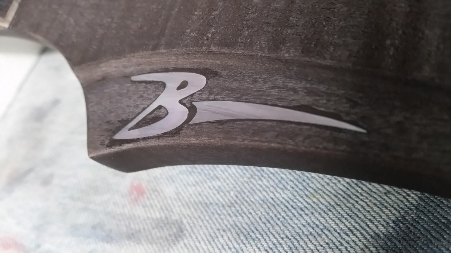

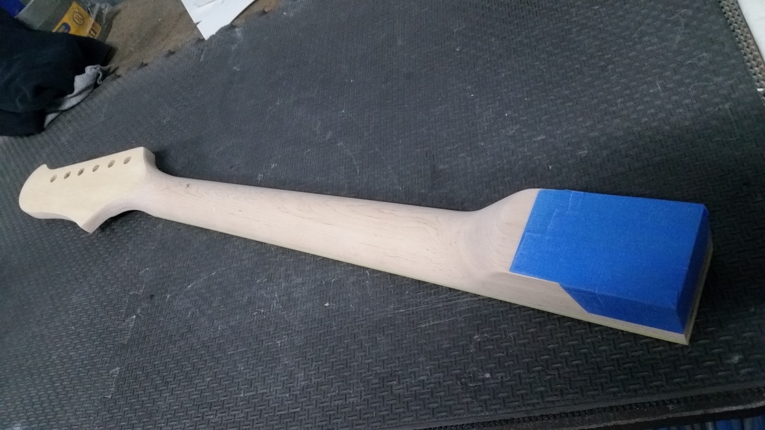

    Got the neck sanded to 240 grit all over and taped up ready for staining.

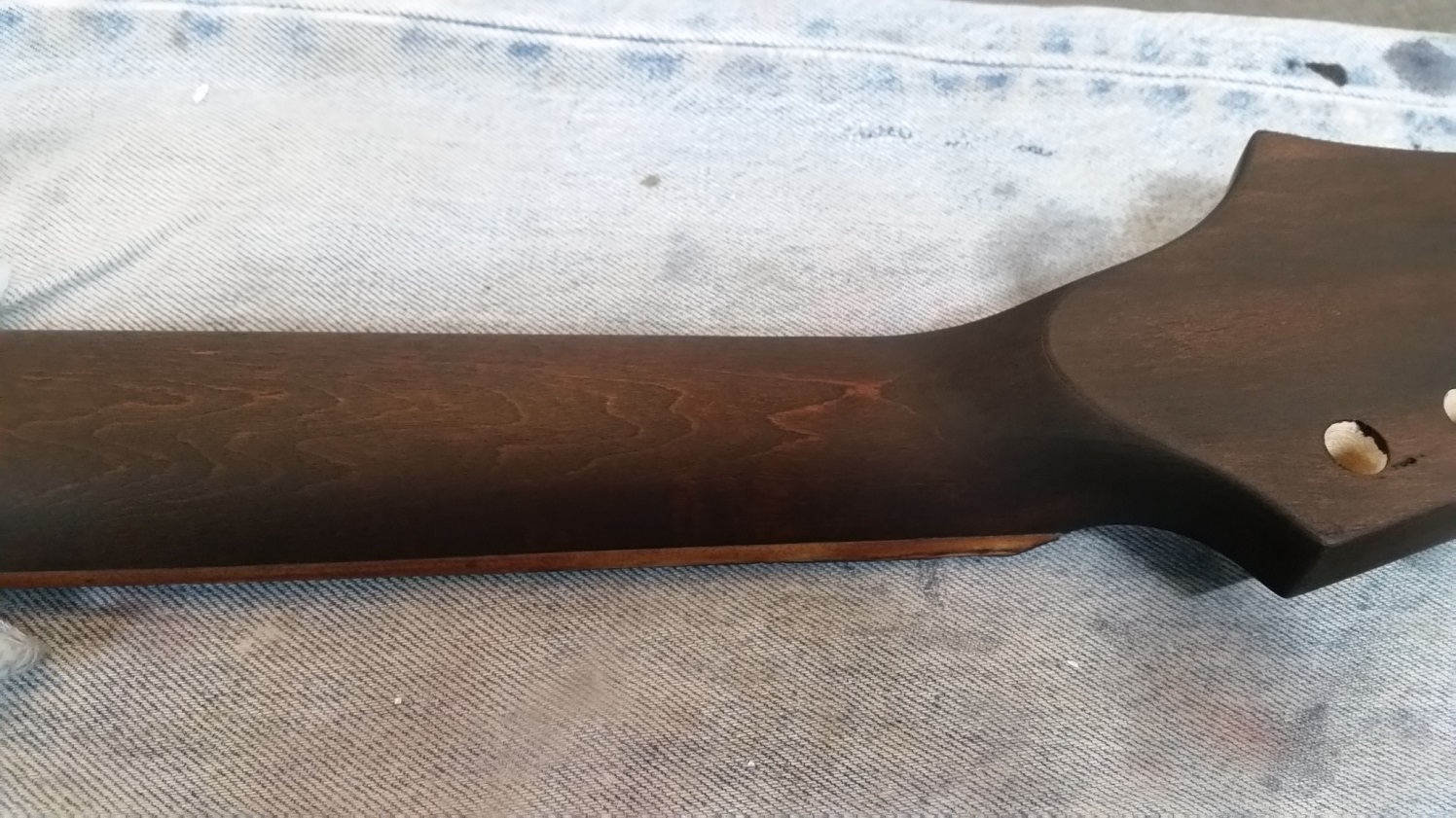

    Following the same process as the body, black stain first then multiple coats of orange mix which pulls some of the black off onto the cotton swabs as you go. Can't really tell if it's the same as the body, but while it's damp it looks about right.
    The glue fill around the inlay did take the black stain but as Simon predicted it is quite noticeable at certain angles, so will have to paint that section after all.

    How the grain on the back of the neck looks, had pics of the edge of headstock but they're a bit blurry, looks similar to the edge of the body. Now just need a warm day to get some clear on to seal it.
