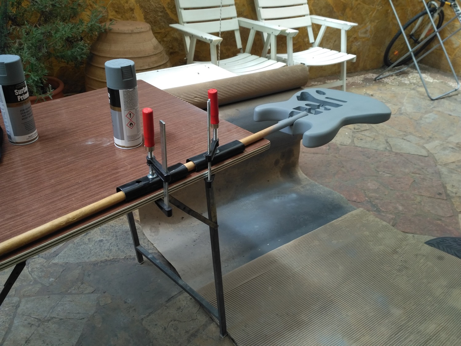

    At last a good shiny day in Greece!
    So i came up with a working bench for the guitar painting.

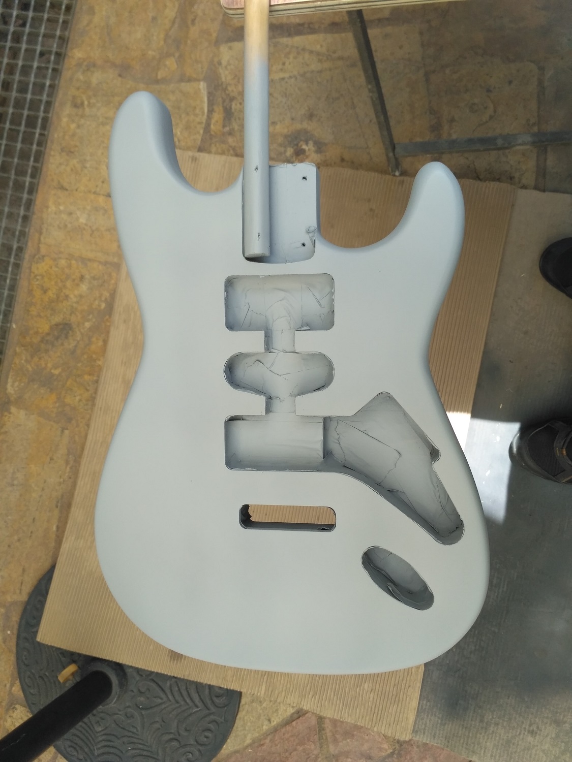

    And i did the primer. 5 coats pf it just to be in the safe side.
    I'll let it dry over night and tomorrow i'll do the sanding!
  4. #44
    George, it looks like you've masked off the neck and control cavities. However it's important that the paint extends into those areas by a few mm, rather than stops right at the edge. If you don;t continue the paint over the edge by a short distance, the paint won't stick to the sharp edge properly and you'll get it peeling or chipping off. I'd move the masking tape down a little bit and make sure you get some primer and then the colour and clear coat so that it goes over the edge.

    Will do Simon. I've left only a little gap. I'll make it bigger. Thanks!
