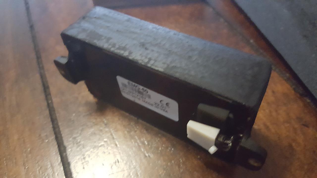

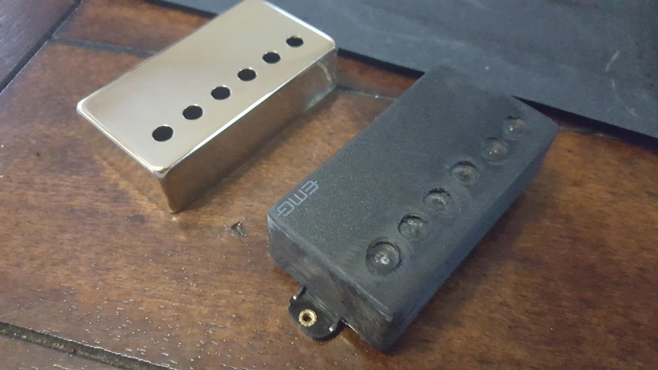

    Over the last week when I've had some free time I've been working away on butchering my nice new EMG 60/81 pickups. I've made some creative use of my Dremel attachments to grind away the plastic covers and bore out some holes for the faux pole pieces. I think I finally have them to the state where the gold covers will fit. Now I'll just need to cut the heads off the pole pieces and epoxy everything together. Well and I'll also need to age the covers for that nice pretend vintage look.
ID:	20012 Click image for larger version.

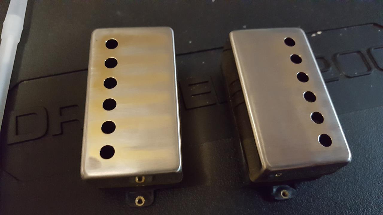

    So I had a bit of time this evening and decided to try out the scouring attachment I got for my Dremel on my pickup covers. I used the photos I posted at the beginning of this thread as a guide for the amount of wear to shoot for. Here are the results (bridge on the left, neck on the right).
    Next steps for the pickups will be to cut the heads off of pole piece screws and epoxy everything together.
