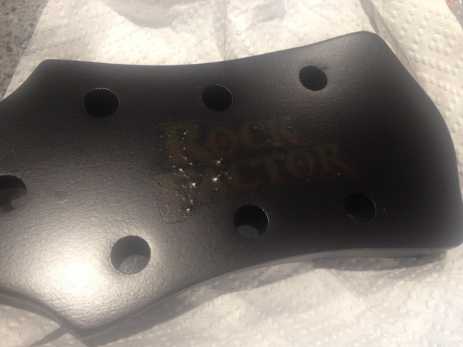

    Check this out. Best decal ever (if you can even see it, is is there)
    Disappointing as I emailed the decal seller and asked for their recommendation on decal stock for a guitar headstock.
    I'm presuming they assumed it was a timber coloured headstock, not black.
    Robbo.
  10. #50
    Hi Robbo, if you want to do it again I suggest you sand that off and then use MS Excel to drop your logo into an enlarged 'black' cell so that when you print the sheet it will have the black background and be big enough to cover the whole headstock. Once dry just trim the decal off at edge of the headstock. If you use satin clear to seal the transfer and then a couple more coats on top it should remain satin and not turn out glossy.
    Cheers, Waz
    Edit: I reckon this method will also bring out more of your logo colours too. Laser printers work better but inkjet is passable.
