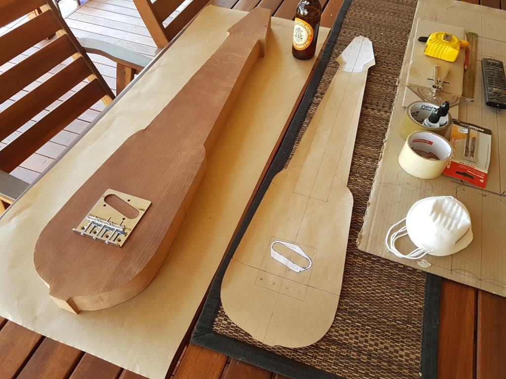

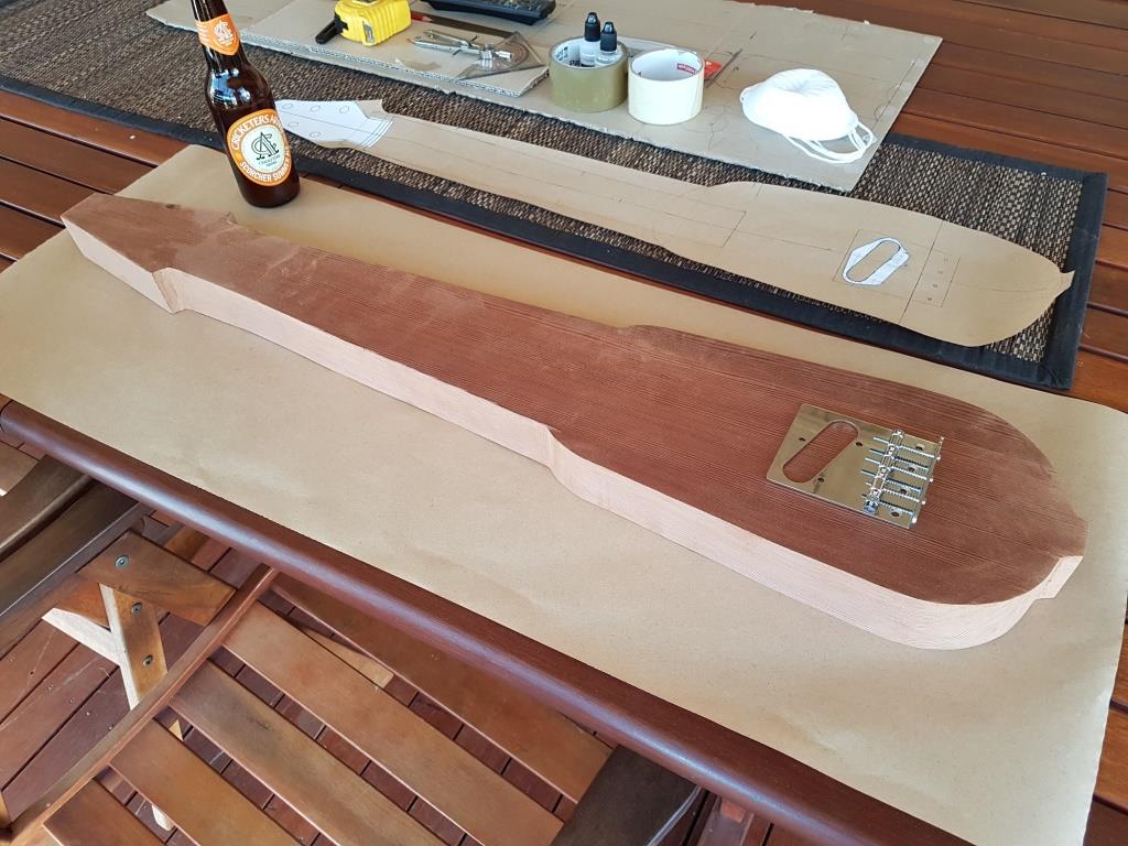

    Taking shape today, needs lots of filing and sanding to correct my amateur work with the jigsaw
ID:	18500 Click image for larger version.
  9. #49
    Can I just mention that the shape is rather reminiscent of something. Was this intentional?
  10. #50
    Looks great Guvna. Should clean up nicely
