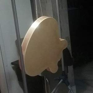

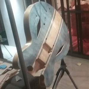

    Ok decided i was getting to fancy with the pin stripe and couldnt get anything the right colour so thanks gav. Onto the first finish coat Click image for larger version.

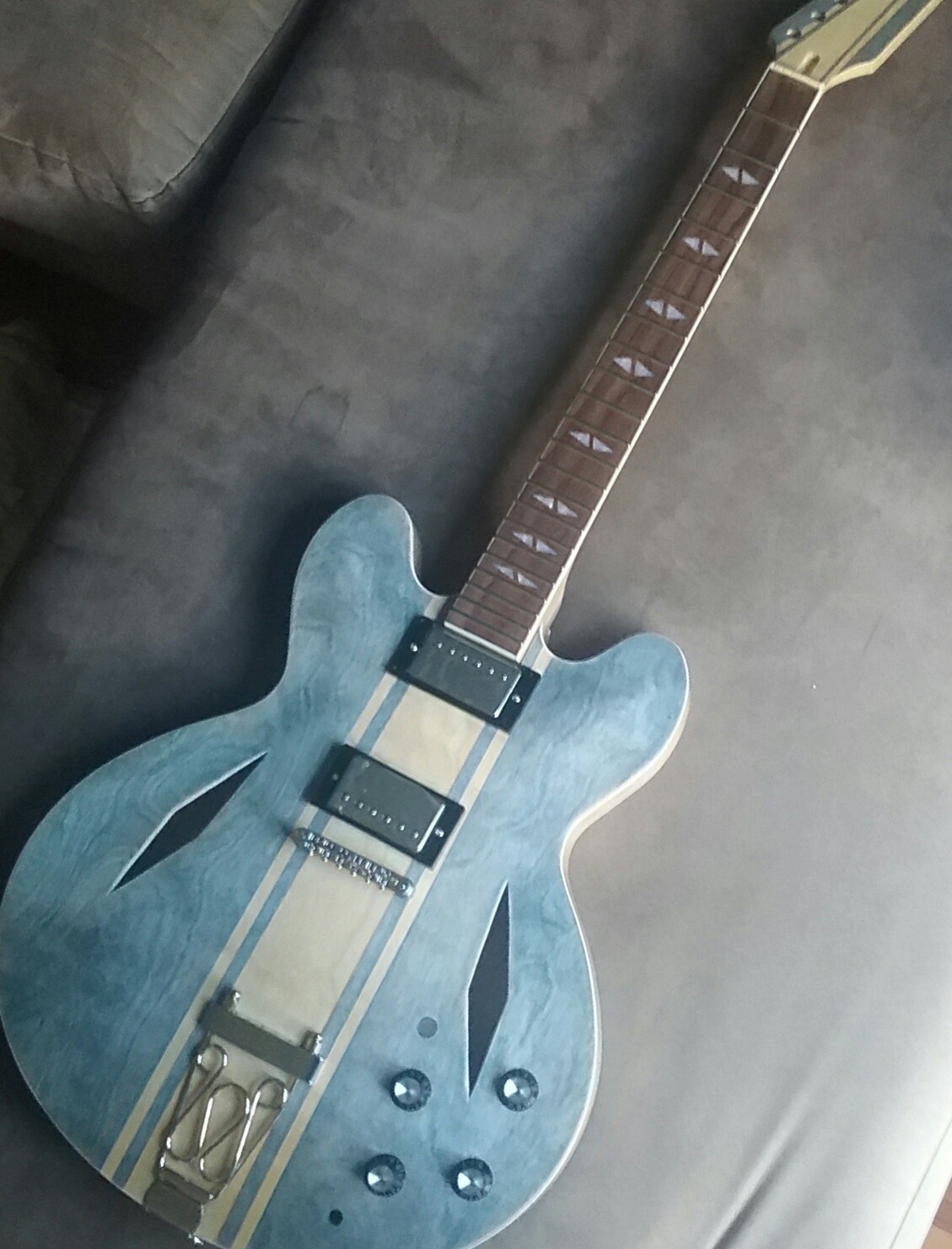

    I'd like thank all the guys on here for your help especially the last few days with the finish coat blisters, there's rain focased every day for the next week so all i can do is a mock build and look at it. So beer making this weekend instead of guitar making.Click image for larger version.

    It looks great standing back but up close the top coat is going to take some work.

    the mock looks great Adam. What style of beer are you brewing on the weekend ?
