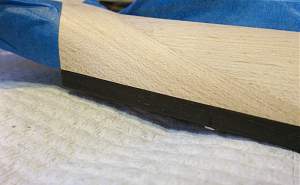

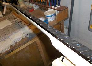

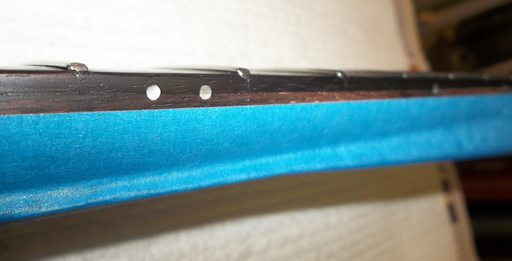

    The blackened fretboard has drying for a couple of days, so I gave it a rub down with paper towel to remove any excess black and peeled back the tape for an inspection. The fretboard masking actually came out sharper and cleaner than I expected, despite the uneven nature of the rosewood's grain.

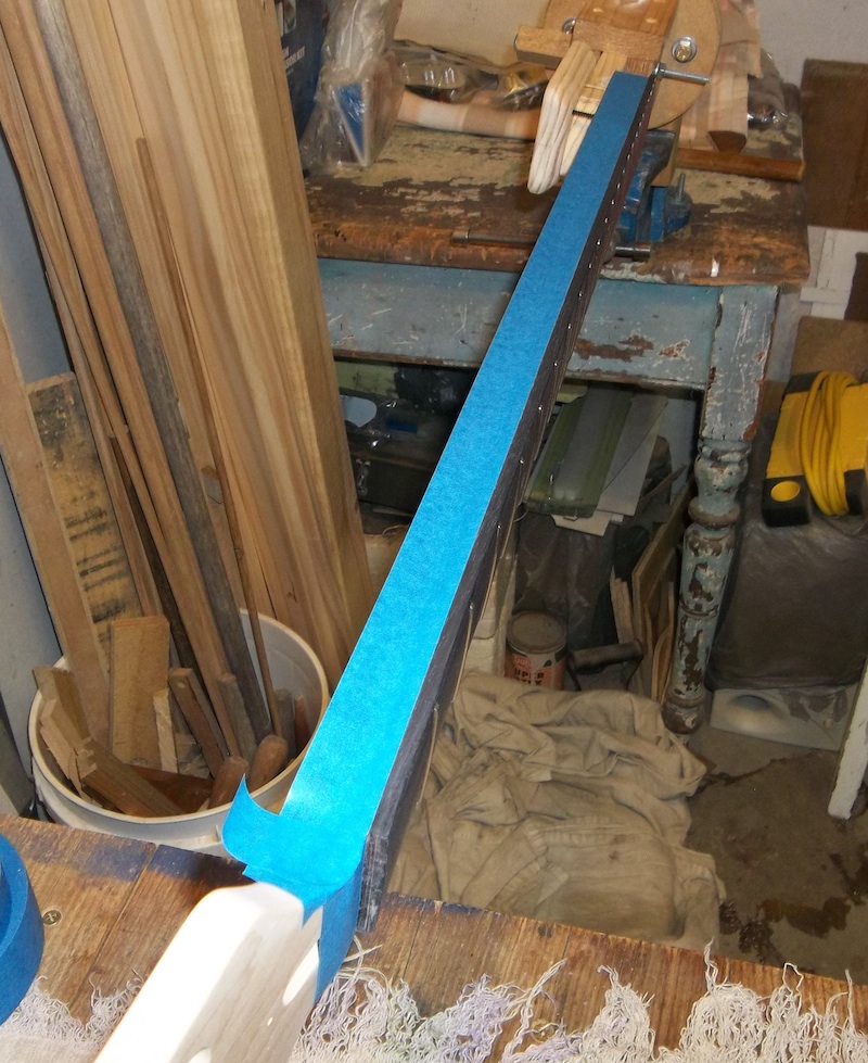

    So, I decided to bite the bullet and go all in masking right up to the edge of the maple for the second coat. This tape is really good for masking (Oldfield's), but I still spent a lot of time rubbing it along the edge to get the best seal possible. Here's hoping.

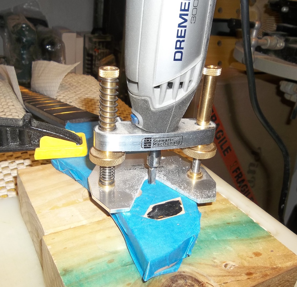

    Again, flush cutting with my Dremel. The leaving the tape on provides a little extra leeway.
    Dremel'ing done and tape off.

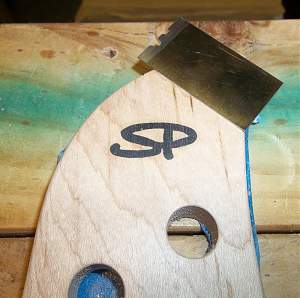

  6. #46

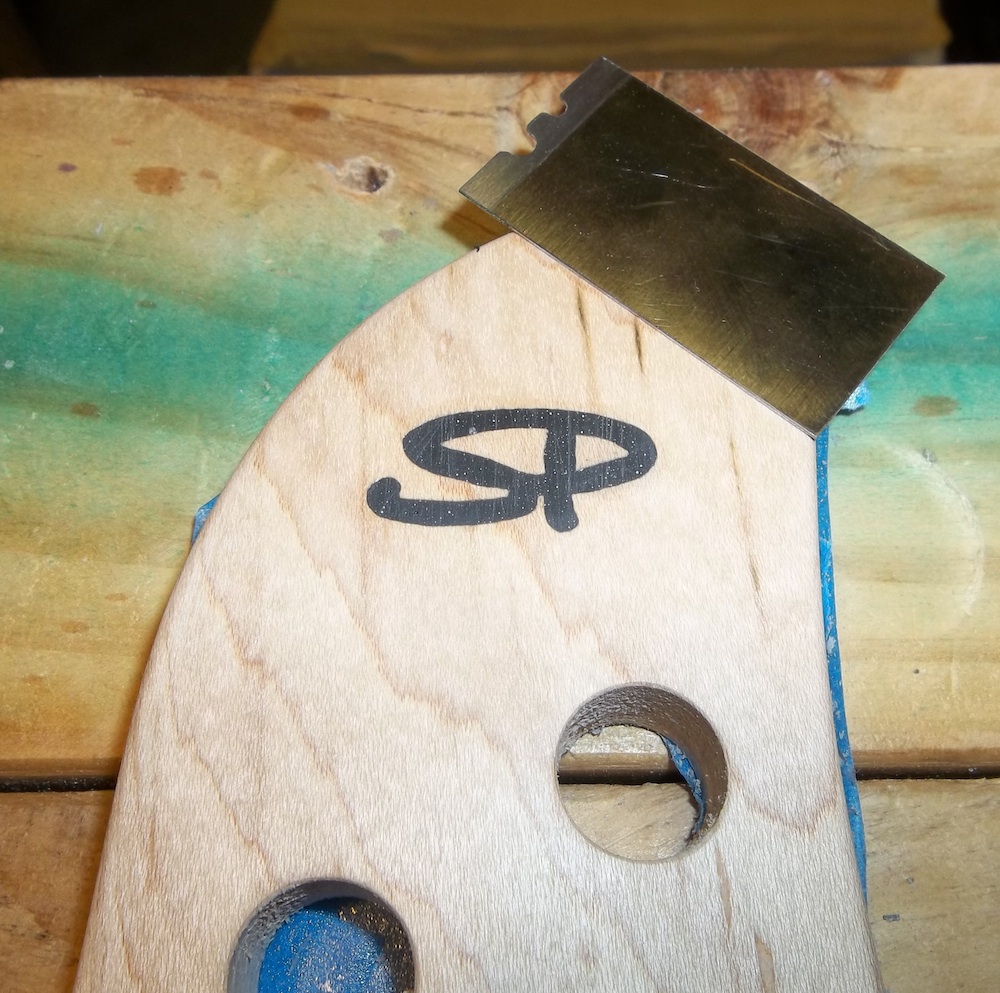

    Scraped and ready for final sanding. Looks like there's a hint of an air bubble at the upper inside of the S, but I can live with that.

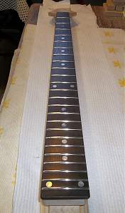

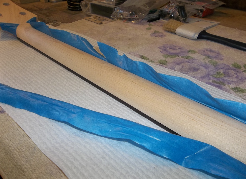

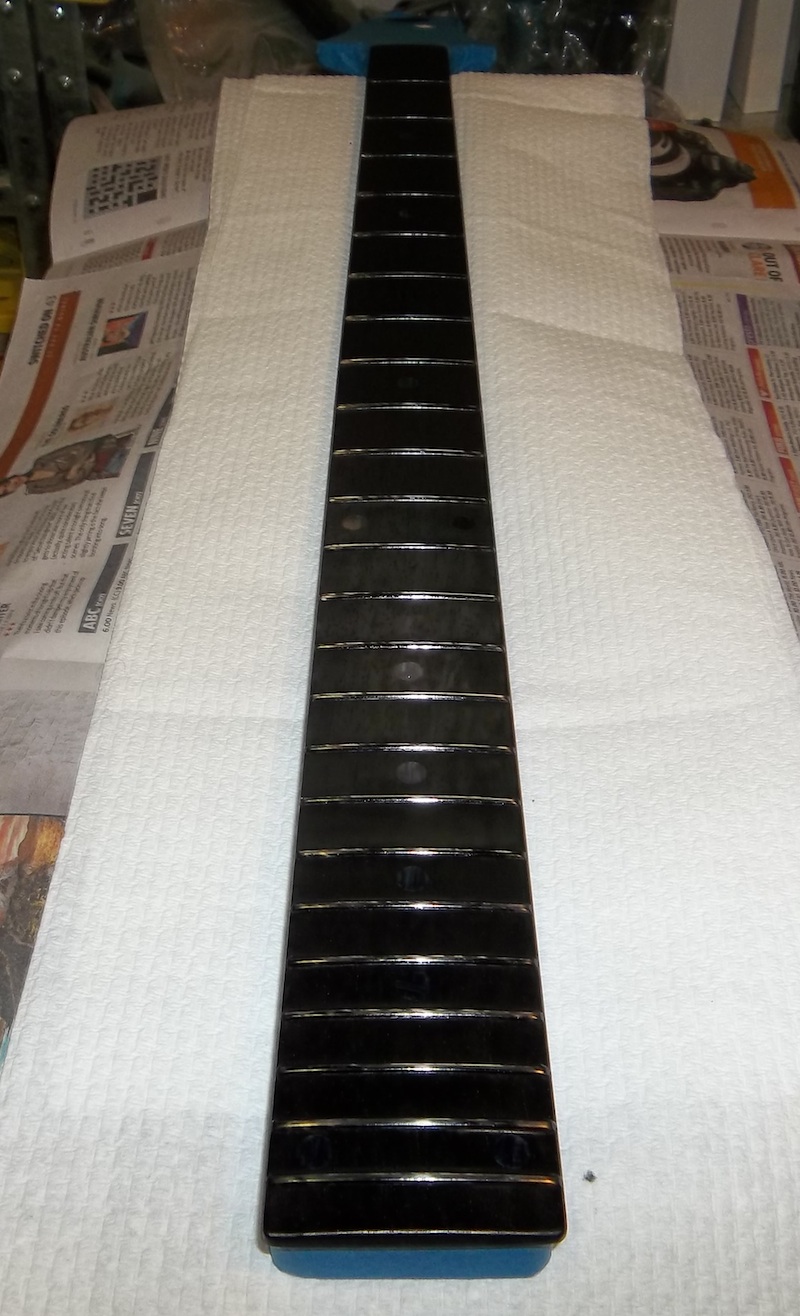

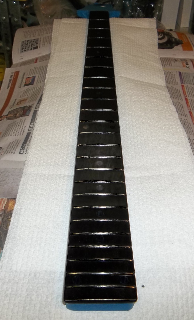

    Two days drying and time to see what happened with the fretboard black. I gave it a dry rub with some paper towel to get rid of loose surface black. Then, repeated with some Metho and paper which pulled the excess black out of the grain holes (a lot of black as I was pretty generous with the last dye coat). Once that was dry I gave it another dry paper towel rub just to clean up and very nervously peeled the tape back…
    … to see a beautiful crisp, clean, sharp, unsullied maple edge...

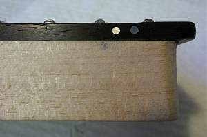

    … almost! It turns out there was a tiny nick/slice at the edge of the fretboard that I didn't see and the sanding didn't remove, and that was enough to provide a channel for a little dye to seep under the tape
    I wasn't too bad, but disappointing and tough to remove. I could have just kept sanding to get rid of it but that would've left a dip on the side of the neck. Instead I used several applications of acetone, a bit of scraping and a touch of sanding until I got it to the point I could live with.

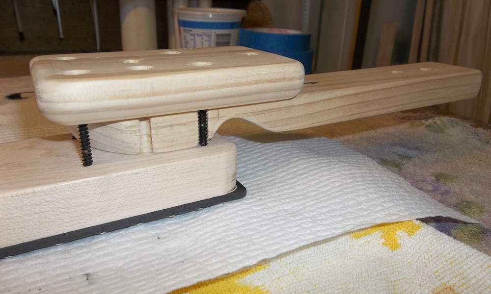

  7. #47

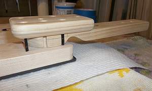

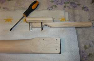

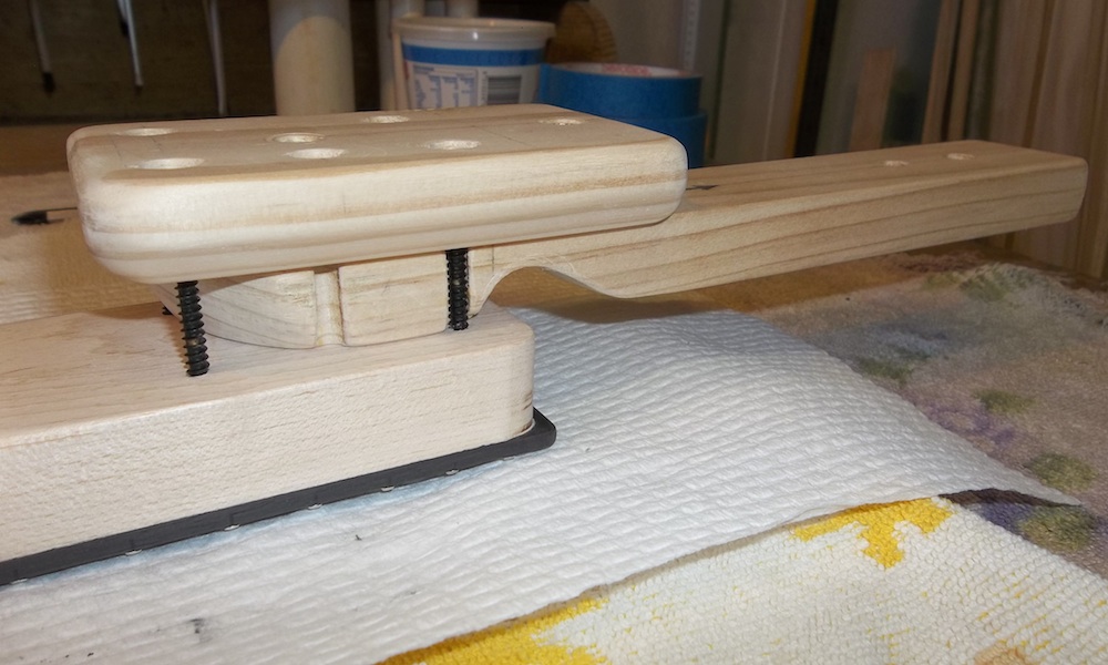

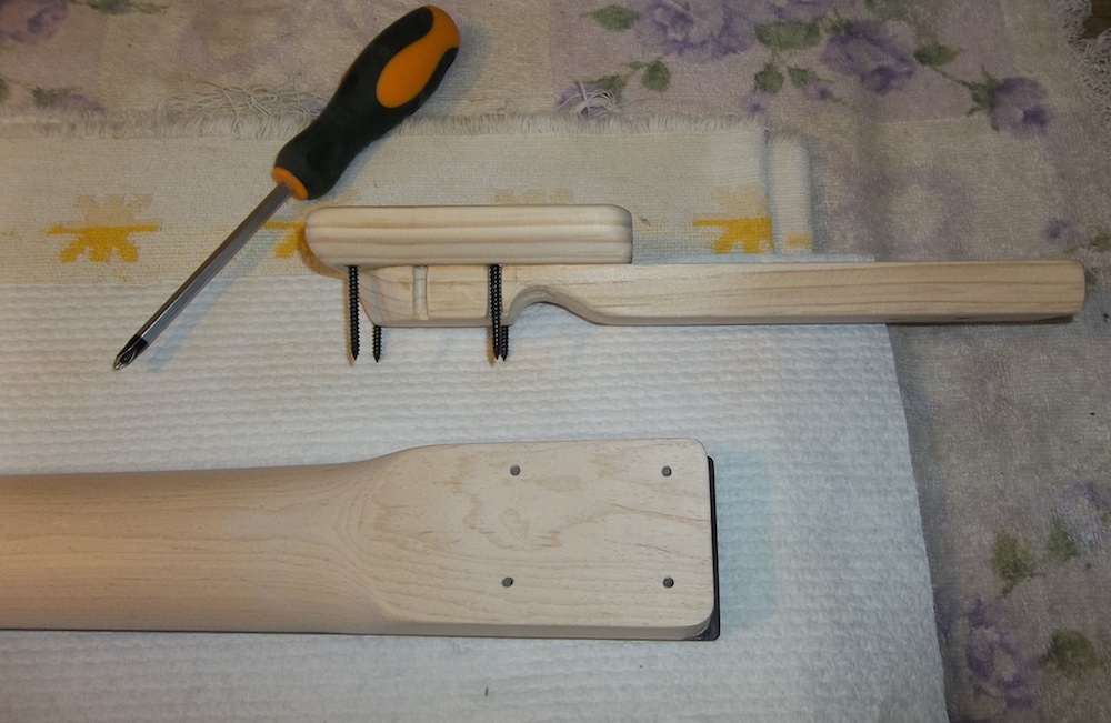

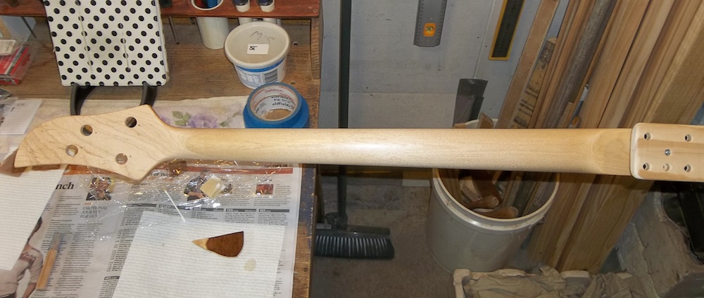

    The neck got a final sanding up to 800 grit and was ready for some finish. Again, I have an attachment for my painting rig. In this case it's designed to work with standard or curved neck plate screw layouts while providing access around the end of the neck, held in place with the neck's own screws.
    Ready for finish.
    I'll be using Tru-Oil on the neck (and body), but I don't want to risk any of the black from the fretboard edge being transferred onto the clean maple neck. So, I decided to mask up and do a couple of TO coats on the fretboard edge to seal it before doing the rest of the neck.

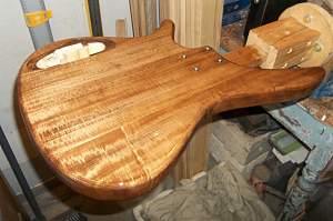

    7 days drying for the final coat of Dark Tease, and it was time for the first coat of Tru-Oil on the body. I wasn't sure how it would go over the old Wudtone.

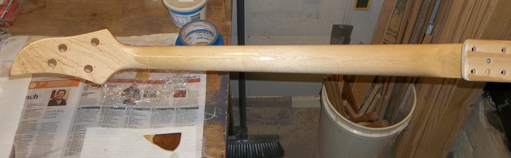

  9. #49
    First full coats of Tru-Oil on the neck, no stain as I wanted a light natural look to contrast with the body and dark fretboard.
    After 4 coats.

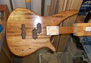

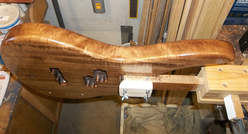

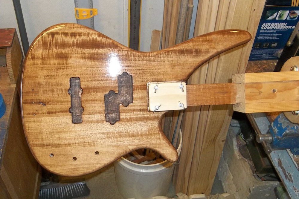

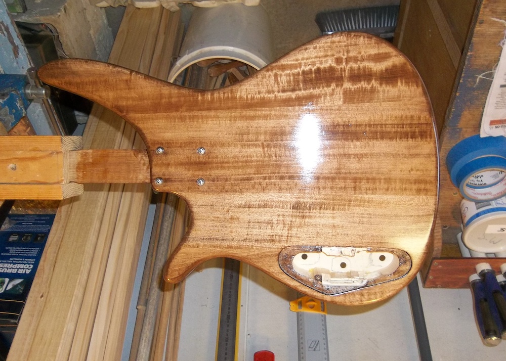

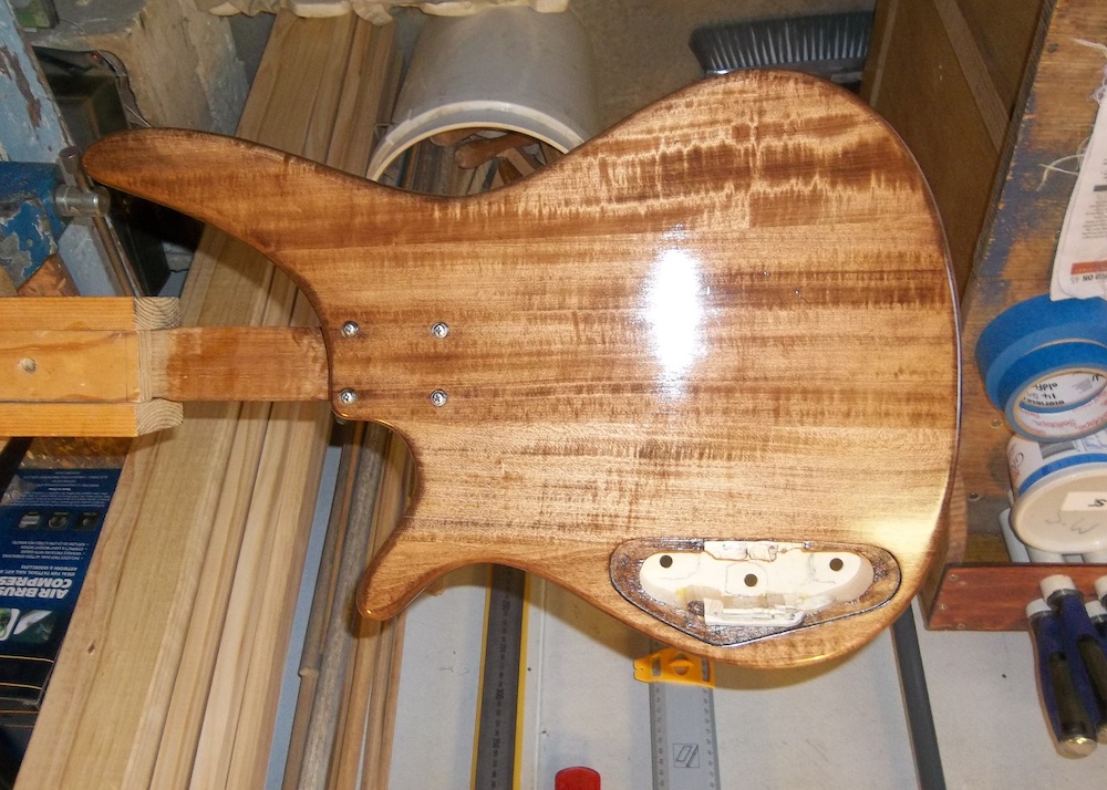

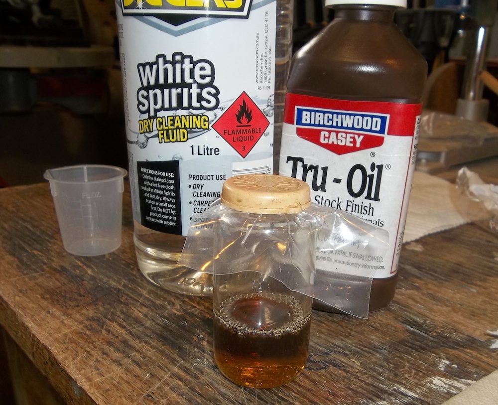

    With the body I did 4 coats of Tru-Oil the first day, 3-4hrs apart. Next day, I started with a thorough wet sanding with White Spirits and a piece of 1500 grit wet and dry paper. I then did 3 coats for the day, each about 3 hours apart and using that same piece of 1500 grit with white spirits to knock down any rough spots prior to the next coat.
    After applying the 8th coat.
    cont.

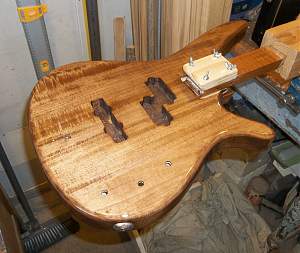

  10. #50
    Once again, my favourite bit is looking even better.

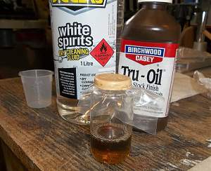

    I repeated that same process for the rest of the coats. White Spirits wet sand at start of the day with fresh piece of 1500, then used the same piece for touch-up wet sanding prior to each coat for rest of the day. In total, I did 20 coats of Tru-Oil on the body, with the last 6 being a 50/50 mix of White Spirits and TO.
    I used the same basic process with the neck (and the same piece of 1500 grit paper as used on the body for the day) but only a total of 10 coats of Tru-Oil, with the last 4 being a 50/50 mix. I then did 2 extra coats on the just headstock face to finish it off.
