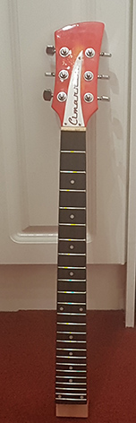

    This is turning into a nightmare. The hole I made in the top won't take a decent stain on the filler. The new bridge has a chrome plate 86 x 20 mm which will cover most of the damage. (I could have done with it being 30mm). I'm not going to just leave a scar showing so I've ordered a bit of pine veneer and am going to replace the whole section. I'm lucky in a way that the patch runs fron the cutaway at the tail to the bridge pickup so should get away with it. I've got the back shining like an antique cello. 3 hours polishing with 0000 steel wire and 3000 grit wet/dry. Then buffed up with a lovely beeswax. Neck and head are finished. That's the only photo I can show for a weeks work. Will report back on the veneer.

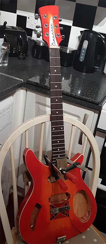

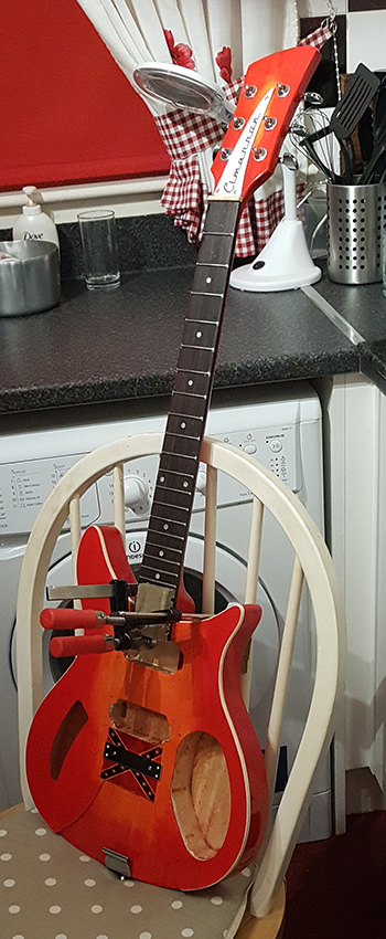

    Had a bad week with the beast. Getting over it now. I put an old glory flag over the hole. It'll do until I get a new scratch plate. I'm going to make it full face like the strat. It looks good in photoshop! Will get it strung and finish the wiring tomorrow and see how it plays.
ID:	17504 Click image for larger version.
