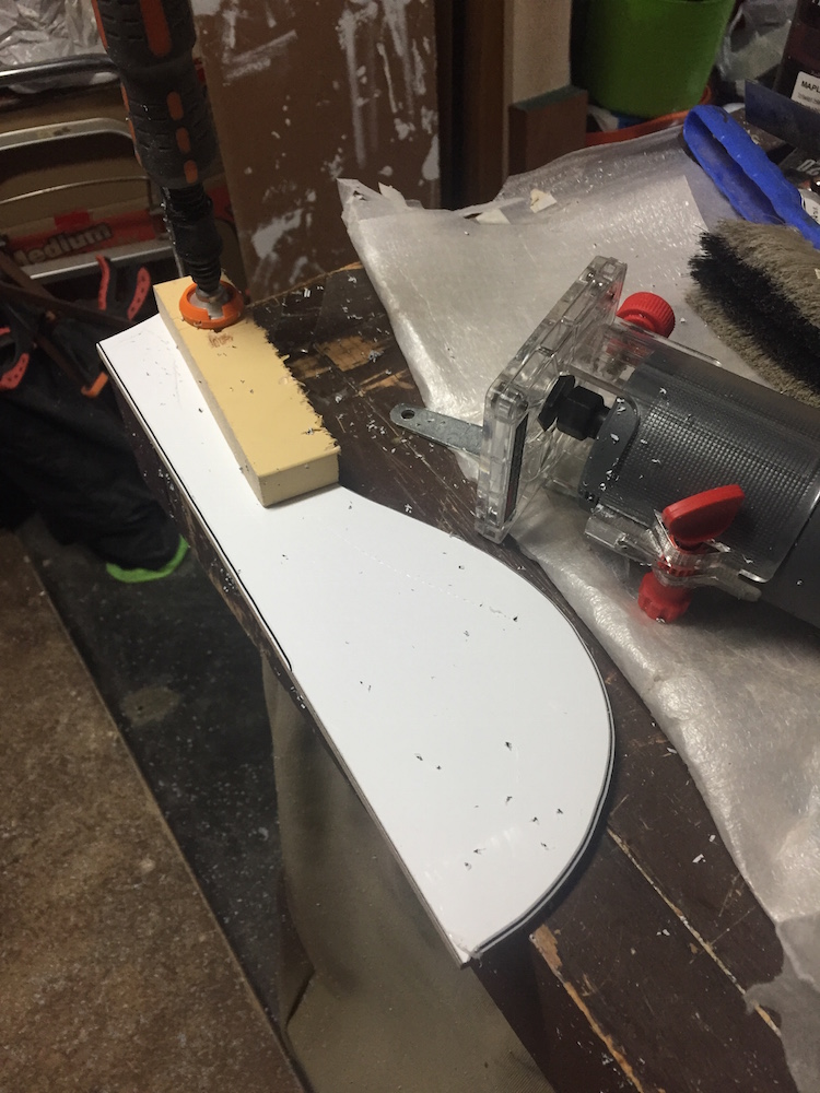

    Rather than always ask, I figured I'd just try it out. So I clamped an old piece of pickguard to the workbench and used my existing big router (can you tell I'm at home today?!). Turns out it's fine! As per Weirdy's guide, as long as you aren't taking too much material off it seems very clean with no sign of melt.

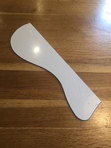

    Thanks to Hobastard's thread I attached my pickguard template to some pickguard material using masking tape and superglue. I then used a straight router bit to shape it, then a 45 degree angled one to cut the bevel. Still a little cleaning up to do but very happy with the result!
Name:	090317 Routing pickguard.JPG
ID:	17884 Click image for larger version.
Name:	090317 Shaped Pickguard.JPG
    Excuse the mess in the workshop!!
