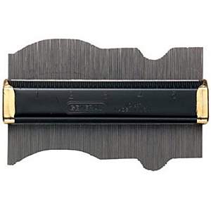

    Mainly my fault, mate. I've only just woken up, so my brain's skipping some of the words ATM. Probably harder to get a good flat surface with one of those sanding disks (an electric plane would be preferable for that), but it could be useful for rough shaping the back of the neck. I'd find a neck shape you like, and use one of those contour gauges to duplicate the profile at different points along the neck and copy those to some cardboard templates so you can easily see how close you are to the right shape.
