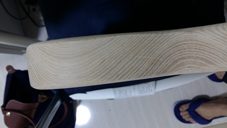

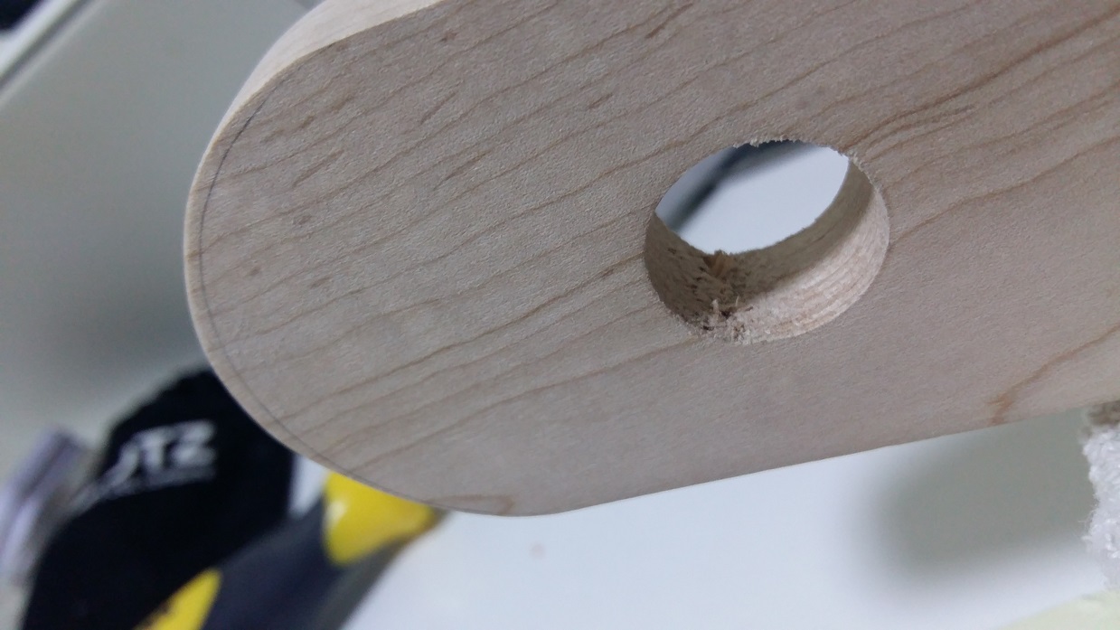

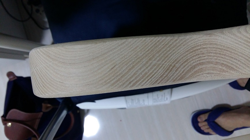

    The marks and glue-filler spot mostly disappeared.

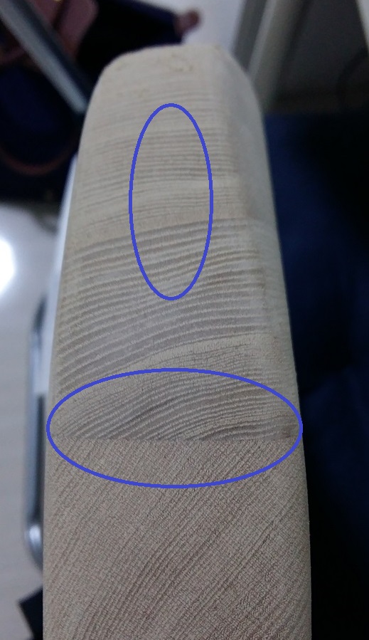

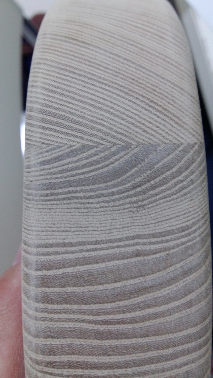

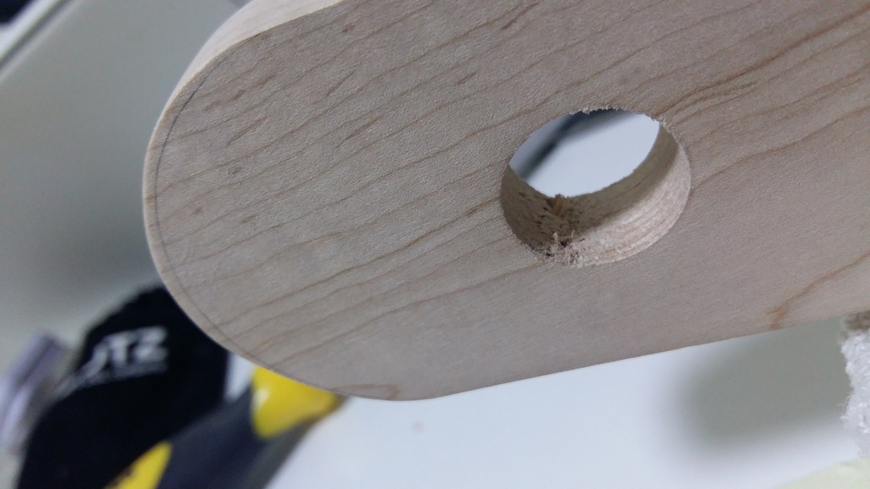

    however, i found two more marks... so i continue sanding body.

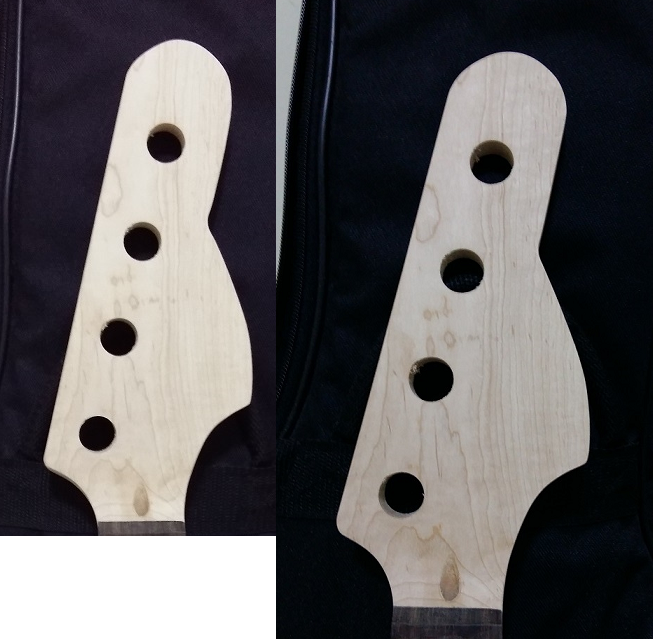

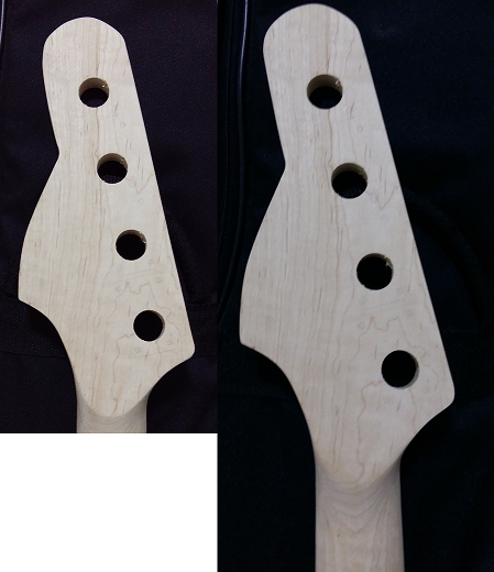

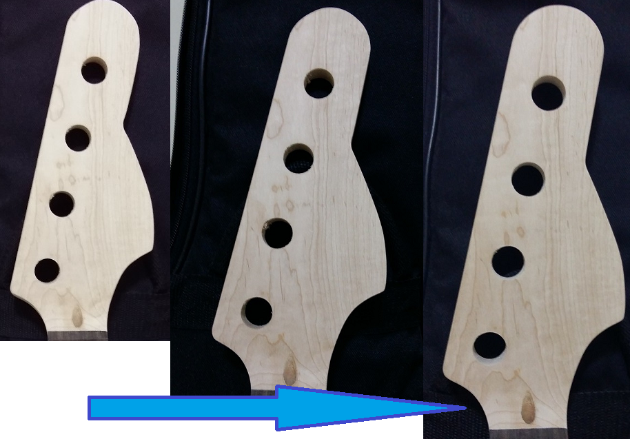

    and the head stock, I have worked with Scraper, and it really worked well. I feel its shape now better, even it was very subtle. what if i continue with working with files to shape, head could've been ugly...

    well done Toshi the body looks much better, when you get a better eye for machine marks you generally find more !!
    You must have huge arms by now with all the sanding !
    Headstock shape getting there, see if you can find a round object about the same size as the top part and pencil in the round shape. At the moment it needs a bit more work to become a more perfect half circle. It will look better if so.
    Otherwise keep going you are getting close to starting the staining process !

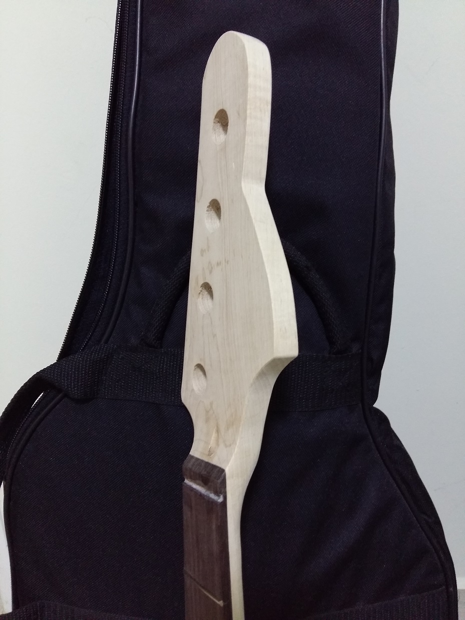

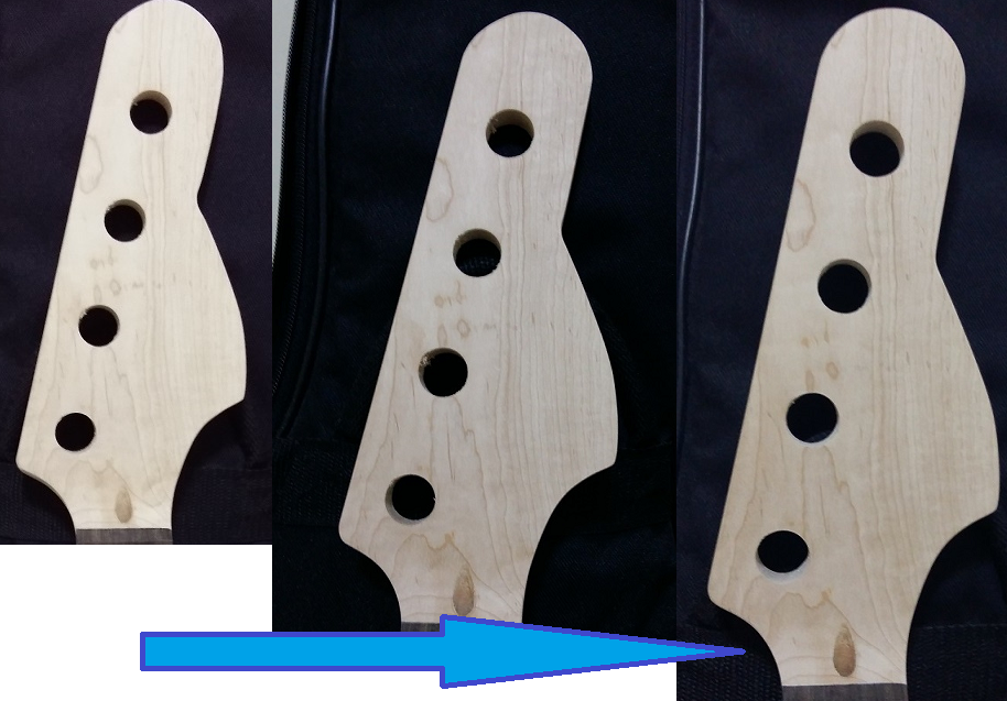

    Hi Wok, thank you for encouragement & another advice. yes, apparently arm muscle is getting stronger day by day.
    I worked on head top yesterday following your instruction. now it looks better, doesnt it?
    by the way, i was thinking of neck process. i would like to finish neck&head by gloss clear lacquer without staining. so far im thinking of sanding neck 120>240>320 and apply primary, then place decal on head and finally spray clear lacquer with a few coat. but what is the common process for neck&head usually?

    No worries Toshi that headstock round top looks much better now ! I have been a draftsperson for over 25 years so I can spot a circle and spot one that's not !
    Neck sanding plans sound good, see if you can slip 180 grit in there so 120, 180, 240, 320, then your decal, then clear lacquer
    good luck buddy !
    if we had to vote for sander of the year (SOTY) I think I would be voting you haha its all worth it once you see the finished product
