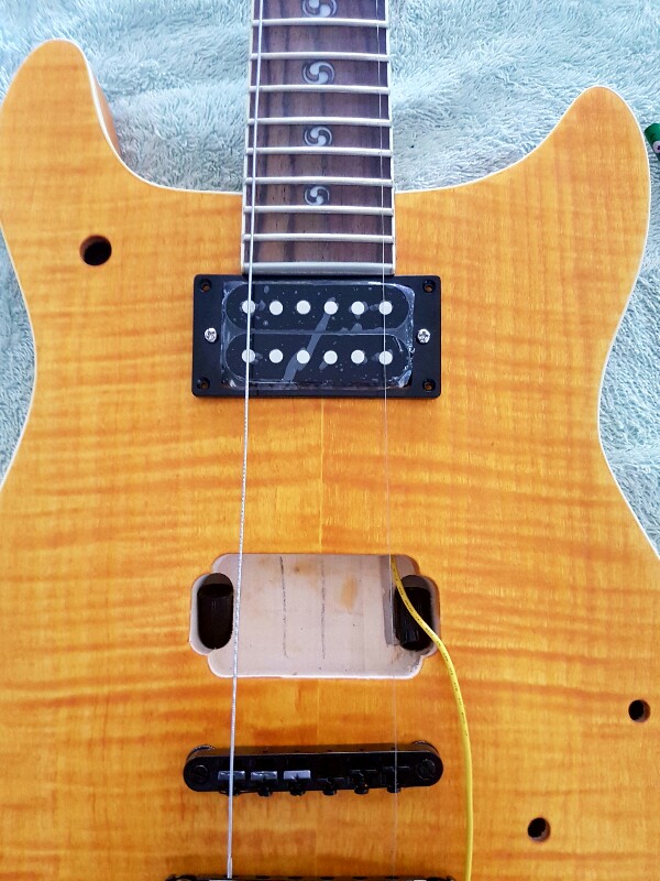

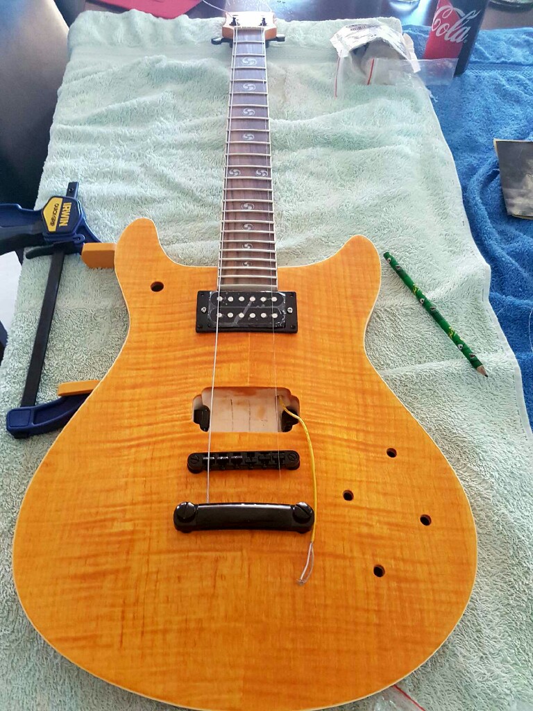

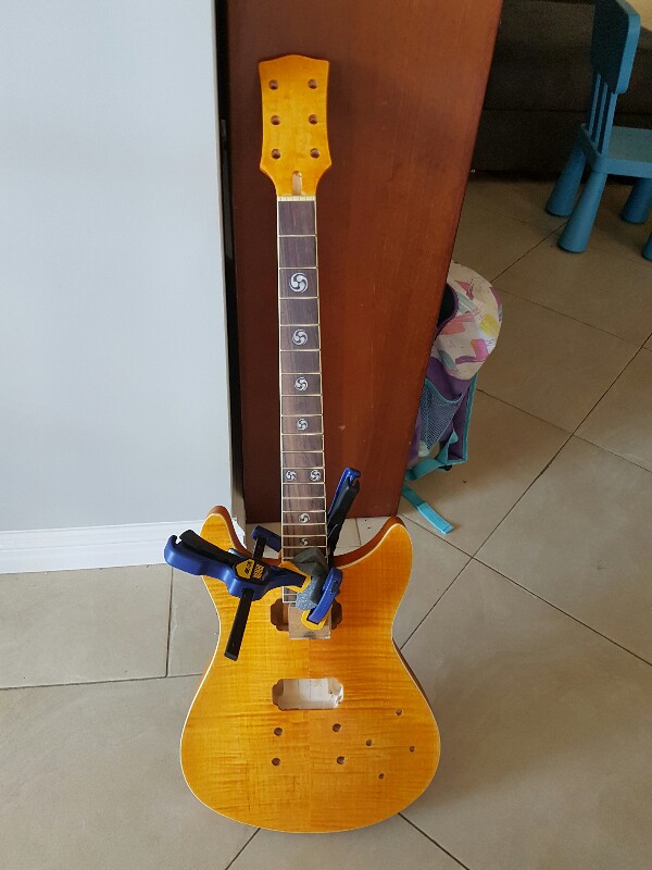

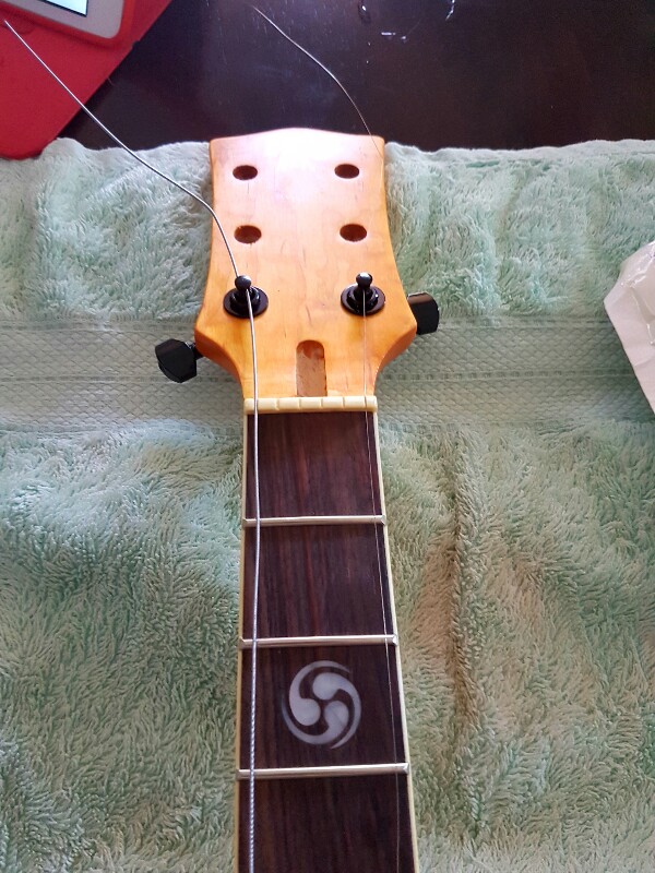

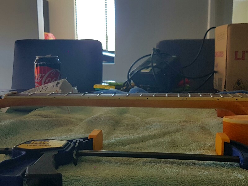

    Finally glued the neck. All seems to line up well. Let this sit for a few days and then get onto the finishing coats.

    Hi David, thanks, still a bit of work to do before I start wiring the pickups etc.... in the pics above I have just done a mock build with the stock pickups... I might put some Seymour Duncan's in it that I have.
    Sorry, I am not sure what you are asking in relation to 'play those in stock kit'? Do you mean wiring them in? There are wiring diagrams in the 'Guides' tab at the top of the page for all the kits.
