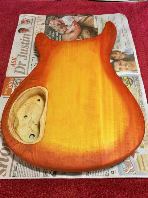

    I've been using makeup removal wipes for the dye application and they work well. I discovered a trick for getting the colour blending more smooth and progressive. After applying the dye, and allowing it to dry a little, I used a damp wipe to rung along the blend line and blur the transition. I'm now happy with the back which ended up like this.
Name:	Back complete - 1.jpg

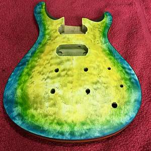

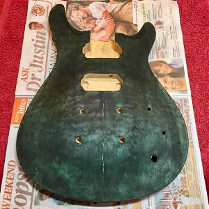

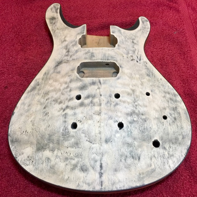

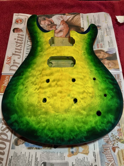

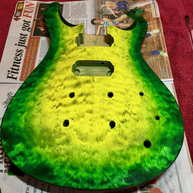

    After a number of applications of dye and a fair bit of sanding on the front I'm also happy with the way this has turned out.
    I started with the black/green base which was sanded off as the grain popper background.
Name:	Front staining - 1 (1).jpg
Name:	Front staining - 2.jpg

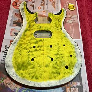

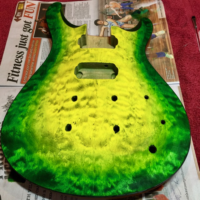

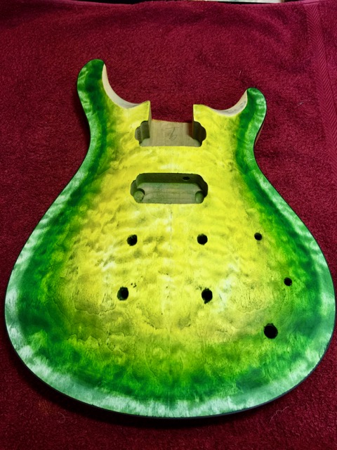

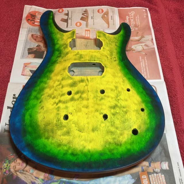

    Starting with the yellow centre, adding the blue edge and blending to green...
Name:	Front staining - 3.jpg
Name:	Front staining - 4.jpg

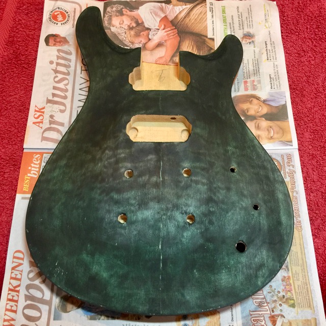

    That was sanded back and yellow applied all over...
Name:	Front staining - 5.jpg
Name:	Front staining - 6.jpg

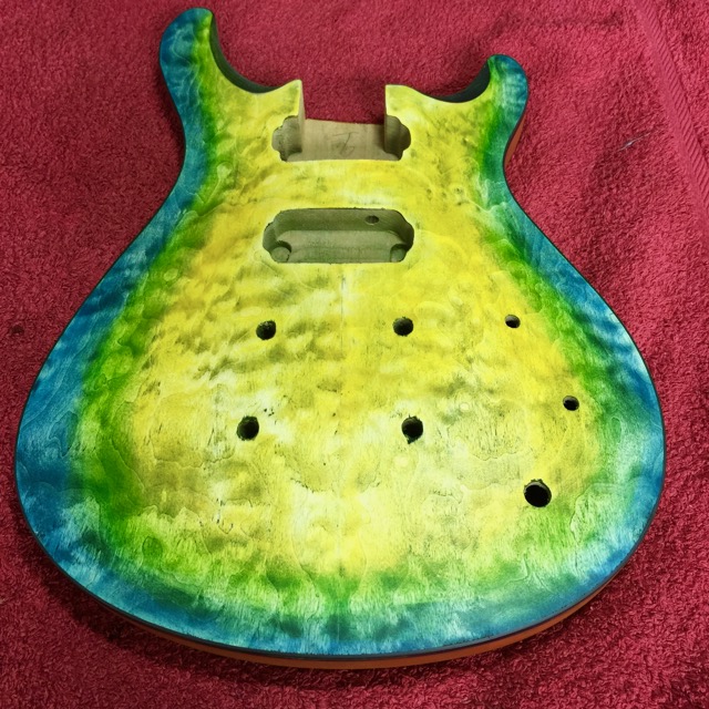

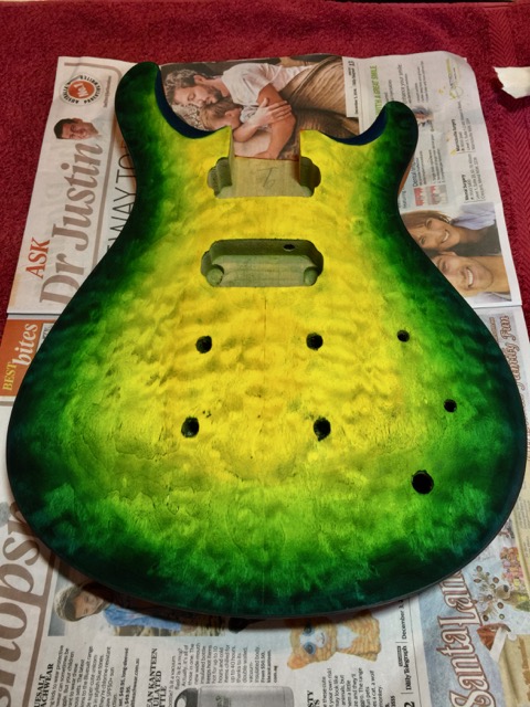

    Then a final sand and application of some more yellow and blue and the damp applicator merging and I think I'm done.
Name:	Front staining - 7.jpg
Name:	Front staining - 8.jpg
    Now to wait a few days before putting the shellac coats on.
    Cheers
    Dean

    It's interesting to me that the front shows some orange among the yellow although I didn't apply any orange to the front. I'm guessing that this is the wood's reaction to the yellow.
  10. #49
    5,551
    That is looking wicked, it should look even better with a gloss type finish.
  11. Liked by: AxeMurderer
  12. #50
    5,666
    DUDE! I am loving every bit of that. Great job!
