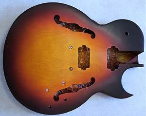

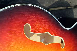

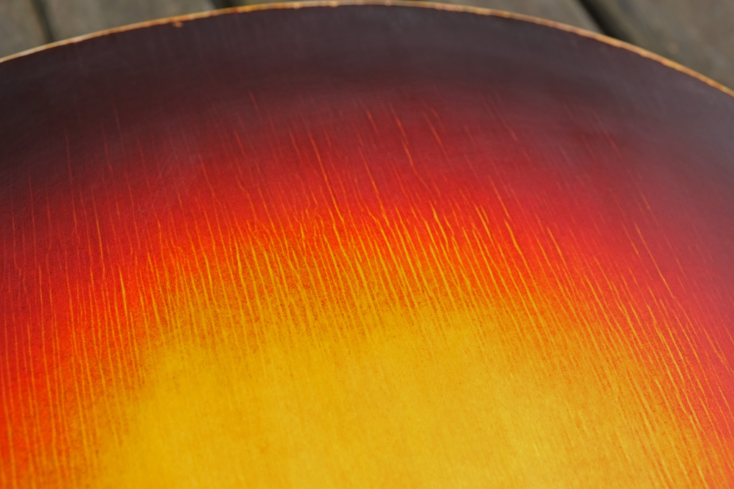

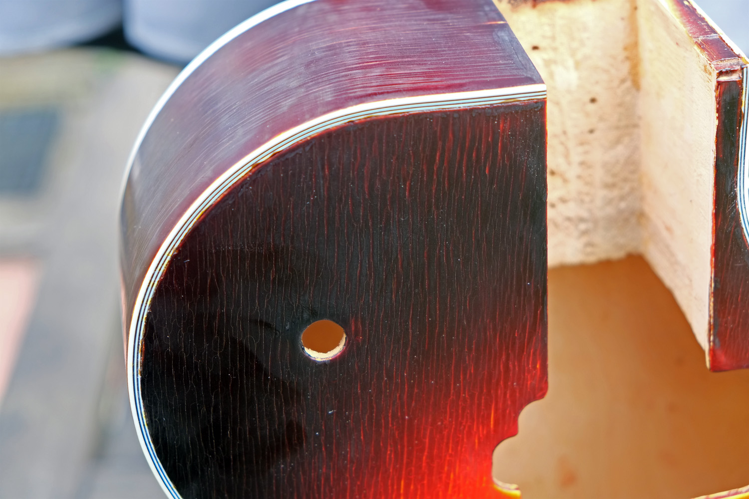

    Over the past 8 months the guitar body has been inside sitting next to a warm radiator. I'm not sure if it was that that caused the problem or some reaction of the paint, but when I had a close look at it as I started to finish off scraping the binding, I found that it had reliced itself. All the paint (except the very thin centre sections that were just the clear amber over the yellow stain) had creased up forming ridges along the grain lines. At first I thought it was simply cracking, which I could live with, but a closer inspection showed the lines to be ridges.
    I'd been hand-painting round the edges in an attempt to tidy up all my binding scraping errors, and needed to sand some of this down to see where I was, but as I sanded, the high ridges got sanded off and exposed the yellow underneath. So I then sanded some more of the body to see what had happened and ended up giving it all a wet sand, leaving loads of very visible lines.
    Here's the top:
Name:	Top small.jpg
    The upper shoulder where youi can see that even the sides went all ridged:
Name:	Upper sholder small.jpg
    Around the upper F-hole:
Name:	F hole small.jpg

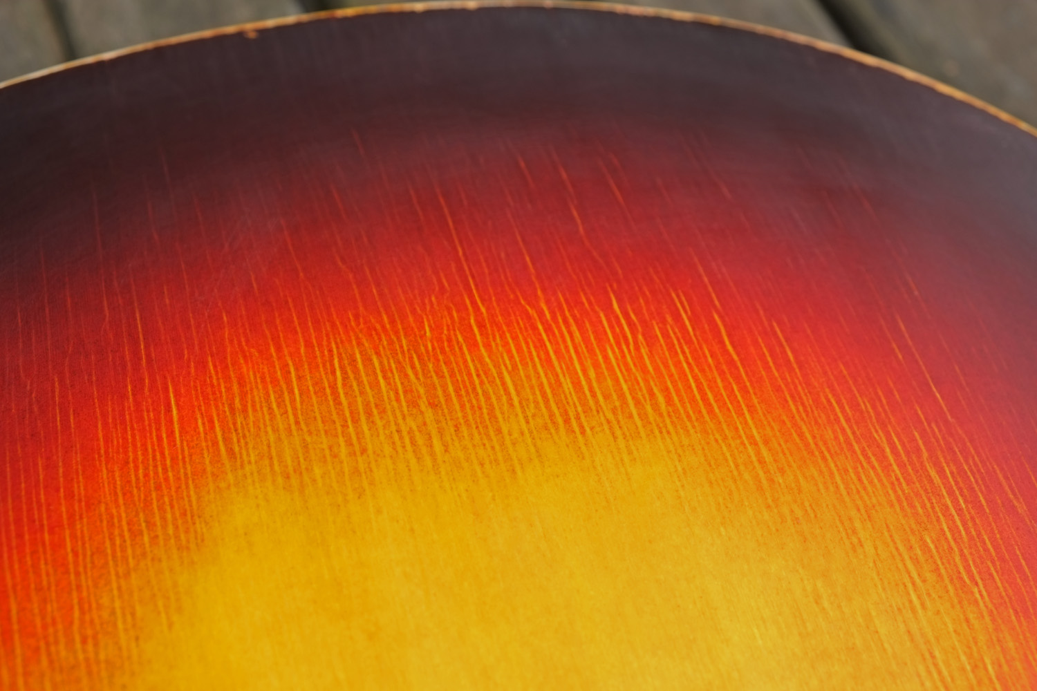

    And the back:
Name:	Back small.jpg

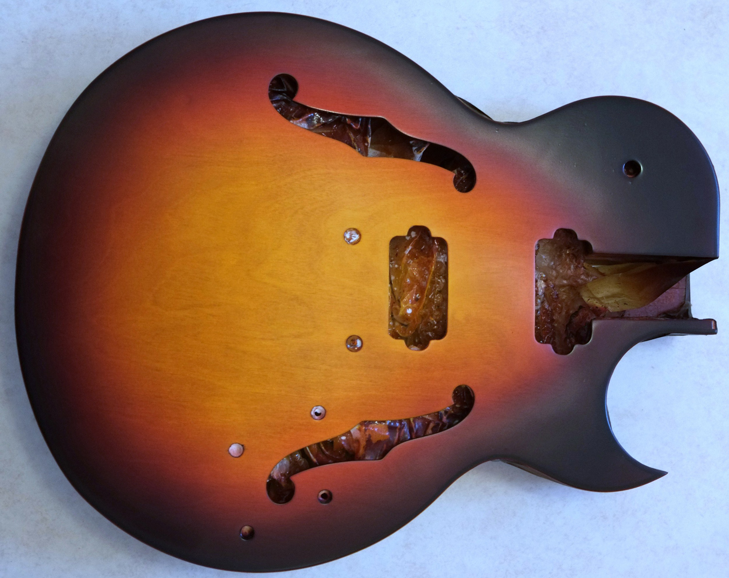

    For comparison here's the top after re-spraying last year when I thought it was looking fantastic.
Name:	175 day 48 Top resunbursted small.jpg
    I'm really not sure what to do now. I can't leave it as it is but the top won't take another sanding down without going through the veneer. I'm finding it hard to get any motivation to do anything at all to it. If I sand it all down again then it's going to have to be finished in a solid colour, and I don't really want a solid-coloured guitar.
    I'm really tempted to just throw it away.
