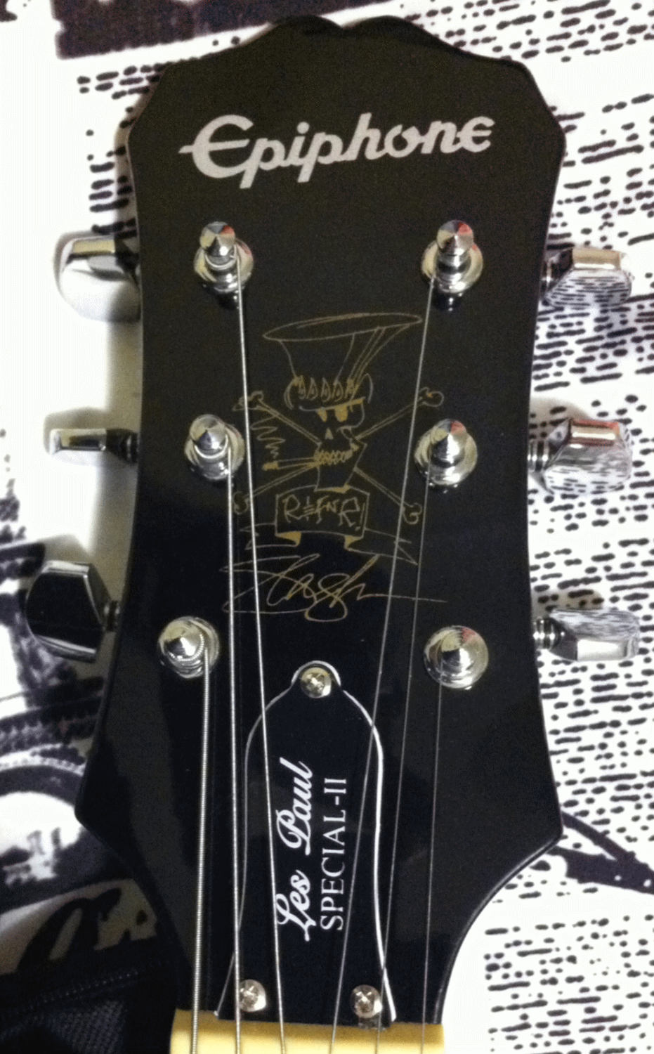

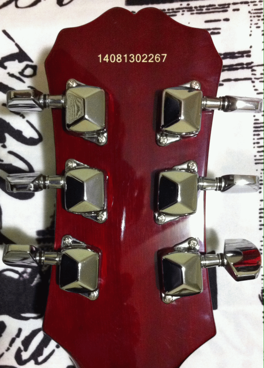

    With the LP Tuners they come in a set that are half left & half right and if you line them up upside down it should highlight such. Just checked all my 'inline' axes and they are all the same as per the set on the Magnum posted earlier.
    Also just took these shots of my 'Slash' Epi LP that was bought a couple of months before starting all this guitar building madness. Obviously it has hardly been played and this is the first time that I have really looked hard at the tuners which are definitely very low end and now on the to do list for an upgrade. As you can see the main tuning peg posts all line up on the same side.
Name:	Epi front.gif
ID:	14232Click image for larger version.
    Hope all this helps in some way.
