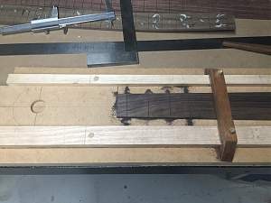

    It's not that complicated, it's just a slightly more accurate mitre box with a sliding bed to advance the fretboard between fret slots, the board is CA/masking tape secured to the bed centreline. The toggle clamps lock the whole assembly down while you cut.
    It's a bit of a work in progress, but the first test cut seemed good. I'm going to prepare a pine test blank to do the fret measurement test and the fine tune on this cracked rosewood board, with some inlay work, prior to getting to grips with the final ebony board.

    5,666
    NSFW warning, the picture below shows a line of slots....

    nice fret jig, Franken, simple and effective
  5. #45
    5,666
    Thanks Stan, I had been playing around with the idea. I decided to just do it. We'll see how it pans out.
    FrankenLab
  6. #46
    cool fret slot jig Frankie, so it clamps the fingerboard down and you use the square edge to rest the saw against ?
  7. #47
    5,666
    Not yet the brown bar is a square rest for the saw and the long bars either side are squared to that to assist with marking up the fret board.
    I've got a couple of small toggle clamps that will go either side of the saw rest to actually clamp the board and sliding bed down but I have yet to fit them. That test was done holding the board in place by hand. It actually worked pretty well but your hand is going to start aching if you've got a whole board to slot.

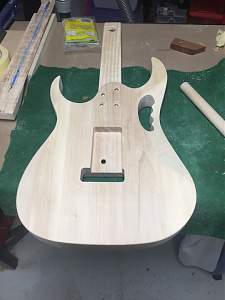

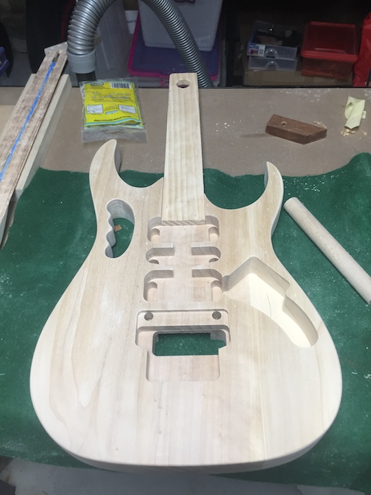

    and sanding is done...down to an even 600 all over for undercoating. Been a bit slack with building, work etc etc. Back on deck with it now.
ID:	14689 Click image for larger version.
    Will likely attack this with some light undercoating in the next week or so, but need to do a light wet sand on the EXA first, prior to another (the last) thin coat of Intensifier.
