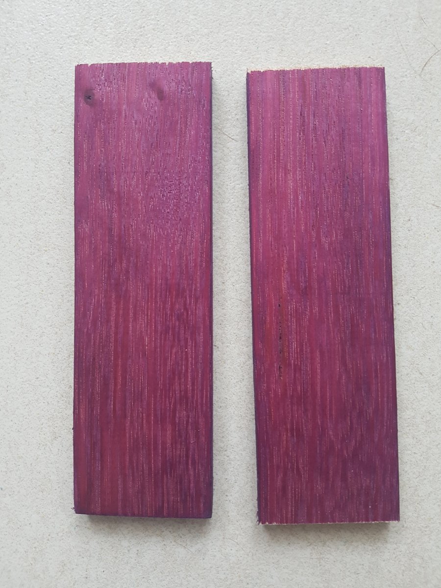

    Based on the YouTube video from Keda, where he makes a royal purple, i mixed about 1 part of blue with 2 of red with a hint of brown.
    I have prepared 2 mixes. 1 with water and 1 with isopropyl alcohol. I then died a bit of tasmanian oak I had cut in 3. The colour is close to the mahogany from the kit.
    My mixes are slightly different in colours as i didn't really measure the dies. But looks pretty good
    The plan is to try different finishes to see how they alter the colour or not, then cut each bit in half and for each bit leave one half in the basement and expose the other half to the sun to see how it holds...
    For finishes i am going to try: acrylic gloss, Dingotone top coat and wipe-on poly.
    We'll see how it goes!

    Liking the Magenta shade the most out of those samples. Far right on 1st shot and middle on 2nd one above.

    The 2x magenta ones are the isopropyl mix. Was much easier to apply than the water mix as it just soaks into the wood.
    But colour wise the darker one is growing on me!
    Sent from my SM-G935F using Tapatalk

    I like the one on the right Fred. The darker purple is cool.

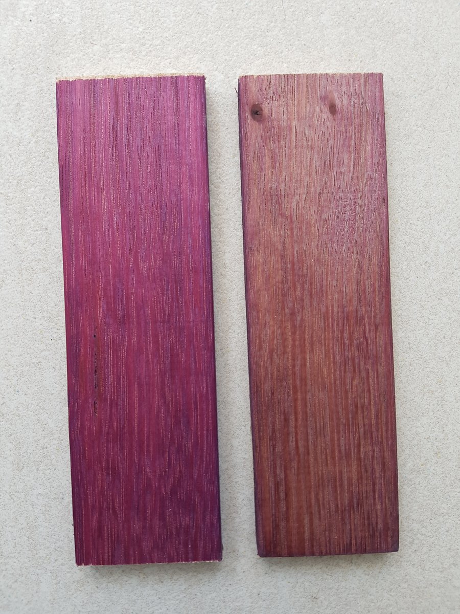

    So, some time has passed since I started my tests.
    I started exposing the purple/magenta tinted bit on the 21st Sept.
    Below are photos showing both bits of wood at the beginning of the test on 21/09, and after then on 15/10, after about 3 weeks of exposure:
ID:	15494 Click image for larger version.

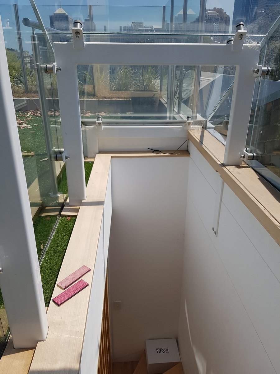

    I thought my test might be a bit harsh as I exposed the test bit on my rooftop terrace where it is exposed to full sun and heat all day.
    Here's where it was:
