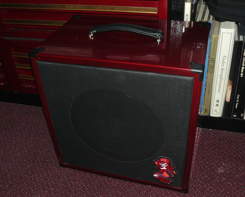

    it was hot today but still managed to sand and polish, then fit out my 1 x12 open back. . It has a Celestion Greenback inside 8ohm 25w. The speaker itself was originally in the big closed back box, but I replaced that with a Jensen Falcon 50w

    I bet it sounds as cool as it looks Dedman.

    sweet looking cabinet Dedman, what clear coat have you used ? looks shiny
    how does it sound ? do you run it off another amp as an external speaker ?

    Great looking finish Dedman, but shouldn't it be more .......Black???!!

    Funny thing Zandit, I'm currently working on my FIRST gloss black guitar LOL
    Wokka, it can plug into either my beheaded Vox VTX20 or Orange Micro Terror. It's just car acrylic, the last top coat before the clear has some blue pearl mixed into the burgundy metallic so it really shines.
    Sounds good, not as good as the Jensen but I havent had time to fiddle tones yet
