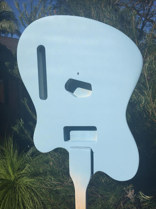

    With the return to sunny skies I've started on the colour coats. All looks good so far but I just wanted to check the general consensus on sanding the colour coat back before you start on the gloss coats. I've seen advice for and against on the forum so just wanted to see if I'm missing anything...
    The colour looks pretty solid at this point (I'm using MTN94) but the surface looks a little like 1200 sandpaper - smooth but with a very fine texture. Now I'm guessing that the gloss will "fill" the texture and you'll never notice once it's all done, but I'm not sure!
    There are also a couple of spots on the body where a bit of dust has settled, and I feel like I want to sand them but simply not sure! Edit: Just had a closer look and I was able to wipe the dust away so now it's all okay.
    Any advice greatly appreciated!!

    I usually sand the last colour coat to about 800, you don't want it too smooth, it needs some tooth for the clear to stick to

    So this morning I go back to view my handywork and I'm a little disappointed. There was a very subtle "striping" across the body as a result of the way I'd sprayed. As I mentioned I'm using the MTN94 cans. When I ordered them I did notice they sold different "heads" for them, including one with a rotating nozzle - but no, I didn't get one. Instead I was spraying with the standard nozzle which meant quite a narrow flow of paint. After two colour coats I did think I was done, but I couldn't live with the "striping" so I did another colour coat this morning and it seems to have pretty much fixed the problem - certainly something to be aware of in future.
    Later this afternoon I very gently used some 800 to flatten off the colour coats (thanks Dedman) and started with a fine gloss mist, and then a more substantial gloss coat half an hour later. Hopefully I'll get the chance to get a few more on during the week, but it's a nice feeling to be on he home straight in the finishing department.
