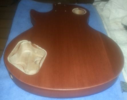

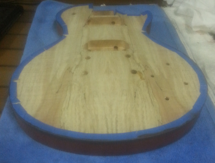

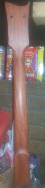

    I haven't been on here for awhile. I did a test run of a poly clear coat with my old knife block which I'll use for this build.
    I haven't decided what to do with the face. I'm leaning towards leaving it natural and just doing clear coat.
    Here are a few pics after four coats of jarrah sanded to 400.

  7. #47
    Hi Alkay, that Jarrah on the back, sides & neck looks very lush and agree that a natural top would look great and provide a nice contrast. The photo was a bit hazy but still showing plenty of spalt for you to work with.
    Thanks Waz, Yeah it looks allot better to the eye in person but my camera isn't the best. I think the natural spalt looks good otherwise it might be a bit too busy if I try and do a colour burst of some sort on the face.

  10. #50
    Can't think of anything that would go better with the Jarrah either unless you run with gold or yellow tones but reckon it will look a deadest killer just natural in all it's naked spalty goodness.
