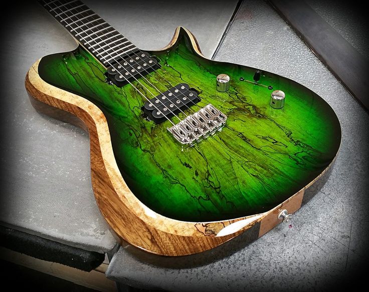

    Been doing some google searching, hoping to find something that will tell me that this will look like under both natural, and coloured stain.
    Any votes? Keep in mind, I won't be having the stacked colour on the green!!

    Of the 2 the straight timber will be easiest to achieve, I guess it depends on how adventurous you are Joes green LP came up great.
  9. Liked by: Zandit75
  10. #48
    Hey Zandit, whatever stain colour you apply will look good, as long as the colour isn't too dark and hide the spalt grain.
    I think natural will look good too. The black hardware will look great with the dark spalt lines too

    Thanks Dedman & Wokka, I don't suppose you have looked through the other photos and can answer some of my questions on those?
    Thanks in advance!
