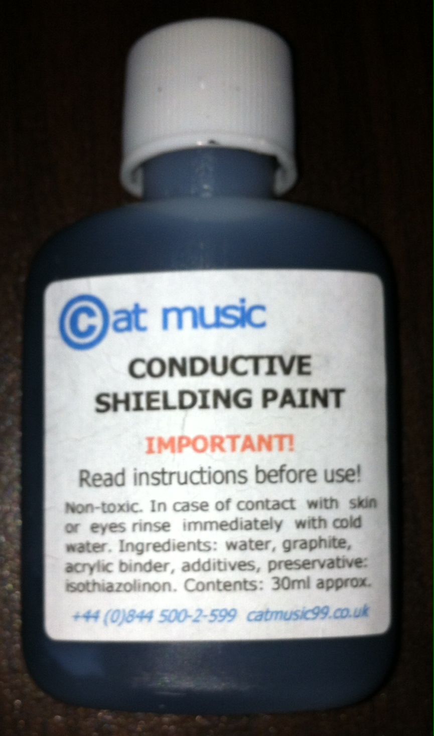

    What are you using to shield your cavities? I just have the copper shielding tape.
    Hi Alkay, Used syringes to measure quantities of ink & water and then squirted each into another small round container that you can buy in packs of 8 or 10 at Woolies for about $2.50. Then proceeded to shake the mix for about 30 seconds to a minute and just ragged the stuff on with a cotton lint free cloth, in fact it was strips cut from an old T shirt which seems to work best as all the lint and fluff had worn off. Basically the same process as shown in the PBG Videos except the ink mixture is far more watery than DT and 1st coats are very thirsty so you need to have plenty mixed up ready to go. Also need to use those blue industrial strength rubber gloves as I got some of the blue ink on me when wiping down between 1st & 2nd coats and it took 3 days of scrubbing to finally disappear.
    The shielding paint used in the cavities was bought on eBay from Cat Music who I think are based in the UK. Copper tape is good and highly recommended for single coil PUP applications such as on Strat's & Tele's.
    Here is a photo of the bottle...yet to fire up the Tele & J Bass as planning to do final wiring on both tomorrow, just been giving them a bit of a rest waiting for the necks to settle after taking up initial tension. Will let you know if there is any buzzing going on that would indicate a fail......the stuff worked a treat on both EX's builds as they use Humbuckers.
    Thanks wazkelly,
    Thats good advice for the ink and water ratios and I will keep that in mind.
    I have heard mixed reviews about the shielding paint. My last LP build on here I used copper shielding tape and had a terrible buzzing sound but that could have been my poor soldering too. It also took many many hours to apply the shielding tape
    I'll be interested to hear how it goes after you do the wiring.

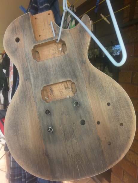

    Hi everyone,

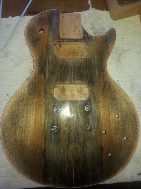

    I've still been trying to remove the excess black stain on the body.
    Here is a pic just taken outside in the shade a few minutes ago.
    It's still too dark for Cedar isn't it?

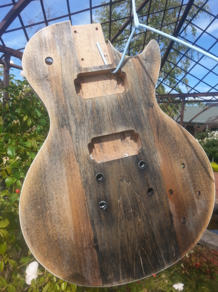

    and here is another pic in direct sunlight.

    G'day Alkay, how does it look when slightly damp as that should give an indication of how much the background will jump out at you once top coats go down. Looks a bit risky to sand as those caps are barely 1.0mm to 1.5mm thick.
    Tend to think you may end up with 'Reverse' grain popping where the Cedar will highlight the spalted bit from stop tail piece section to strap button location and also help to bring out the other bits on the outer planks.
    Here are some pics I have just taken outside while it was damp.
    Outside in shade:

    Outside in sunlight:

    Yes I agree with you about the sanding. I'm too worried to do any more incase I go through the veneer.
    I'm not sure if Cedar is a good choice now. It doesn't look that appealing to the eye so I'm open to any suggestions anyone may have.
