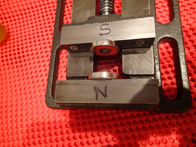

    So today after being the master plumber of the house, and saving myself 4 hours paying a plumber, i decided i might do a bit of magnet charging. I had a couple of strats to do and Woks tele.

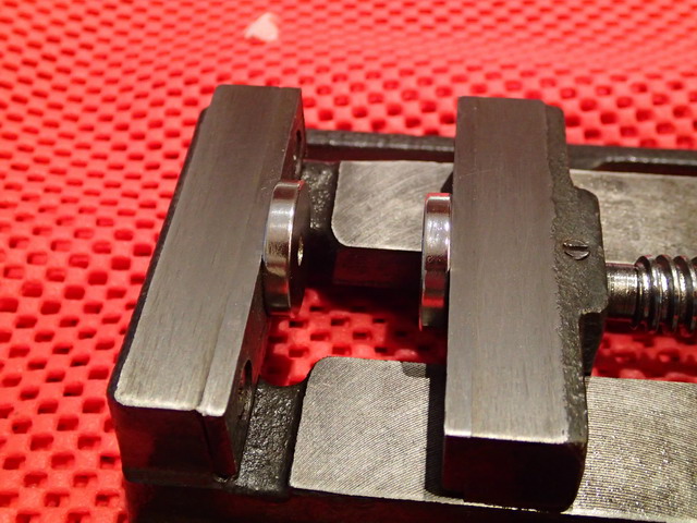

    Heres how simple it is:
    I put 2 Strong Rare Earth Magnets attracting each other in the vise, i mark which side is face out, South and North and mark them.

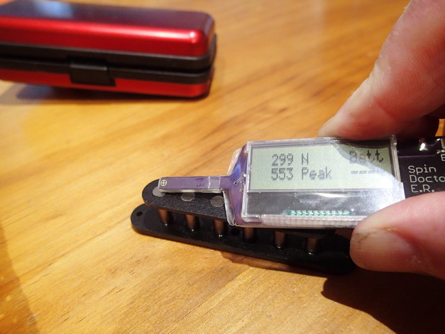

    Run the pickup slowly through the magnets, the pull is strong, this is the reading after 2 passes, i do 4. To get a south side facing pickup like this, the bottom of the pickup goes to the South Magnet, the Top to the North side

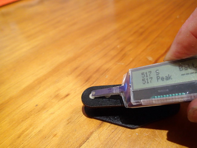

    Reading south Facing

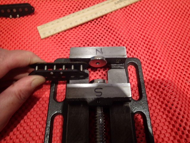

    You reverse the pickup to get a North facing neck pickup for RWRP, top facing south bottom facing North
    Your actually doing the opposite of what you want the magnet polarity to be.
