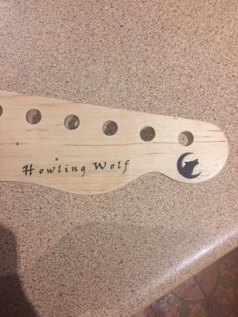

    Hey Waz,
    Yeah I know re stamp pad ink. If I didn;t try it myself I wouldn't have believed it.
    Yeah this is my headstock decal which is a waterslide decal. Click image for larger version.
ID:	11972I did roughly 2 or 3 neck coats of DT, lightly sanded till even I think with 2000 or 1200, then applied the waterslide decal, waited 24 hours then applied another 2 or 3 neck coats of DT, then sanded flat with 2000. Its held up pretty well but you have to be careful when sanding.
