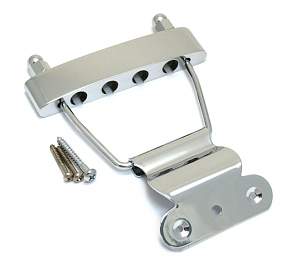

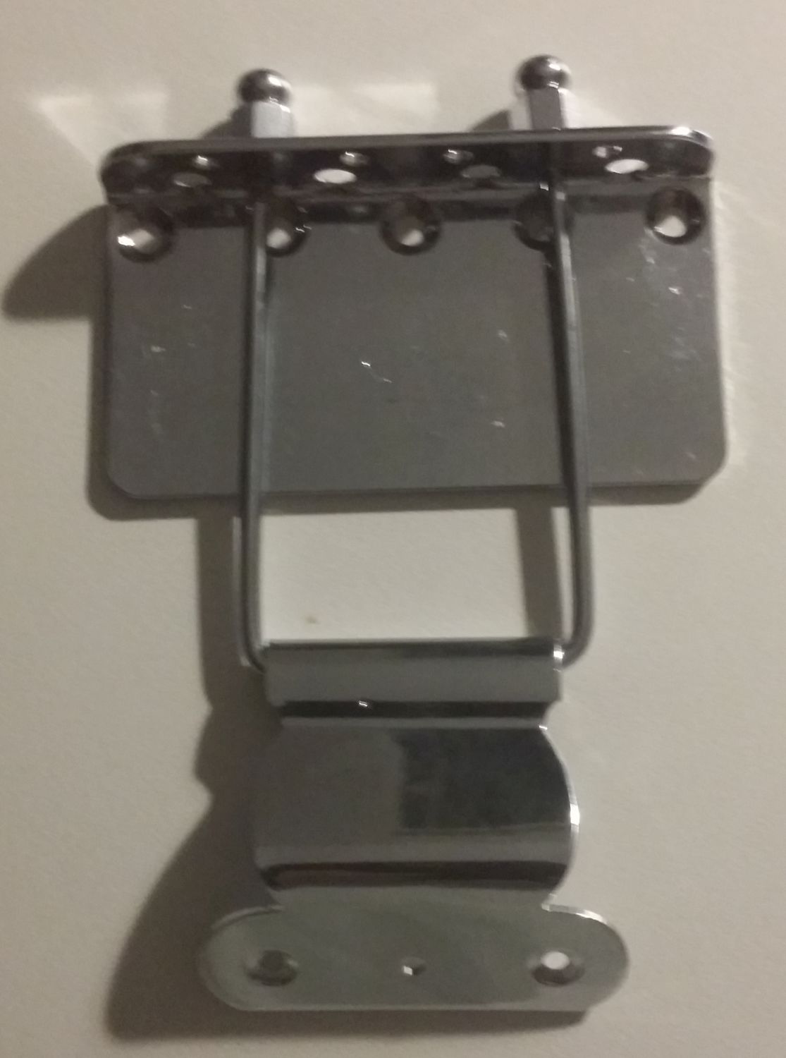

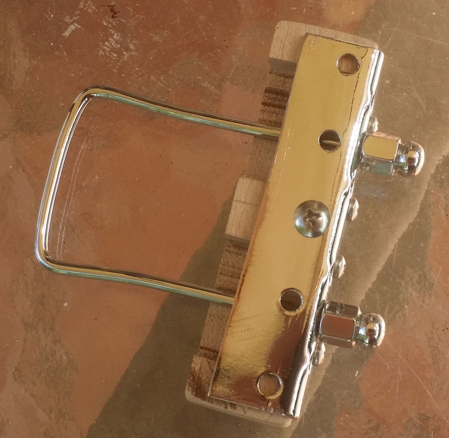

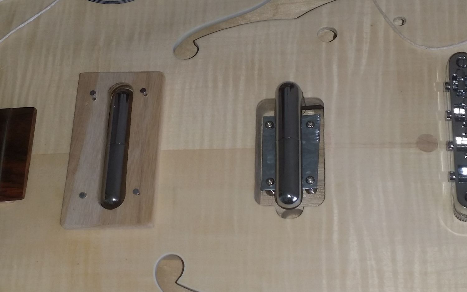

    OK, now to the tailpiece conundrum. I only found one trapeze tailpiece short enough to work. So, I bought it on Ebay:
    Unfortunately, the string spacing was too narrow the Gibson style bridge, which has standard Fender spacing. The tailpiece was much narrower. So, here’s my “solution,” at least for now.

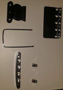

    I thought about creating a cross bar out of wood. However, I was concerned that it might not be strong enough and would be hard to ground. I went back on ebay and bought a Fender p/j bridge base plate, and then disassembled the the ebay tailpiece.
    As you can see I have bent the wire tongs on the tail piece to be a bit straighter.
    I drilled a couple of holes for the tongs between where E and A string holes and between the D and G string holes. At first I thought the tongs needed to be outside the strings, but I saw a Framus that was done this way, and it just spaces better between the strings. I could then assemble it as a tailpiece like this:
    That would more-or-less work, I figured, but was, frankly, pretty ugly. Even for me. I also thought the long bottom plate might cause trouble.
    Continued next post...

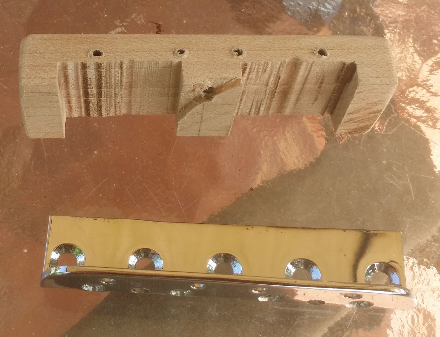

  6. #46
    3,030
    ...continued from previous...

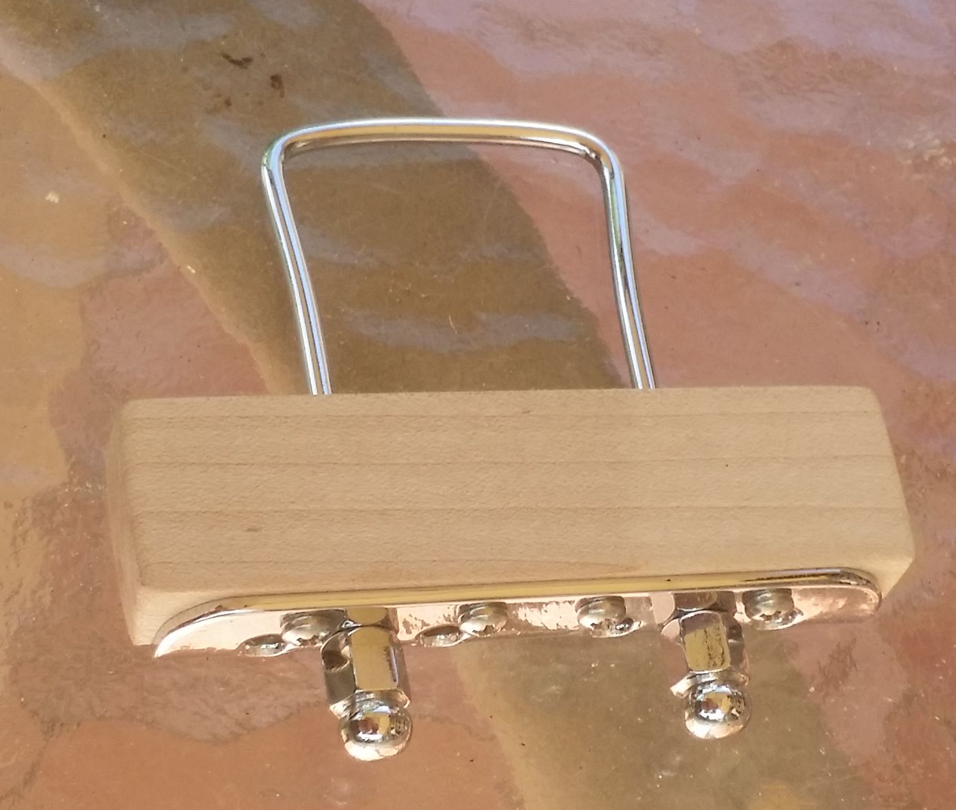

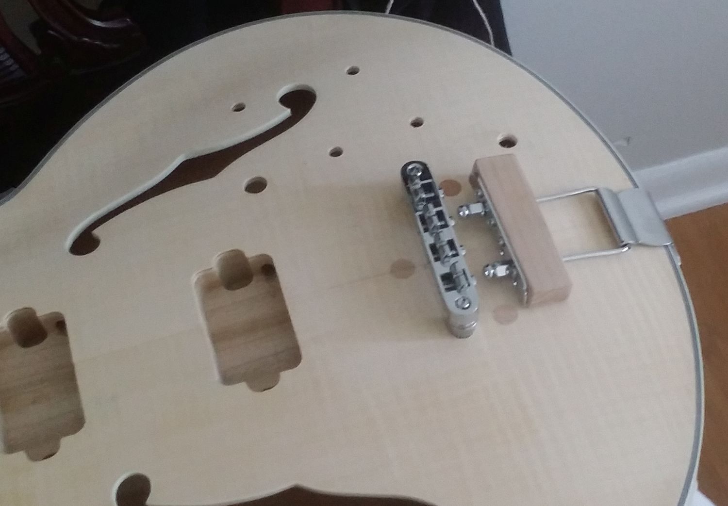

    I cut the bottom half of the Fender base plate off, and made a maple cover for it. The maple cover has slots to slide the tongs and strings through.
    Strings touch metal, so there should not be a problem grounding either at the tailpiece or at the bridge. Here’s what the top and bottom look like
    And here’s how it looks in the mock build:
    This was pretty much all an ad lib so feedback will be appreciated.
  7. #47
    My only concern is will there be enough downward angle on the strings behind the bridge.
    Will you be finishing the wooden block with the same or a different finish?
  8. #48
    3,030
    My plan right now is to finish the block the same as the body... Sort of maroon. I am open to suggestions, however.
    Hadn't considered the break angle. I got out a protractor, but still had to eyeball it a bit to see... It looks to me like the break angle will be about 15 degrees. I could potentially get it down another degree or two by bending the part of the tailpiece that has the hook. Does 15 seem like enough?
  9. #49
    A nice and good looking solution to your problem
    I think it should be fine as is, and you can always modify it if it isn't quite right
    As long as the strings fit nicely into the saddles, and stay there, you should be ok

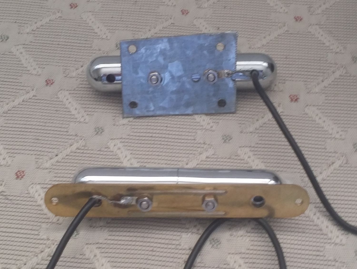

    Part one of mounting Dano pickups in a standard humbucker rout....
    First thing was to get rid of the brass Dano base plate. The full sized Dano pup will fit inside the "ears" of the HB rout, but the baseplate will not. So, I replaced it with a piece of steel that I cut out with some tin snips. I drilled the four corners, and two holes for the Dano mounting bolts. Not as attractive as the original Dano mounting plate, but functional.
    I used screws and springs from a set of Jazz bass pickups to mount the Dano pickups inside the HB rout. In the pic you can see the springs compressed new/ugly base plate of the bridge pup.
    I put my mock up of a pickup ring that I made with some scrap wood over the neck pickup, just to see how it will look, and check for fit. The actual ring will be thinner. The nails are there to make sure that the holes are in the right place--inside the corners of the HB rout. The real pup ring will have screws, of course.
    Sharp eyes may note that the pickups are not centered in the HB rout, but are as far "south" as they will go. That's because the routs don't quite line up with the neck. To get the pickups to line up with the neck and bridge properly, I had to put them as far south as they'd go. It won't be noticeable once the pup rings go on. Assuming part two, making the pup-rings goes as planned ;-)
