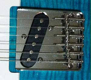

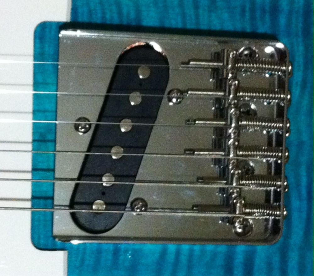

    After buying 2 more bridges finally installed the 2nd one this afternoon which is more of a traditional ash tray design with 6 individual saddles. The 3rd one had saddles similar to modern strat's but they rode too high off the deck and couldn't adjust the action down low enough.
    Through all the swapping and changing the bridge Wilkinson PUP stopped working??? Multimeter showed current but still no sound? Thankfully the stock Chinese one was lying around and still works and sounds almost OK and will do for now as I need to get on with fine tuning the action and intonation. Maybe down the track an upgrade bridge PUP might be installed and there are plenty of options out there, just need to get this thing finished to make sure there are no other gremlins as this one has dead set been my problem child with most of the issues being centred around intonation. Hopefully on the home stretch now.
