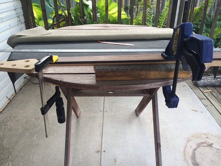

    Don’t know what I did wrong when gluing the fingerboard to the neck, but the neck WAS pretty straight before I started and now has an up-bow (I think it’s way too big to be called relief) of approx 2mm.
    I think it’s asking too much of the truss rod to fix this, and although I can level the fb out when I radius it, I would prefer to have it at least a bit straighter than it is now.
    Apart from taking the fb off and starting again I’m not sure what to do.
    So I decided to try some easy fixes first. I have put some clamps on the neck and I will let it sit for the rest of the day and see what happens. It’s going to be pretty hot and humid up here in Brissie today so that might help a bit.
    Apparently we learn more from our mistakes, so it gives me a chance to find ways to fix an up-bow.
    Yep Woks, learning heaps. lol
    Pic 1 & 2 - the up-bow.
    Pic 3 – all clamped up.

    Ive fixed upbow once by clamping a caul in the middle of the neck and clamping either side to pull it down
  10. #50
    Mentor robin's Avatar
    Brisbane
    1,513
    Thanks Nick, I am doing something similar to that now. Can you remember how long it took for the wood to adjust? I don't want to give up after 12 hours if 24 or longer would have done the trick.
