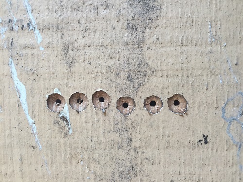

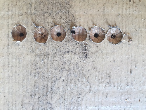

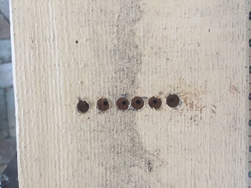

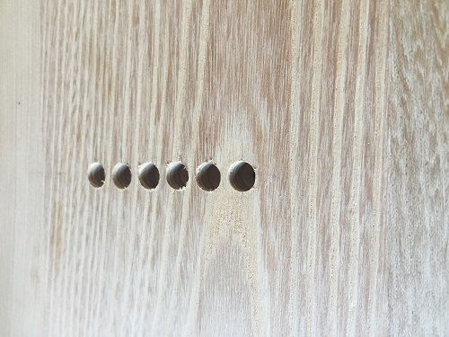

    Further scrap tests...
ID:	8415..awww cmon...NO
ID:	8416..No, no NO

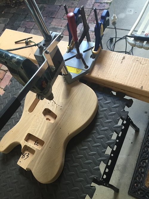

    All tweaks adjusted, time for the real thing....
    And a photo of the contraption

    That's looking pretty damn tidy. Love the drillamajig contraption you've got going there. How did you get it aligned for six holes?
  6. #46

    @Bluesy, each time i tested it, I tweaked the stability with the position of the clamps and the wood on bench, the height and measuring and re-measuring before drilling. The only thing I would have done differently is bolted the contraption on to the planks under it for even further stability. I did discover that even if the string through holes were slightly off centre (and I mean slightly) the larger ferrule bore on the opposite side will cover up the inaccuracy, conversely, the ferrule bore must be measured perfectly (then drilled) or it will look like poo.
