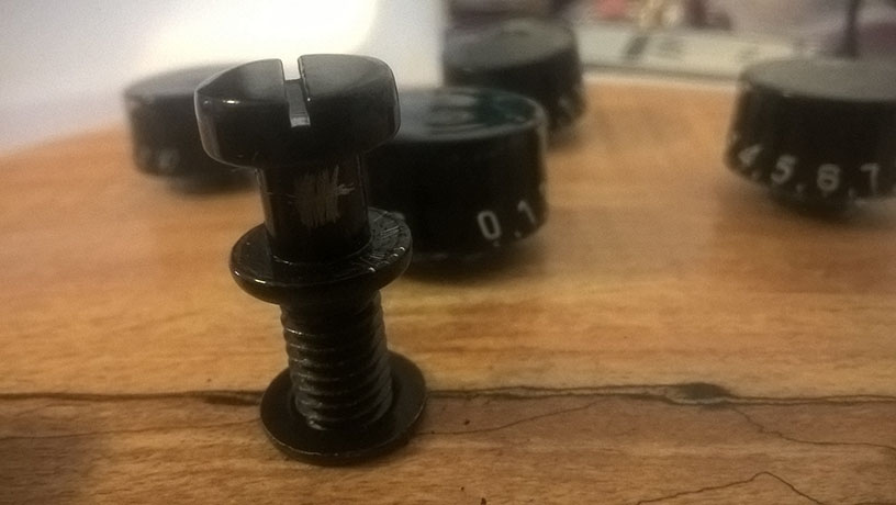

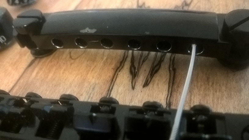

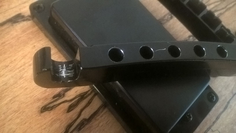

    So a lesson for the kids - the black coating on the stock hardware is non-conductive. I had to scratch up the bolt and tailpiece in order to ground the strings and get the buzzing to a manageable level. This was after trying to troubleshoot wiring and eventually connecting a pickup directly to the tip of the lead and realising the stock pickups are just noisy (tested the Toneriders in the same way and they are much quieter).
    In hindsight, it may have been better to scratch up the underside of the top of the bolt and the top of the stop bar. As it was, I had to set up the multi-meter and use a screwdriver to 'tune' the bolt until I found the one position where it would complete the circuit.
ID:	8667 Click image for larger version.
    Used a screwdriver to scratch out the edges of the string holes. Even then, I had to test each string once it was at tension.

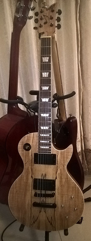

    After an initial setup and playing it in over the weekend, I quite like it. I didn't have high expectations for a first go. The stock pickups sound alright, though I think the guitar has a really good unplugged tone that the stock pickups just don't convey.
    It's not finished in any case, the tuner screws haven't been installed and I still need to attach all the plastic covers. The stock parts are just a stepping stone to see what difference upgrades make.

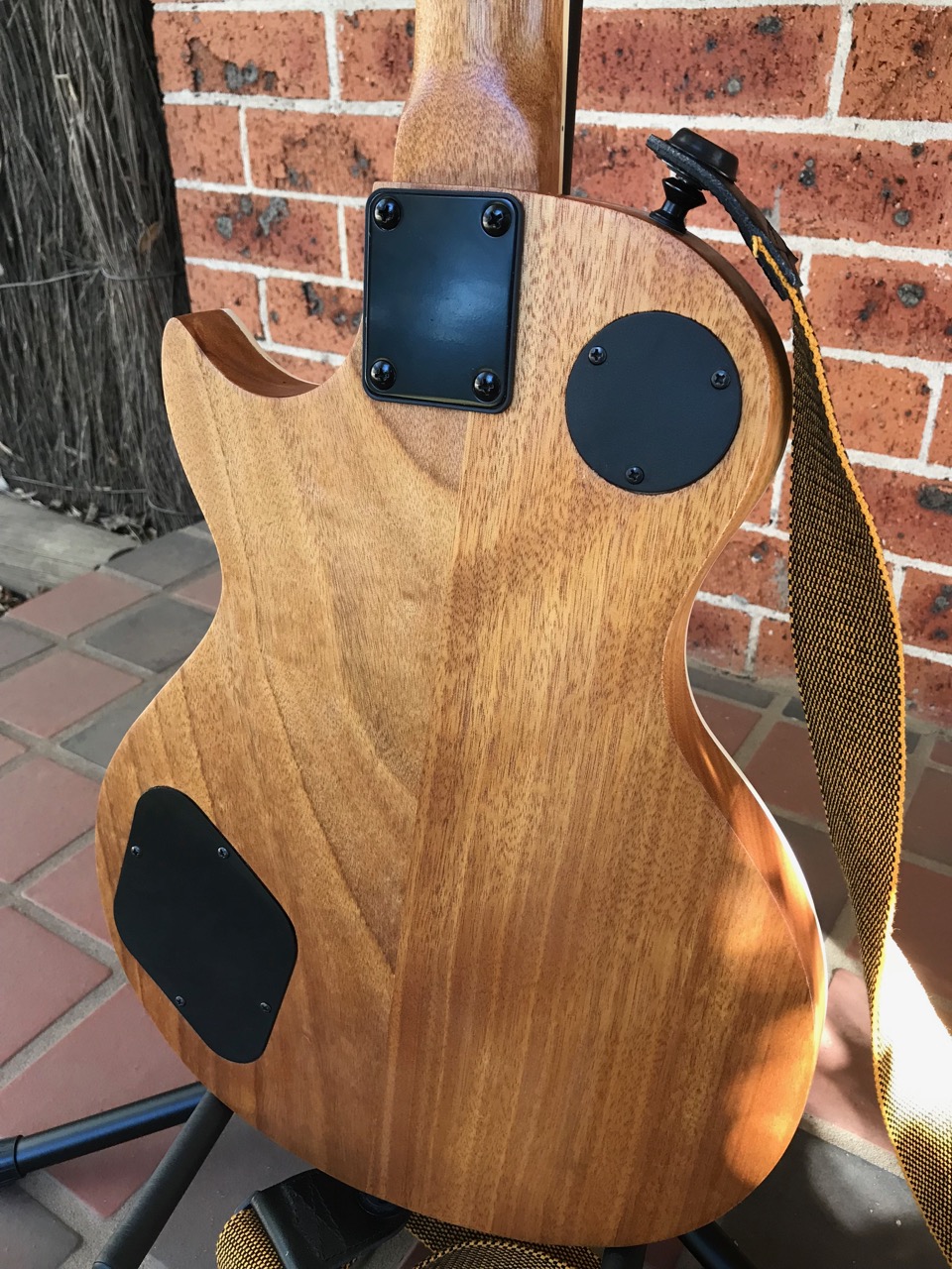

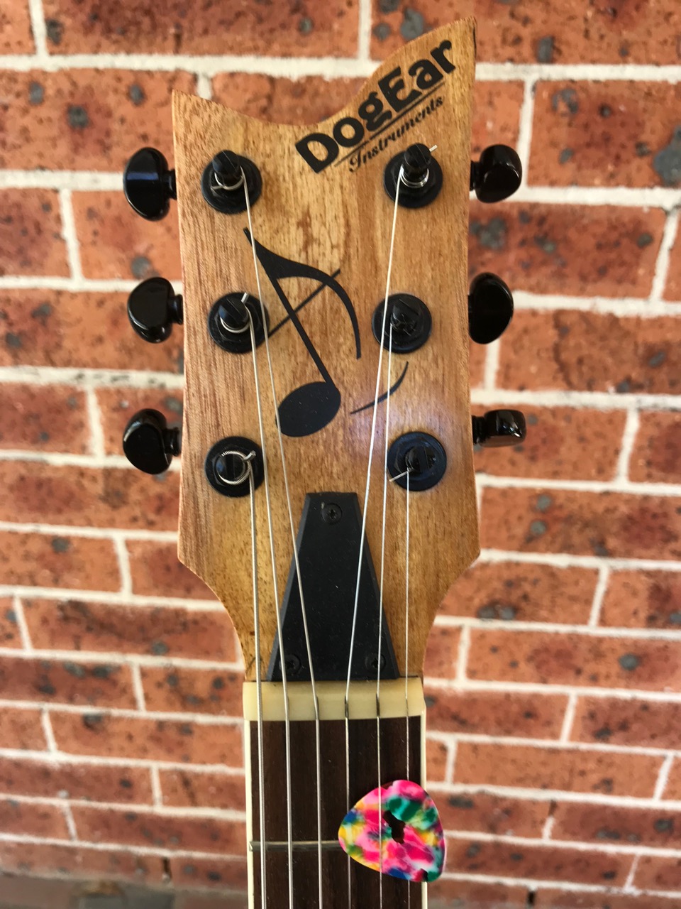

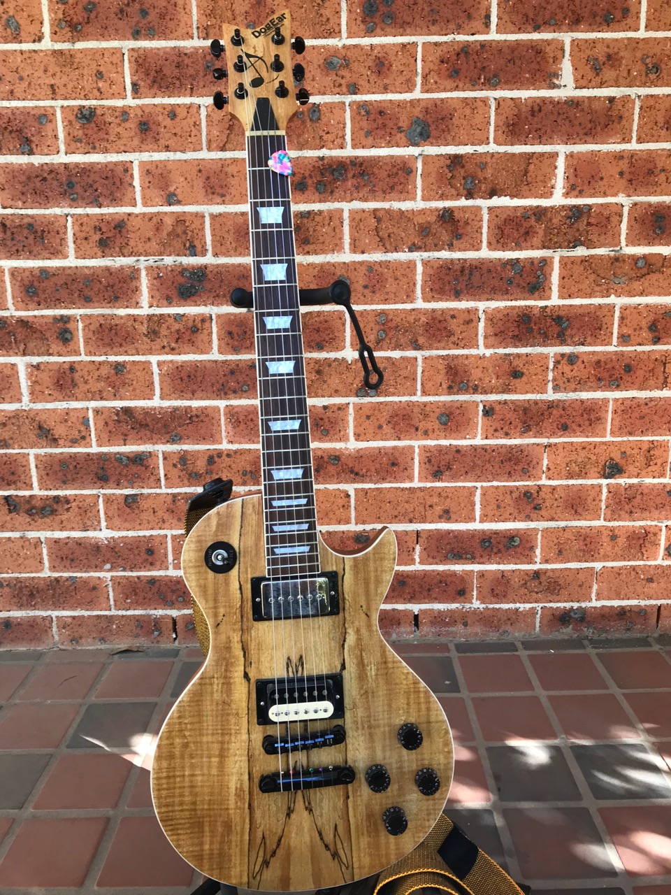

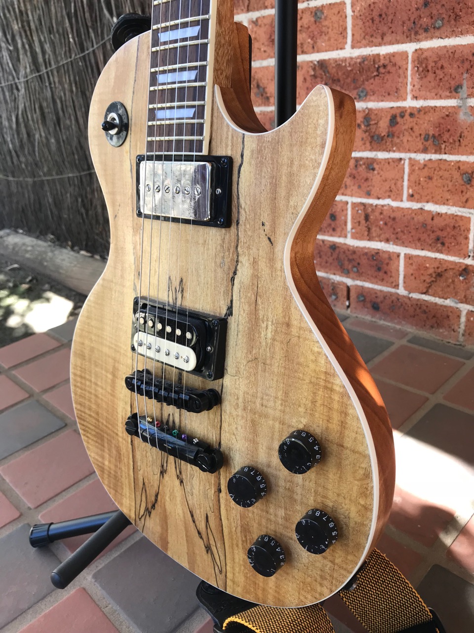

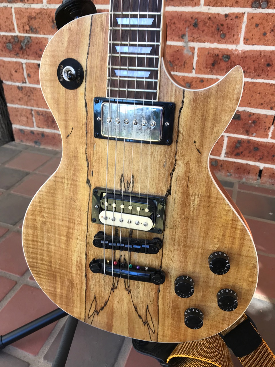

    Looking back at the last posts, I got so close to finishing but things went downhill quickly with this and my other build to the point that working on them was a chore.
    The electronics killed it for me on this build, and when that was sorted the high e string kept breaking so this guitar has been on the rack gathering dust for two years. I only recently discovered the lazy solution of top wrapping the stings and it seems this guitar is quite the sleeper.
    It actually sounds more like a tele than a Les Paul. At a jam session recently I lent it to a guitarist friend who said he preferred it over my 80s Fender Japan Telecaster.
    I've got a sound demo here. As well as the obligatory photos.
    I always felt bad for not finishing my build diaries, especially after all the help and support from the community here.
    So here it is the end of the build diary. Better late than never. Thanks for all the help and encouragement.
