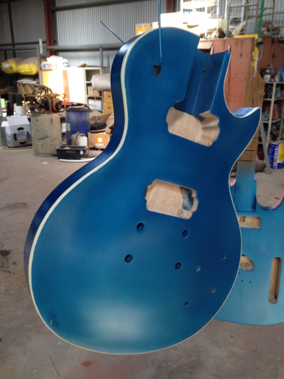

    I agree Wokka. The problem with the first coat was the DT in the grain underneath and the fact I used general purpose thinner with nitro lacquer (thanks to green shed advice) and 40 PSI at the spray gun. Since then I spoke with an auto painter and was recommended 2P thinner and 10 PSI at the spray gun. It now goes on beautifully. I can't get nitro thinner anywhere (even at auto paint suppliers).

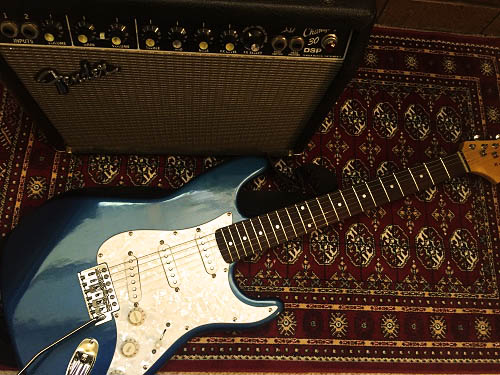

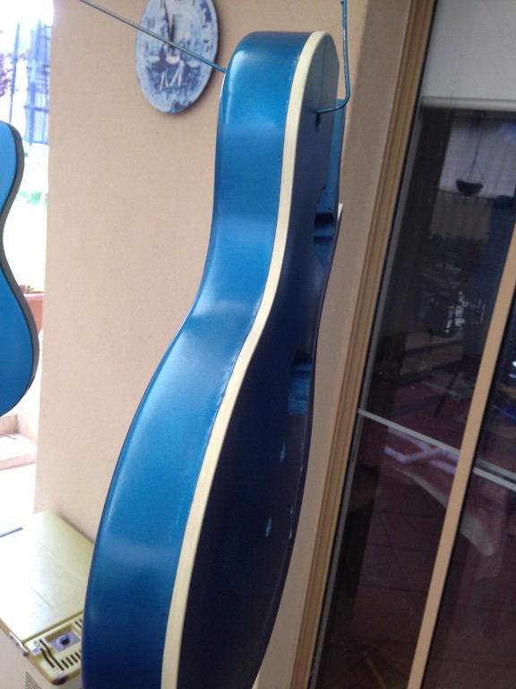

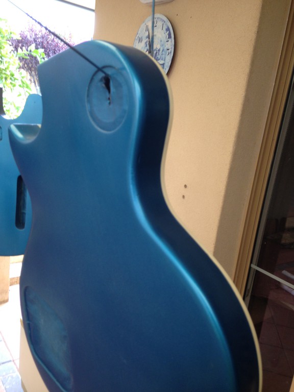

    Hi Salo, I like the colour you got out of that one.
    I did my ST-1 in Lake Placid Blue Nitro, just have a look at my build diary if you want to see.

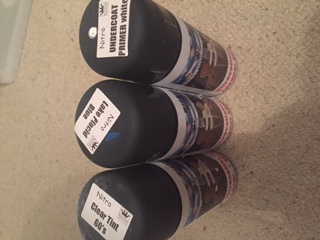

    I'm a bit of a noob and don't have a compressor, spray etc, so I used aerosols I sourced from Sydney Guitar set ups.
    I used Nitro white undercoat, Nitro Lake Placid Blue and clear with a 60's tint over the top (gave it a darker blue). I did the neck just with the 60's tint.
Name:	IMG_5901 - Copy.JPG
    As I used Aerosols, I did not need thinner, but I cannot tell you how many many many coats of nitro went on.
    I sprayed a couple of times when humidity was just over 50% and it went to poo so watch that, or you'll have to sand it back and start layering again.

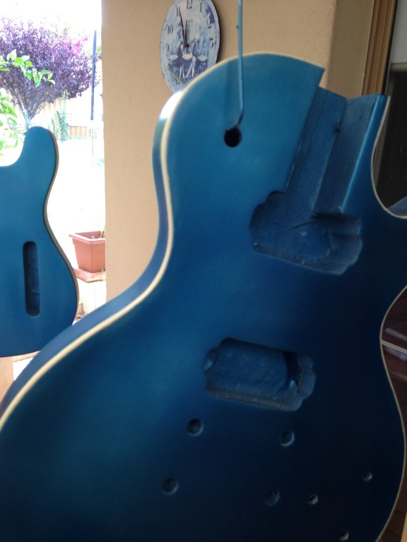

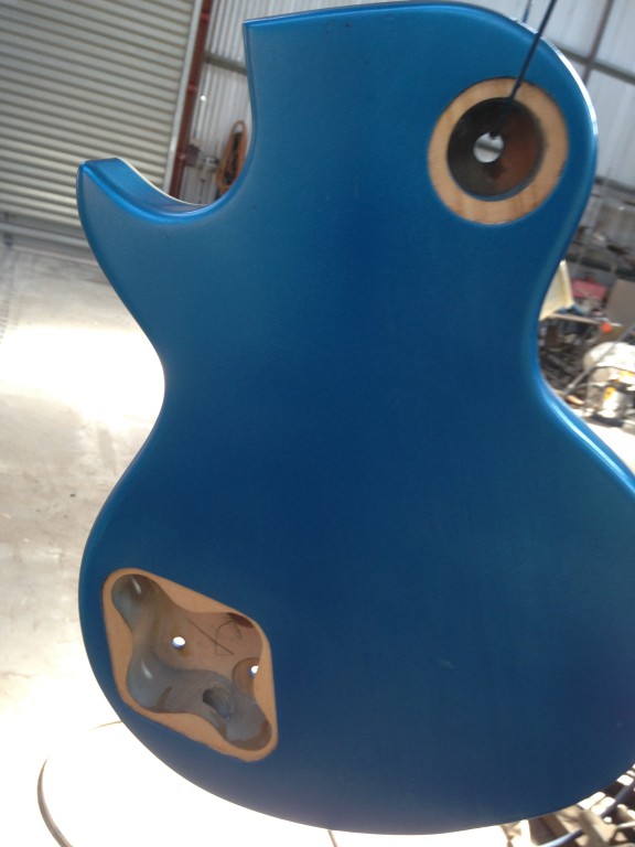

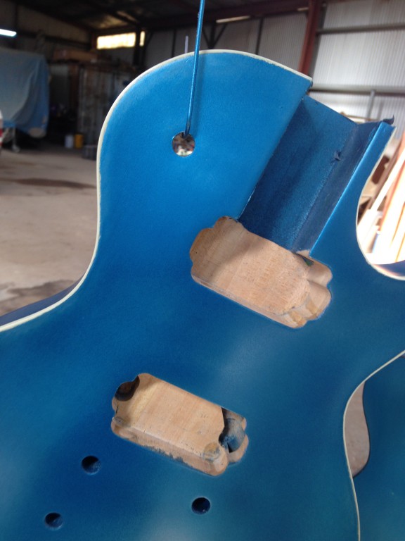

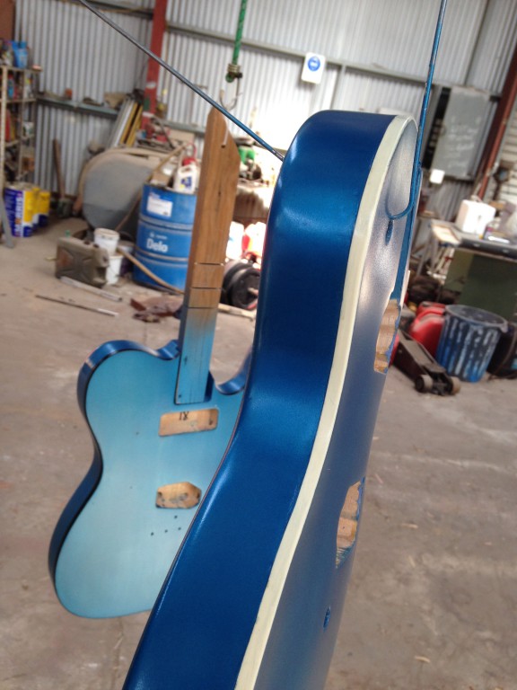

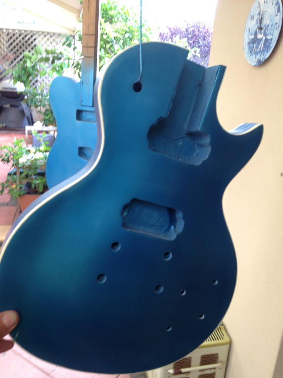

    Well my nitro clear coat from Victoria has finally arrived. I've given the LP one coat of clear coat and its starting to look really nice. Here is some photos Click image for larger version.
ID:	8875 Click image for larger version.
ID:	8878 Click image for larger version.
