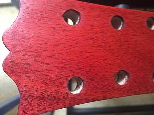

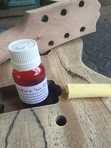

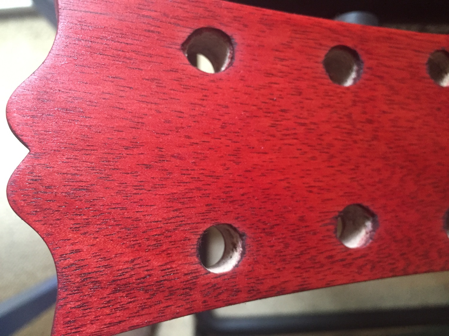

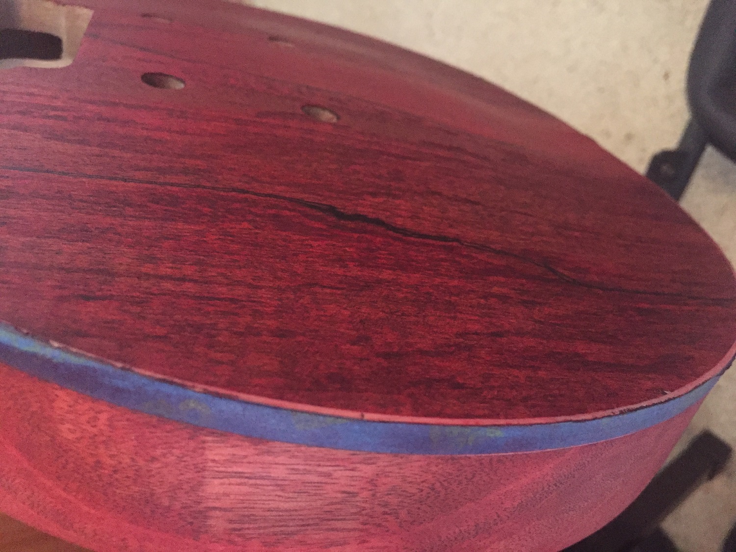

    What a morning! finished my sanding prep. donned the Nitrile gloves, ripped out my 5x5 100% cotton cloth and a fine bottle of Karijini Red.

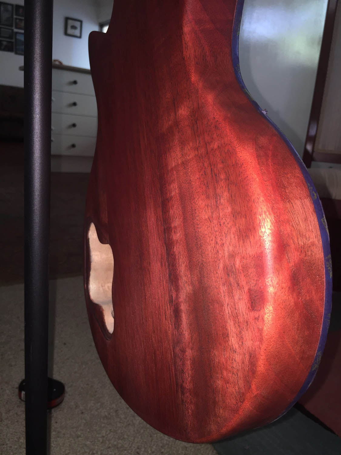

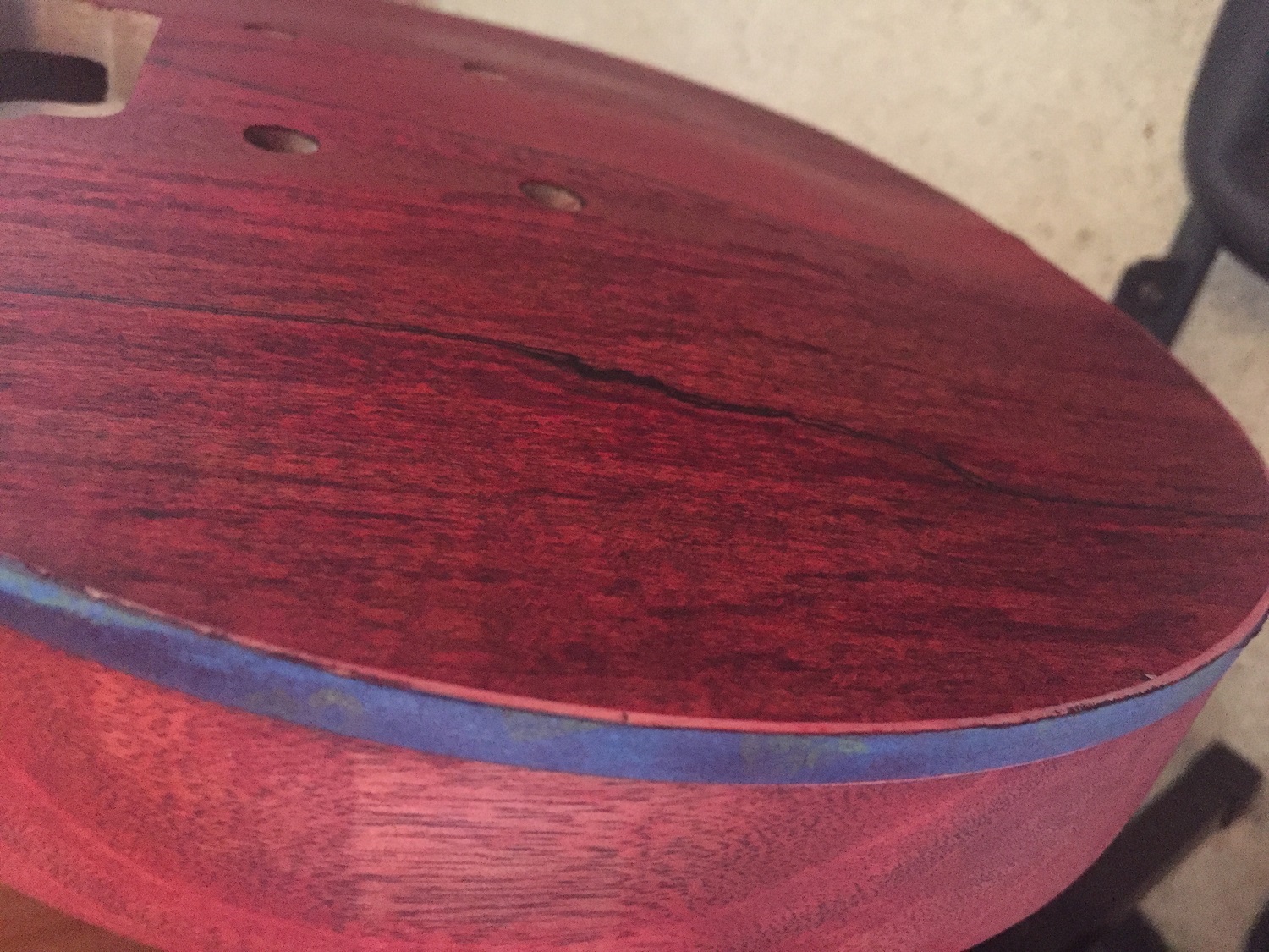

    It all went pretty fast, the rag was wet and red, there was a lot of rubbing involved...pretty sure I pitched a tent somewhere in there, but in the end one coat of Karijini Red was applied to the entire body and neck.

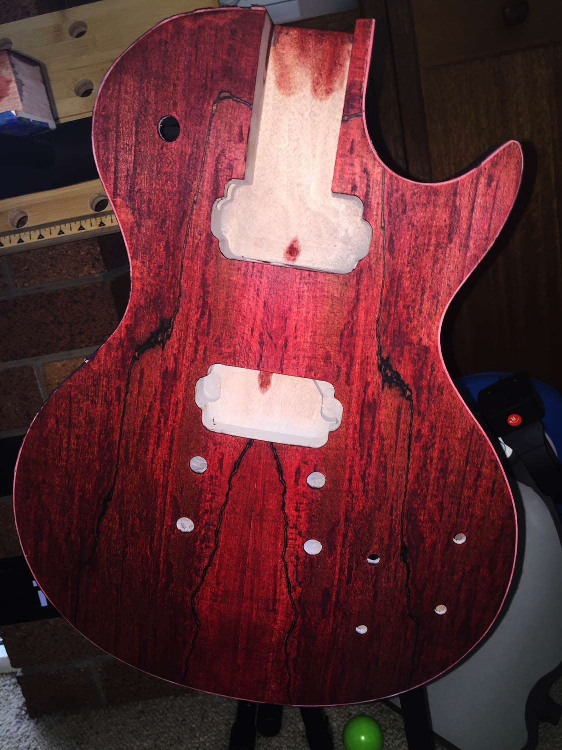

    I think because of the ebony timbermate The spalted maple is about as dark as i want it, I'd like the mahogany a bit darker so I might apply another coat on just the mahogany parts.
    Do I have to wait until its cured or can I apply the next stain coat whenever?

    nice one Andy that looks unreal. You got to be happy with that !
    If you applied the stain coat pretty heavy, DB normally says you should wait 2-3 days for the first coat to cure.
    It's usually ok to re-apply within an hour or 2 if it went on fairly lightly. On the safe side I'd let it cure.
    Can we please have an above photo of that lovely spalt cap ?

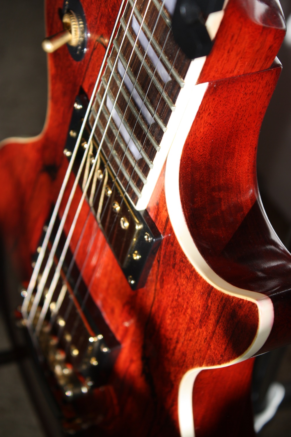

    Very happy indeed. Its gone a bit darker since leaving it. I did apply the dingotone stain very well so i think i will wait for it to cure properly and decide if i want to go darker on the mahogany. Here's some more photos (sorry I had to use the flash as the room was dark).

    looks excellent Andy. Worth being patient with DT and wait 3 days if you can between coats. You might consider a dark brown stain for back and sides of the body, I did that on my build and it gave a nice contrast with the karijini on the cap.
    How nice is the smell of DT ?
    You will find the colour will deepen as it cures so wait and see how it looks in a couple of days.
    Was that the back of the neck you have applied karijini ? Was thinking if the neck will be clear you could do a fret level. Was it you that we discussed this with this week about either getting the tools or getting DB to do a fret level?
    Thats why you need more than one build on the go so you can work on the other while this cures hahha it's called GAS !

    Yup, I'll wait for it to cure...I'm in no rush.
