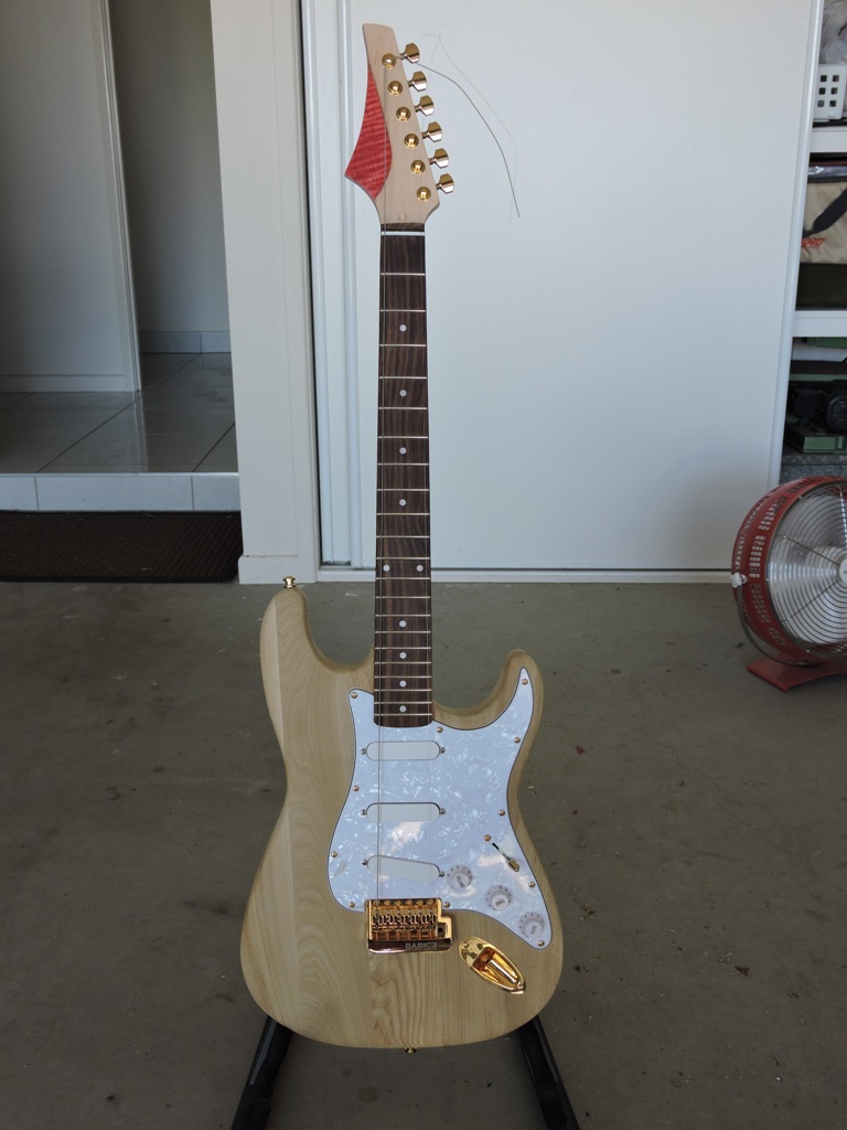

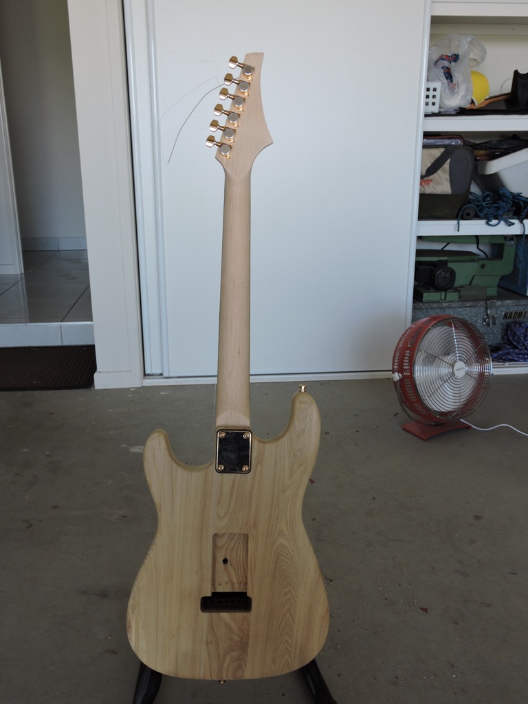

    Did a full bolt up today before starting on finishes.
    Have to trim the bridge bolts a bit before final build but no biggy.
    Got some lefty Gotoh locking tuners to complete the upgrades.
    Now just final sanding of neck and body and hopefully get a first coat of Karijini on the body this weekend.
    Almost seems a pity to put colour on this timber.

    very sexy looking axe Tony, are you putting karijini on the body as well ? Clear neck ?
    That gold hardware looks the biz and that Babicz bridge goodness !
    Have you measured the resistance of the 3 Tonerider pups ?

    Trim those bridge screws then glue some of that flamed headstock veneer into the spring cavity, clear cover + Karijini = wow.

    Woks, Going Karijini on the body with a clear neck. Toneriders all checked and as per tags and solid covers put on instead of the standards.

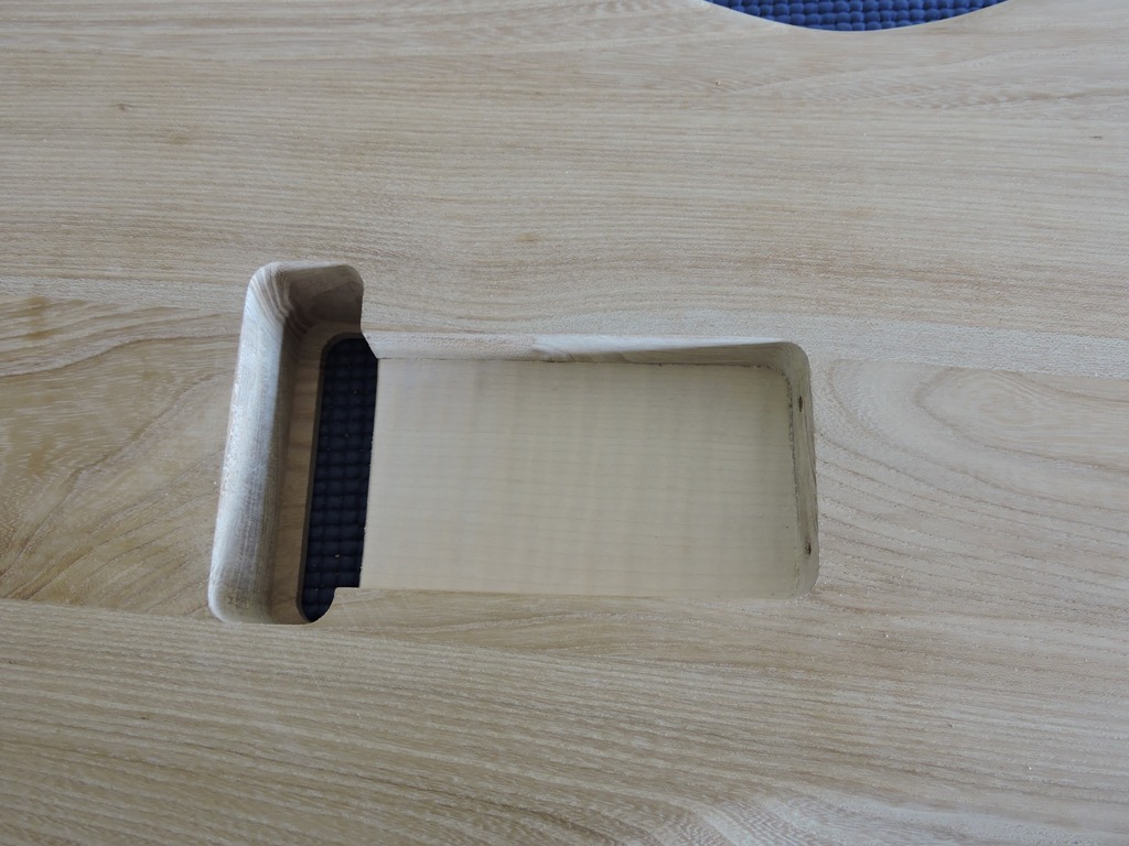

    Cool Idea Weirdy. While not totally sold on the idea its always good to keep the options open, so cut and glued a piece of maple into the cavity with good old 406. If I do go this way, have seen some gold springs and claw somewhere on the net and would have to get a clear backplate cut.

  7. #47
    yeah that will look cool Tony, have to leave the trem plate off but you could stain it a different colour and even put a logo there
  8. #48
    how about a perspex trem cover with an etched logo....
