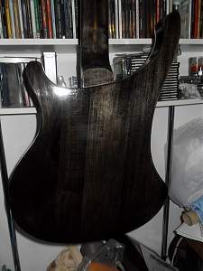

    The action was good, there is scope for raising the action on the tail unit, as soon as i get chance i'll do another mock up and get some shots, its had another coat of tru-oil tonight and i've hung it to cure.
    So far so good shine building nicely.

    looking nice and shiny Paul, how many coats of naughty oil is that?
  7. #47
    Member Paul C's Avatar
    Nov 2015
    St Helens, Lancashire England
    49
    3rd coat, but only really had one good coat as the first two got rubbed down to flat off, should take around 5 then try a buff to see how it polishes up.

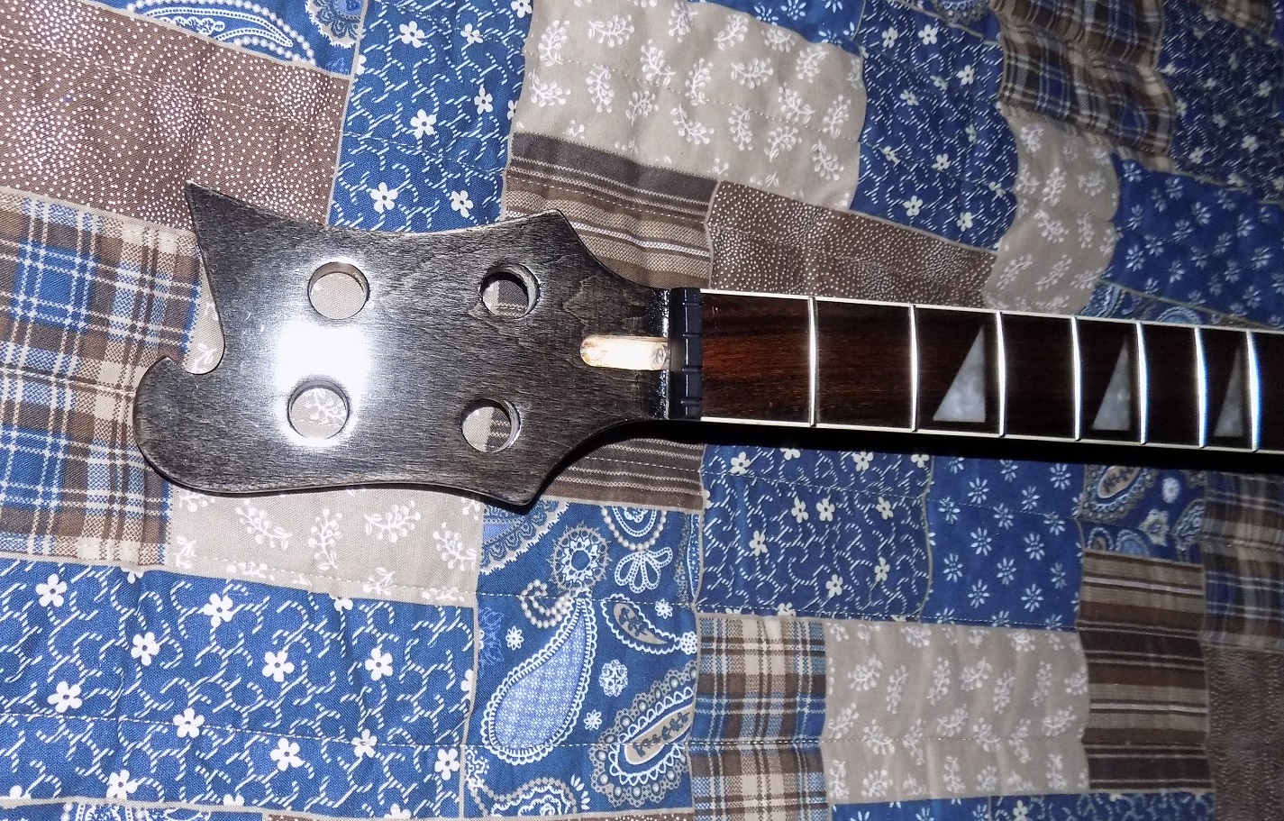

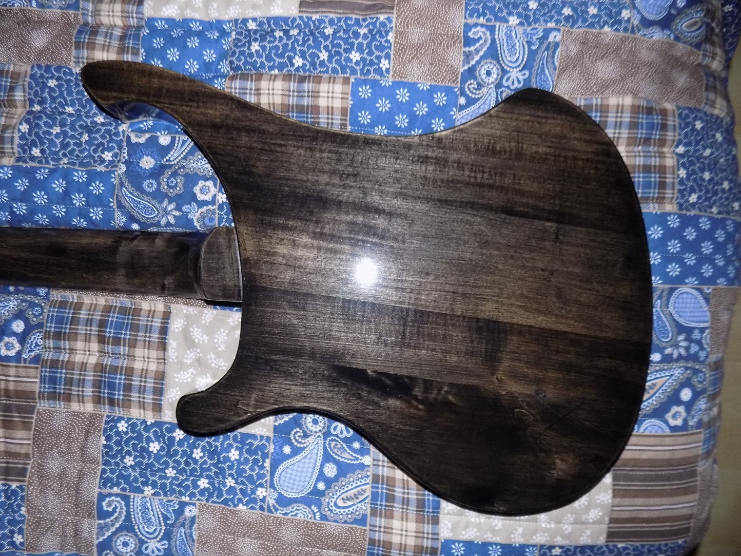

    December update
    Greetings all, well time to update and as i had my birthday recently i am in possession of a mighty fine new camera, its a Nikon L330, courtesy of my lovely wife. So a few snaps of my progress, which has been adding layers of tru-oil to build up then leveling back using P2000 and P2500 rubbing papers, it's a slow process but each time the finish gets better, current photos show it prior to being leveled and buffed to check the finish (its getting close to me being happy with it).

    i have ordered some items off eBay for other projects but spotted a Humbucker pickup for a bass for a bargain price, not sure if i'll use it on my Rick or sell it on.
    All in all i'm happy with the progress, i can spot the issues, scars and blemishes within the timber that are only highlighted by the flash and if i decide to do another one maybe the Ash top i can watch out for these and eradicate or disguise them.
