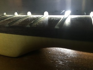

    check out the bow

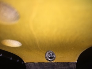

    I'm having difficulty adjusting the truss rod. 4mm won't fit. 3.5 mm fits but doesn't seem to be tight enough.Name:  IMG_5781.JPG
  3. #43
    Found the one with the kit, fits perfectly....
  4. #44
    That's a relief
    Sometimes the truss rod end can sit a little askew in its slot under tension which can make it really difficult to get the allen key seated... not something you want to find out after the finish is on. It's now one of the things I check during the initial mock build for F-type headstocks, just to be safe.

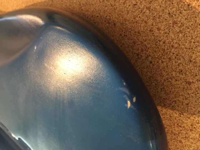

    Update:
    Scuffed the colour off the body by accident.
    sanded, re-applied colour and clear coats, the last clear coat applied when it was too humid again clouded over
    sigh
    sanded again then re-applied clear coat a week later.

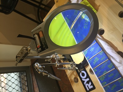

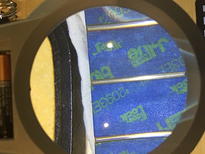

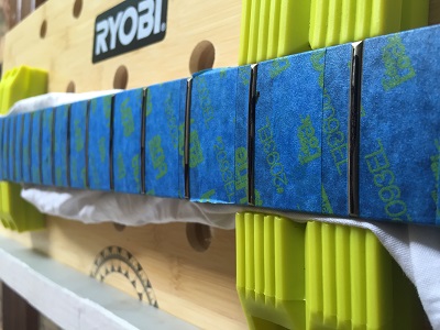

    So with the home made notched straight edge and adjusting the truss rod slightly the bow in the neck was sorted.
    Nylon hammer used to carefully knock certain frets into seat using DB's "sand bag" with two zip ties.
    Made a leveling beam from a 25.4 x 25.4 x 1.2mm x 450 mm aluminum rod, double sided tape and select sandpaper. Followed Gav's instructions with a sharpie on the frets and leveling beam but as i don't have special tools had to crown each fret by hand with a triangular file and different grits of sandpaper, 0000 steel wool and metal polish.

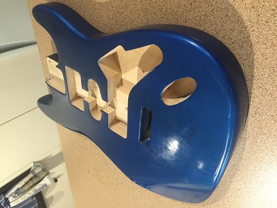

  12. #50

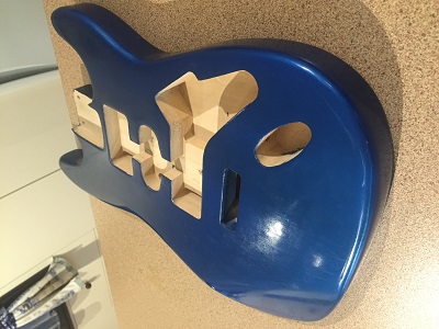

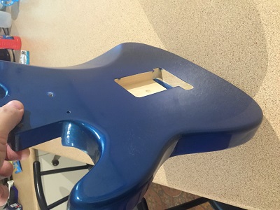

    Body repaired the other days so now cut and polished.
