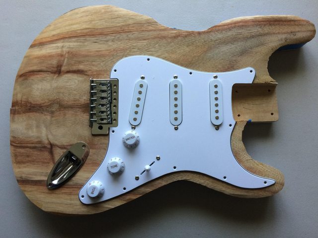

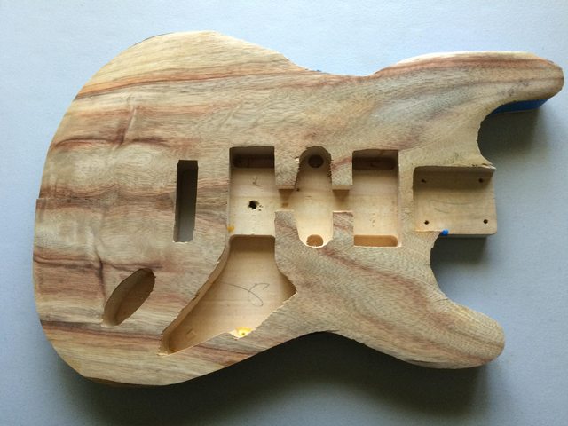

    Second section glued down.
    And with the hardware dropped in place.
    Next is softening up the edges again and carving them so they curl around the body a bit to glue them down. Avoid the compound curves as much as possible and smooth it out.
    Then sand a smooth transition from the veneer to the body.
    And clean up the glue.

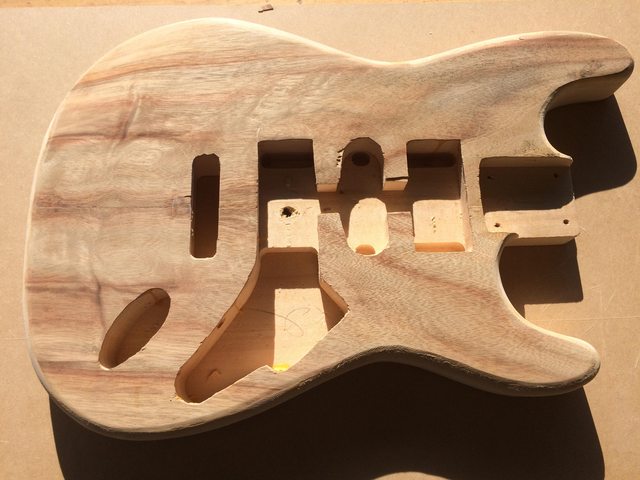

    Tried and gave up with trying to make the veneer curl around the edges. The compound curves were too much. Veneer just isn't stretchy enough.
    Reverted back to what I've seen on other veneer fronted guitar and sanded the edges to meet the body.
    Not finished cleaning it up yet, but pretty happy so far.
    Was considering a burst to disguise the edges, but seeing it in the sunlight like that I think I just want to stick with amber all over.
    - Sam
    IB-6S - done.
