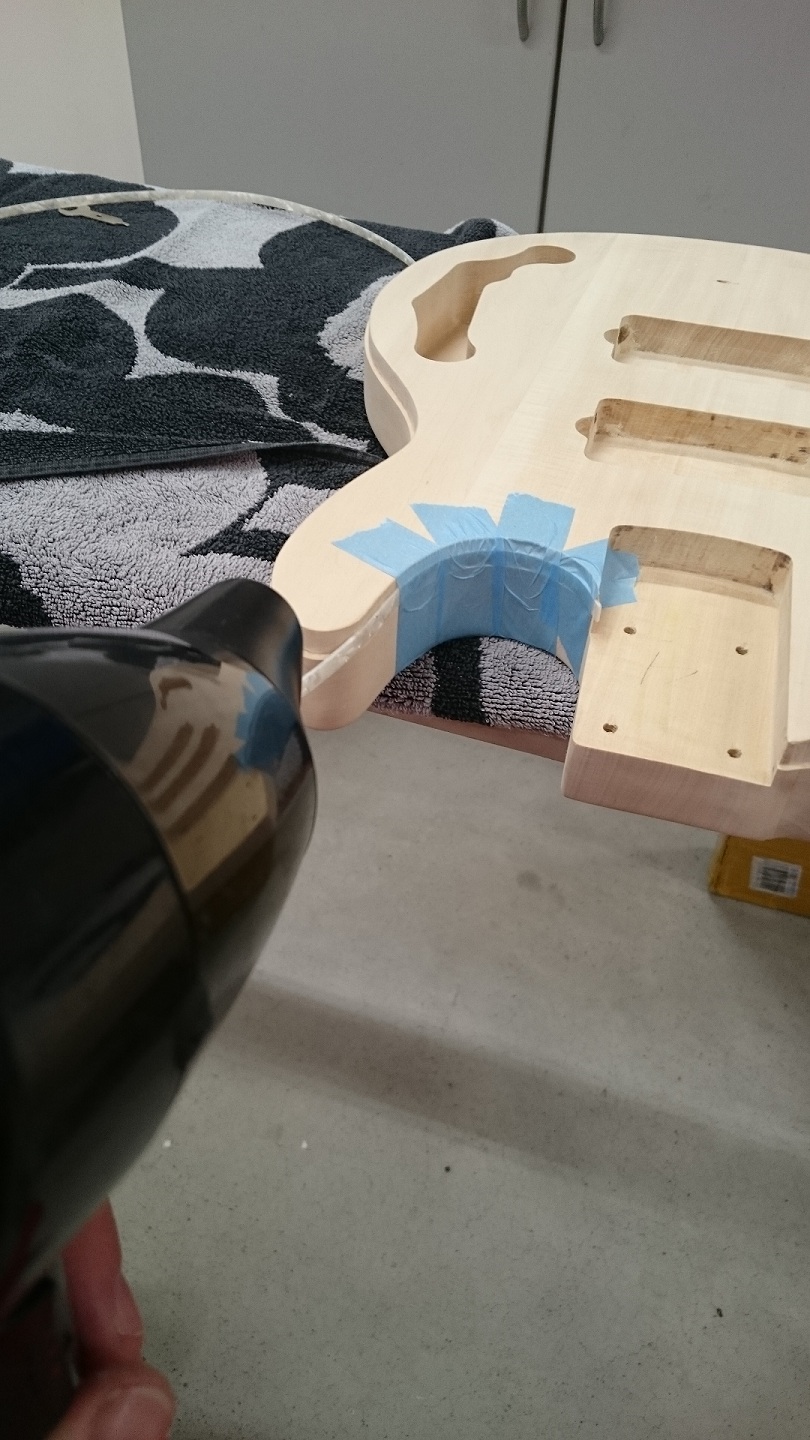

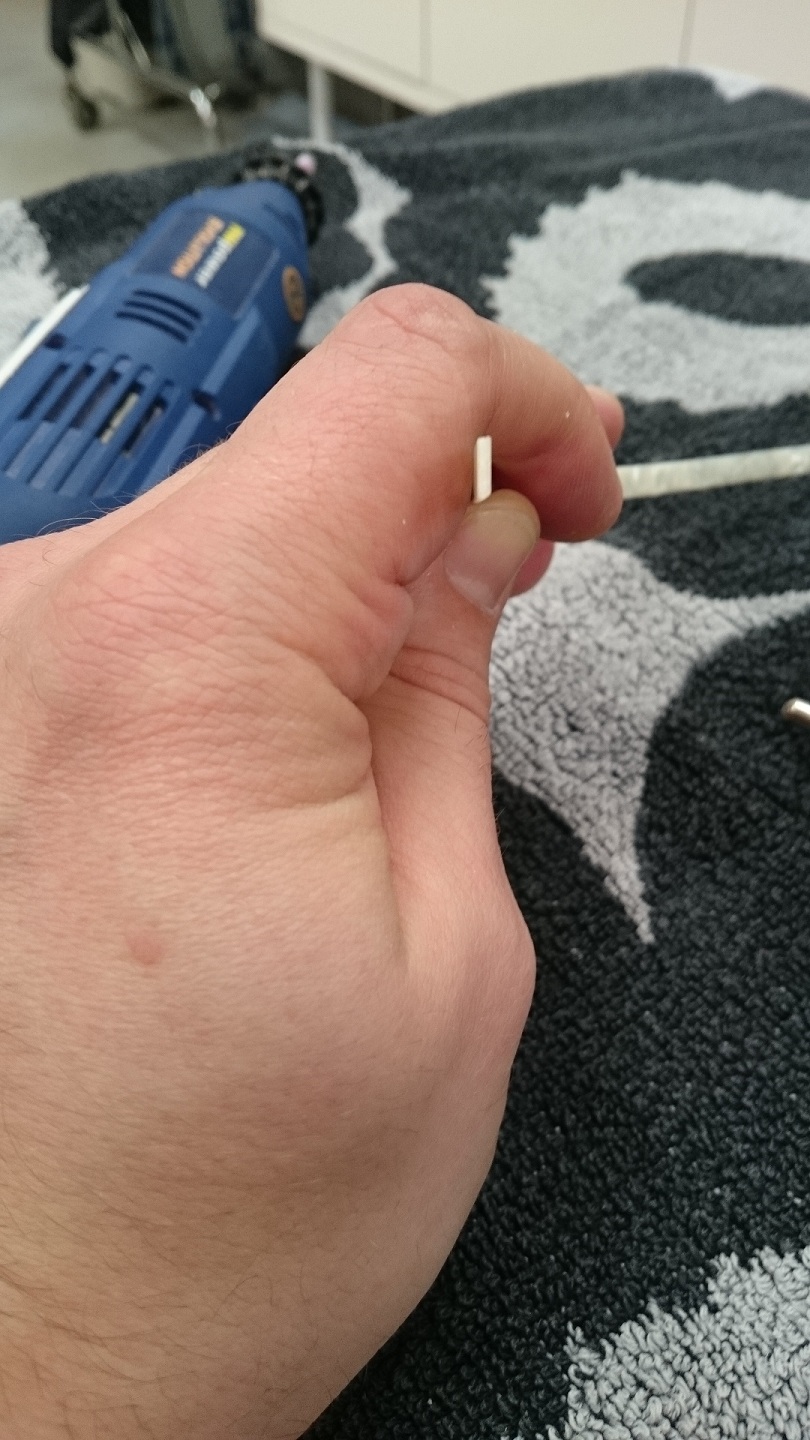

    so I tried to attach the binding today. I say tried cause I donīt know how it worked out yet. I know it didnīt go the way I planned it but these photos tell more than a thousand words:

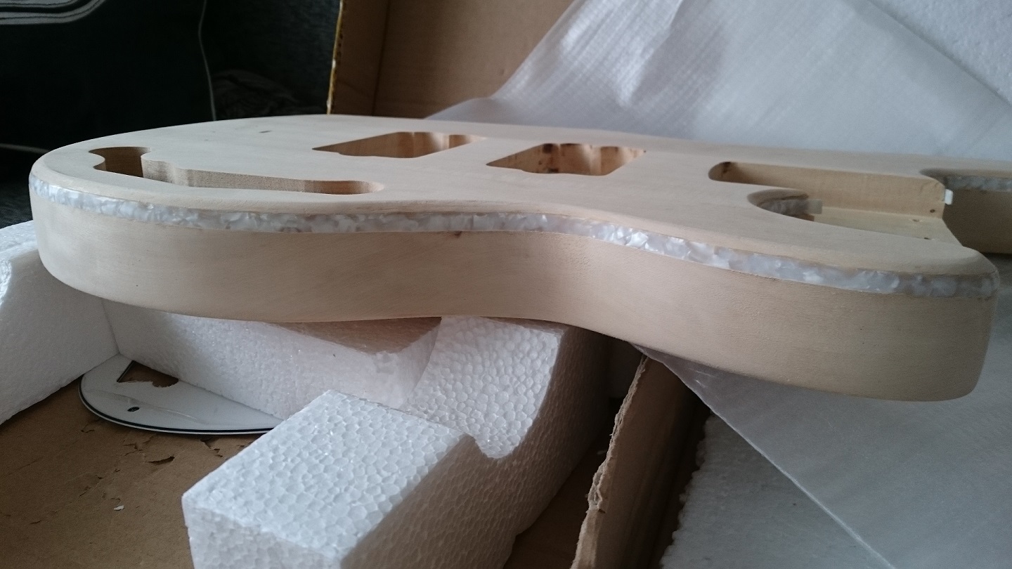

    First I beveled the lower edge of the binding to make it sit better on the not so steady channel:
    Then I shaped the binding to the body by heating it and bending it using a hair dryer for help:

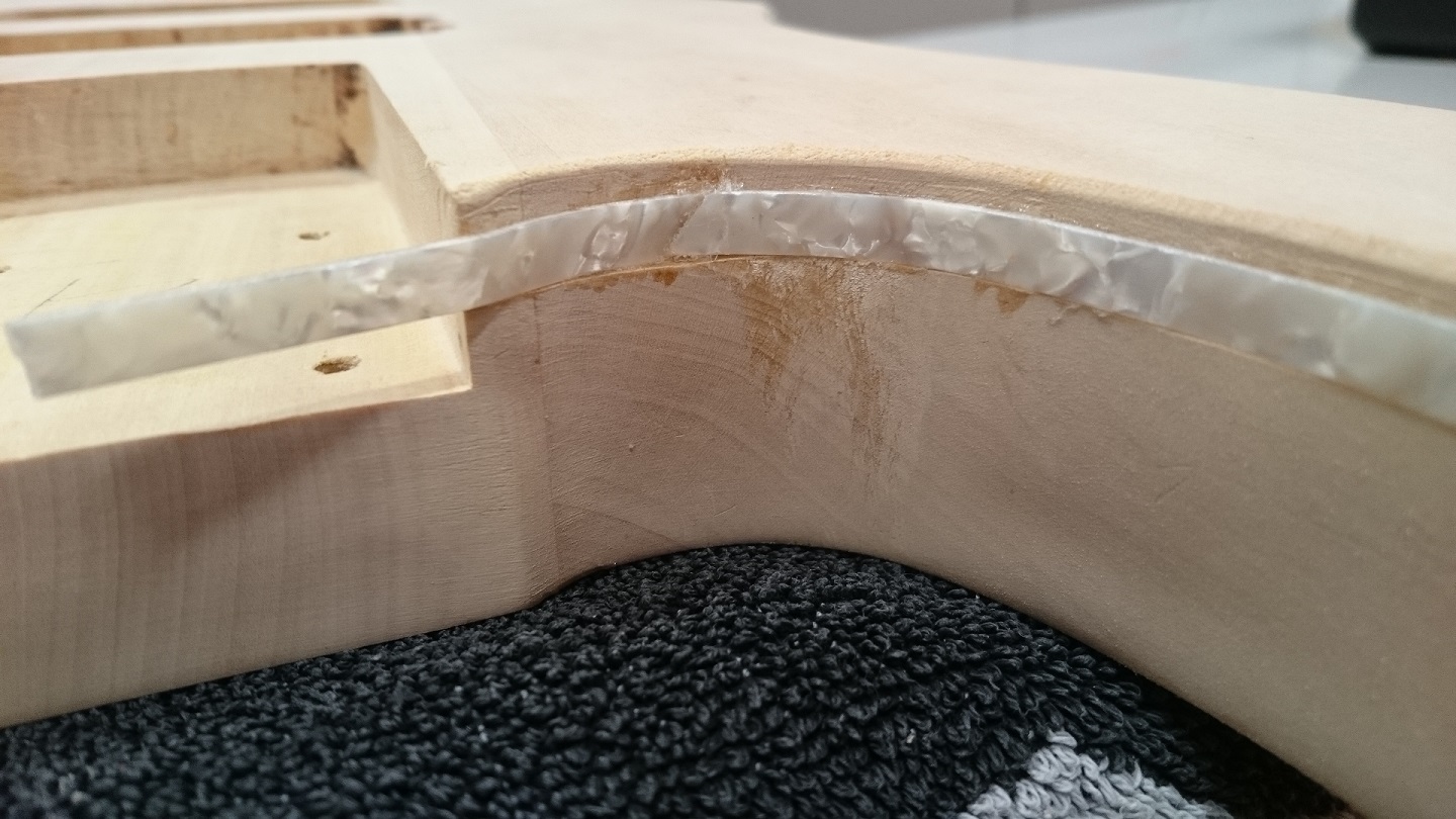

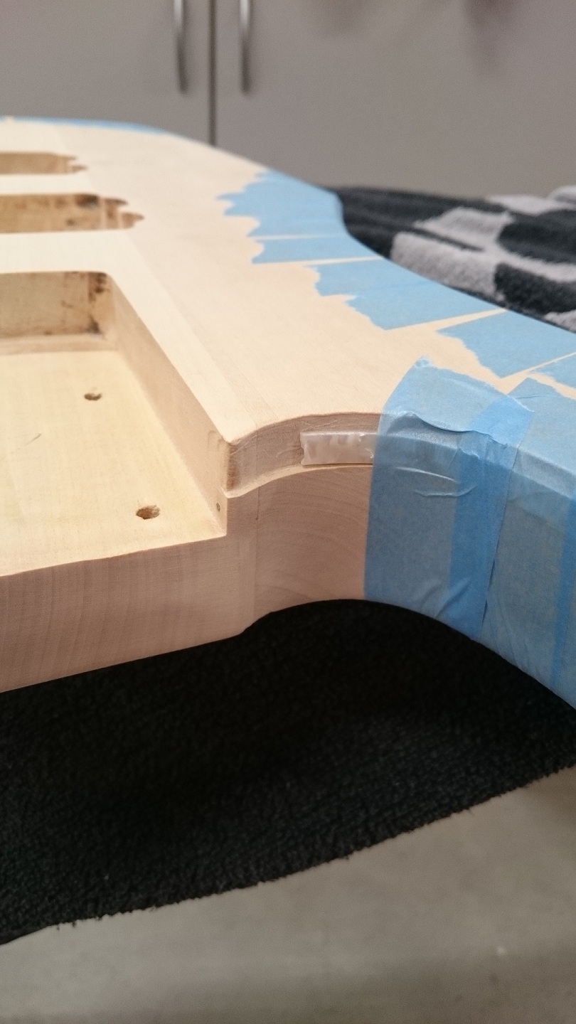

    So far so good until - HOW ANNOYING IS THAT:
    When I finally pulled myself together I decided to patch this with a piece of binding I had left from the routing job. I donīt have a photo of how this worked out yet but I know itīs not good for now. Might be able to sand it acceptable at least...

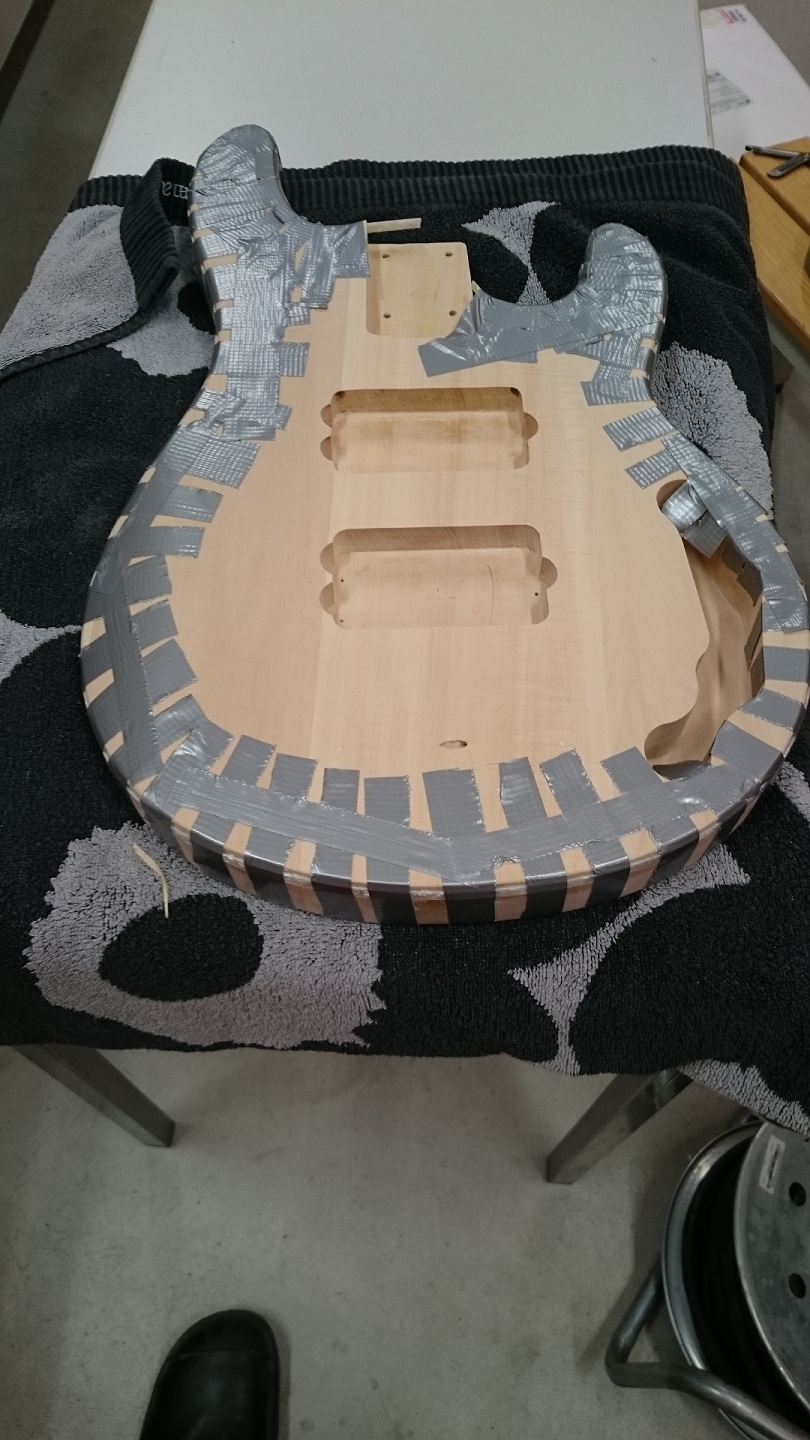

    Glued the binding in place and I have a feeling that the whole job went sideways... After I got the last bit taped, the first 5cm I glued seemed to stick out and had come off. Had to put more glue on and found out at this point that the binding had twisted and wanted to point upwards. Could be some kind of chemical reaction from the glue - I donīt know.
    I used Loctiteīs product that is basically a fast superglue but with a delay of approx 5 minutes to adjust what Iīm doing. It should be ok to use on basically any material and Iīve used it before to glue for example bone nuts and itīs been great for that.
    Anyway - since I donīt get my hands on Tarzan grip I had to use what I could. NOT so professional looking but then again - Iīm not one.
    The glue should be on itīs full strength in 24 hours so tomorrow weīll see if I have to go to plan B and shape the body again not using any binding.
    Will keep my fingers crossed...

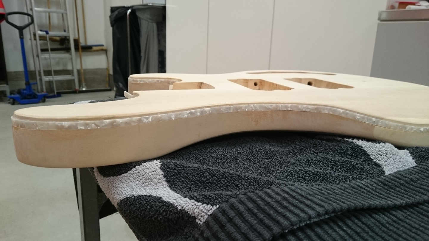

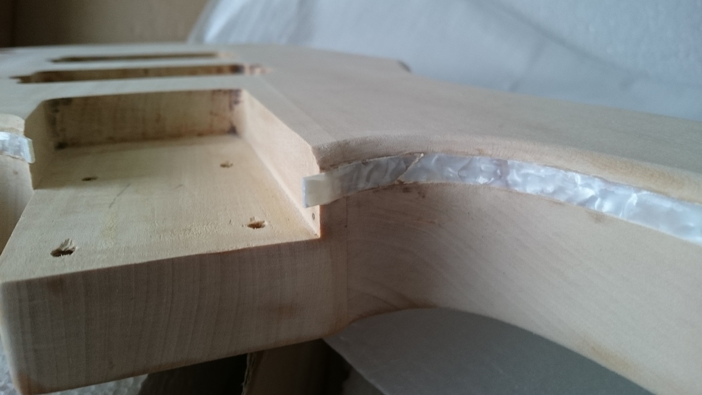

    So I removed the tapes and the result was... not so bad as there are some areas I need to work on but I think I know how.
    So - this was how it looked under the tapes:
    This one raised mu blood pressure...:
    To be continued...

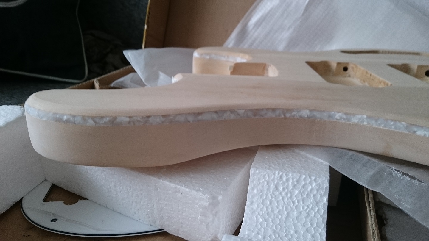

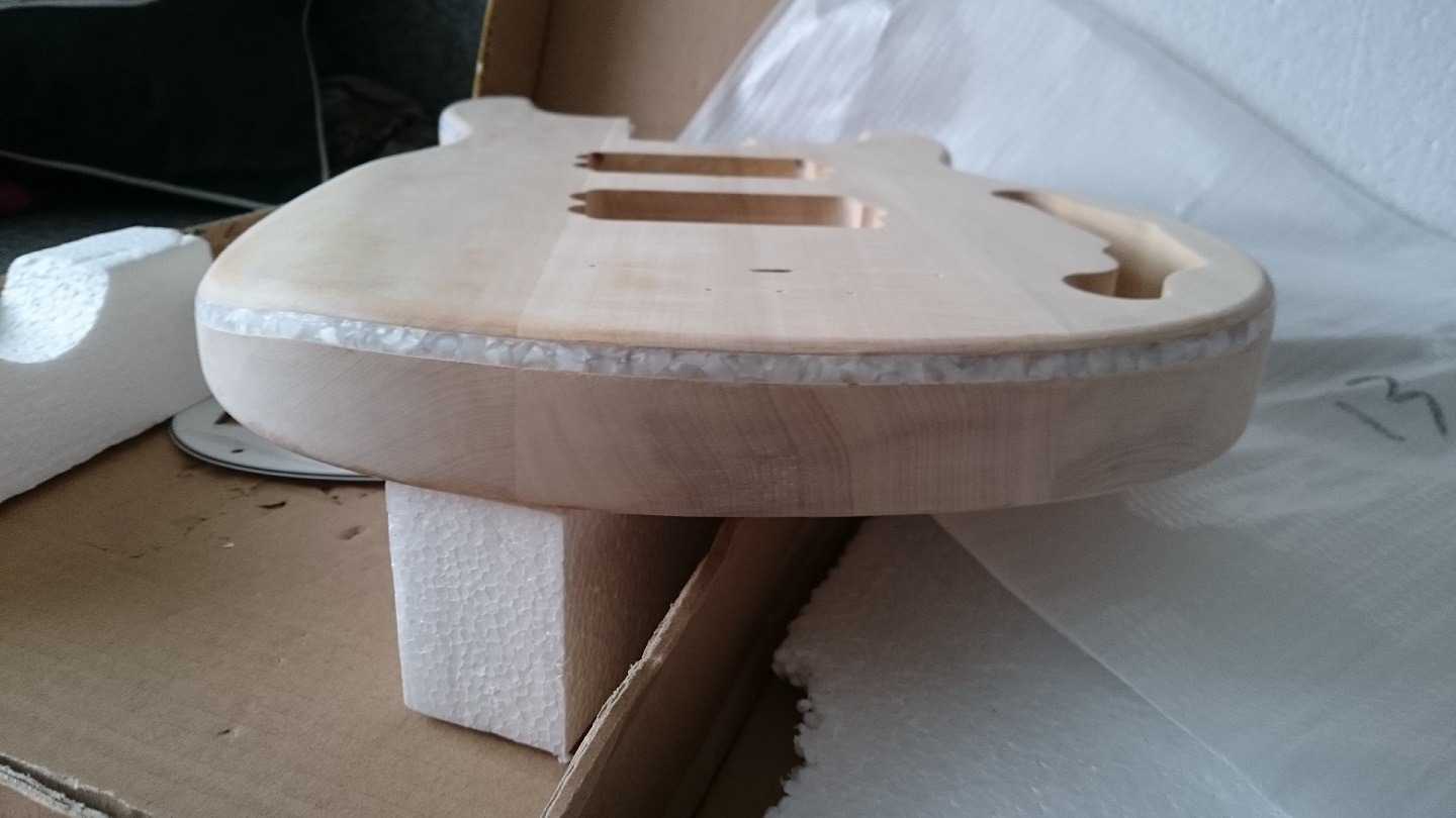

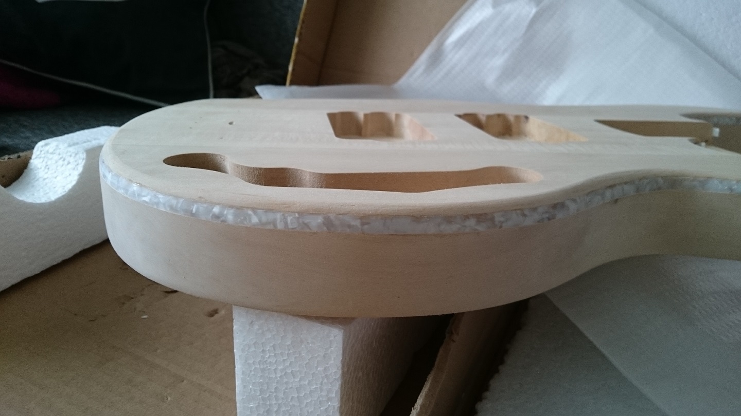

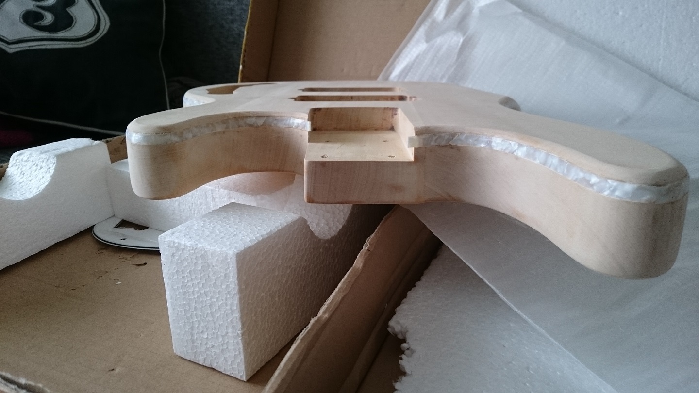

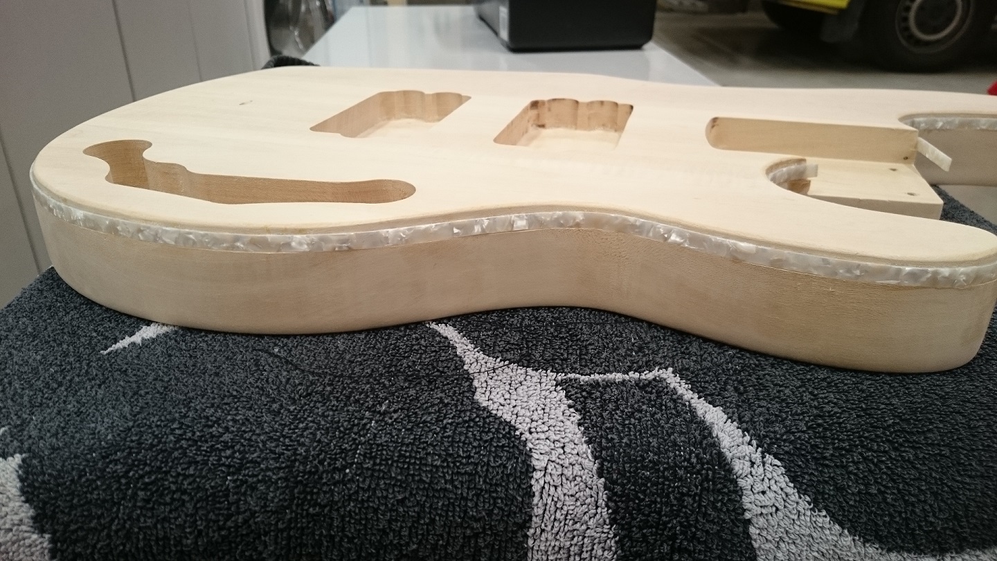

    And after preliminary sanding this is the way it looks now:

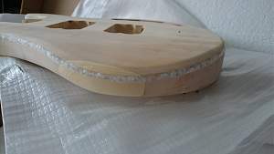

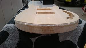

    To be continued...

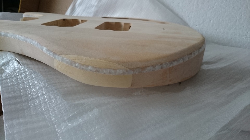

    This and couple of small cracks Iīm gonna seal and smoot with a paste made of acetone and pieces of the same binding. Just melt these with each other and when the acetone evaporates the plastic hardens. Then itīs time for sanding again. Especially gonna need that with these:
    Iīm also gonna sand the edges more to fade them in to the top and this way fade those differences (waves) in the binding in contrast to the top. Hopefully this will work. The glue I used seems to be still "rubbery" next to the binding and difficult to sand.
    Will post when I make more progress.
    Looks kinda nice and exciting - looks flush even though itīs not...
