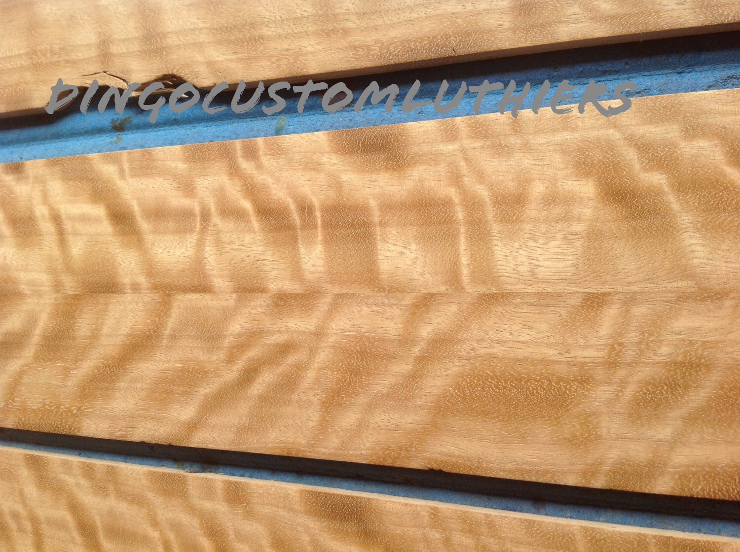

    Look what I found in the Man Cave today...
    Then some progress on Barri..

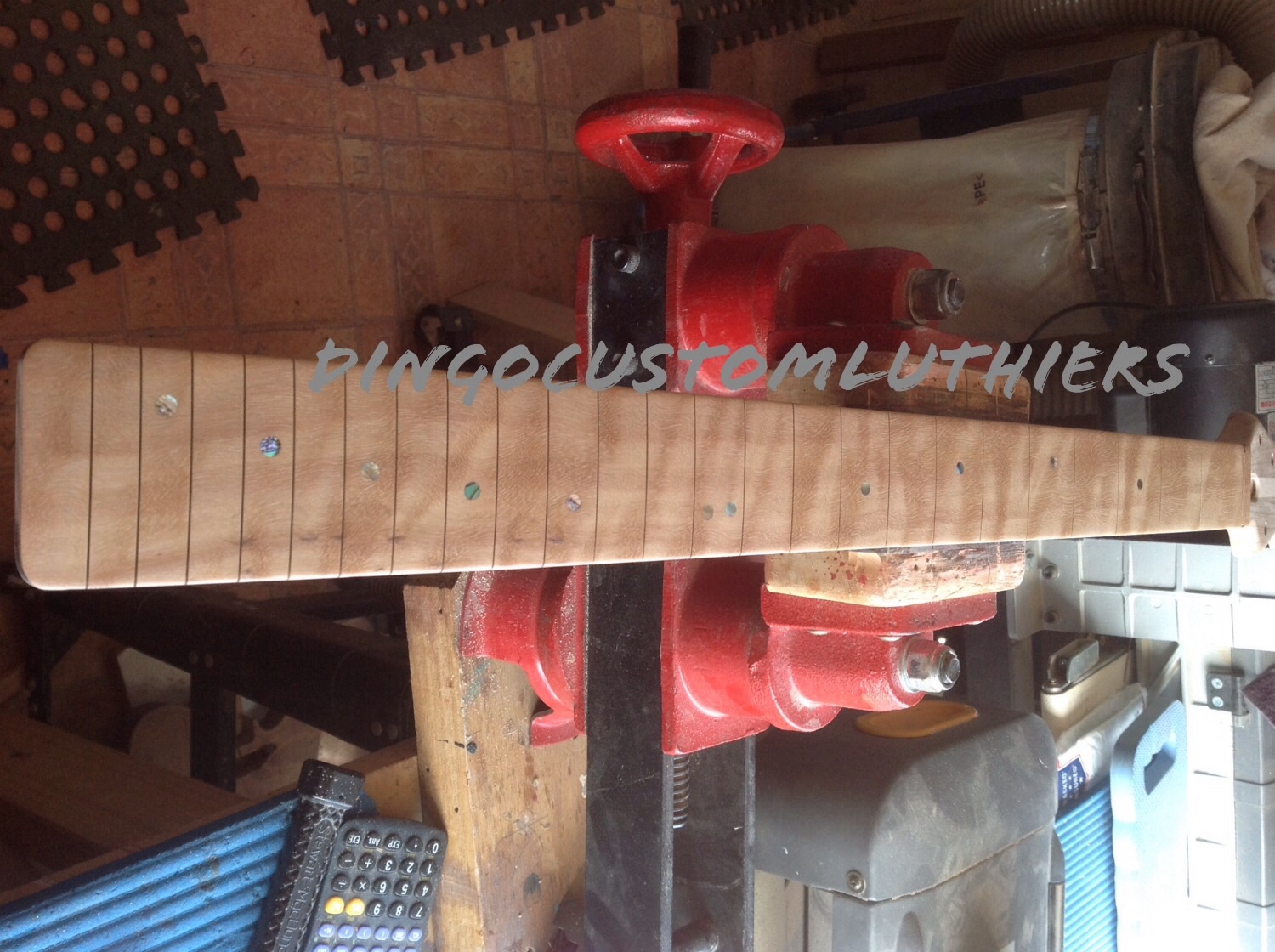

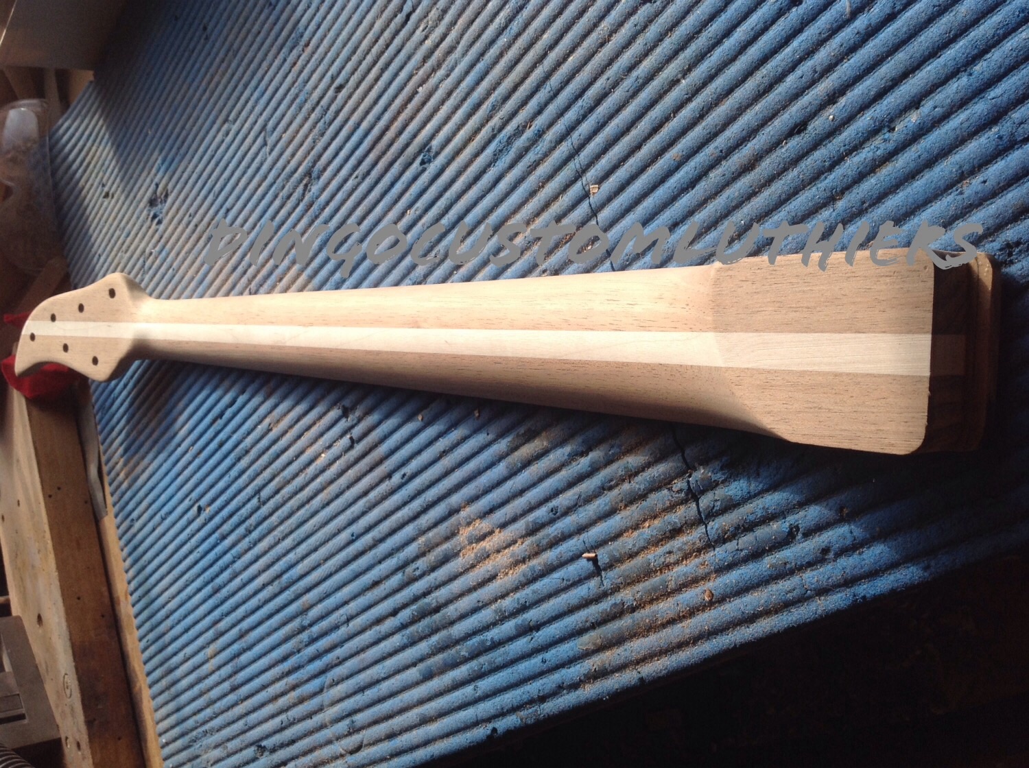

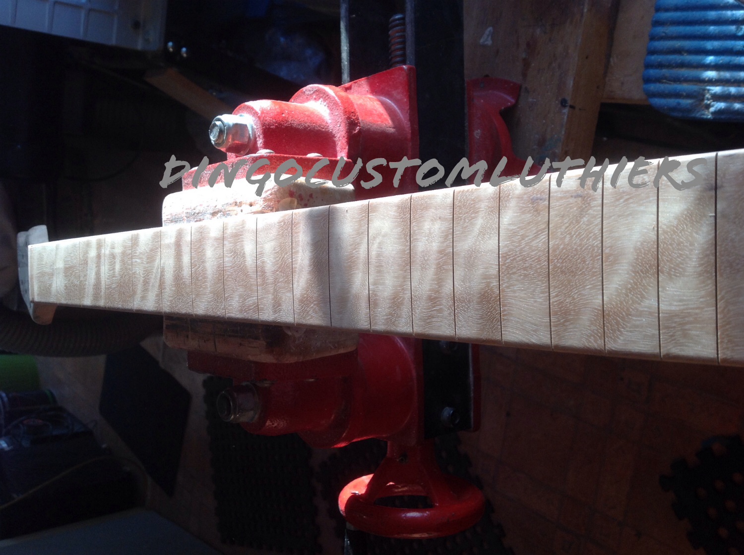

    Fret slots cut old school style
ID:	5048   Click image for larger version.
ID:	5049   Click image for larger version.
ID:	5050   Click image for larger version.

    I might have to proxy this very page now DB.... Are they 2 piece fretboard blanks?
  3. #43
    Moderator dingobass's Avatar
    4,491
    They are two piece fingerboards.

    I am seriously lost for words DB they are beautiful and I bet those pics don't do it ANY justice!

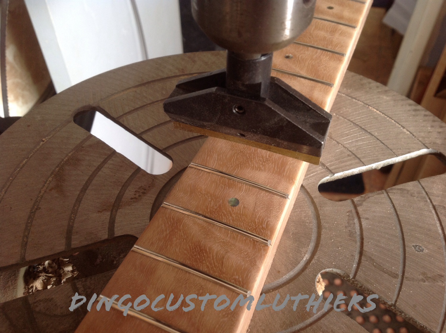

    Neck 99% done.
    Dot inlays, check.
    Polish fret board to 2500 grit W&D, check.
    Speed humps...errr... Frets, check.
    Initial fret level, check.
    Carve neck profile and sand to 400grit, check.
    Just needs bone nut, fret crown and finish applied...
    I will let it sit in the workshop for a few days before I hit it with grain fillers and sealer.

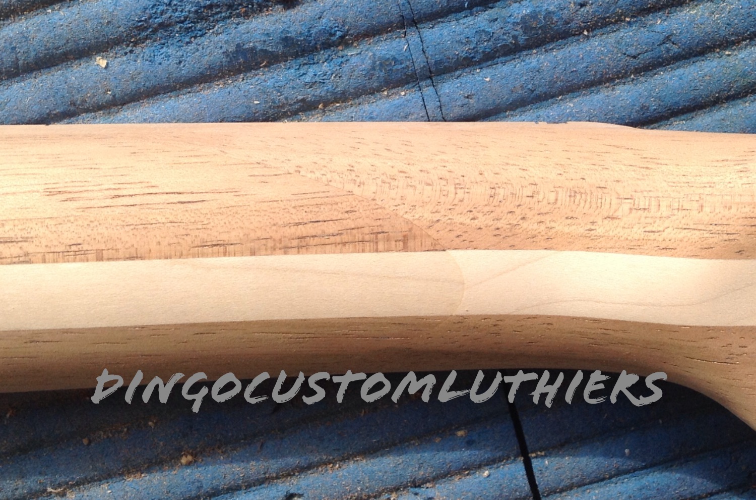

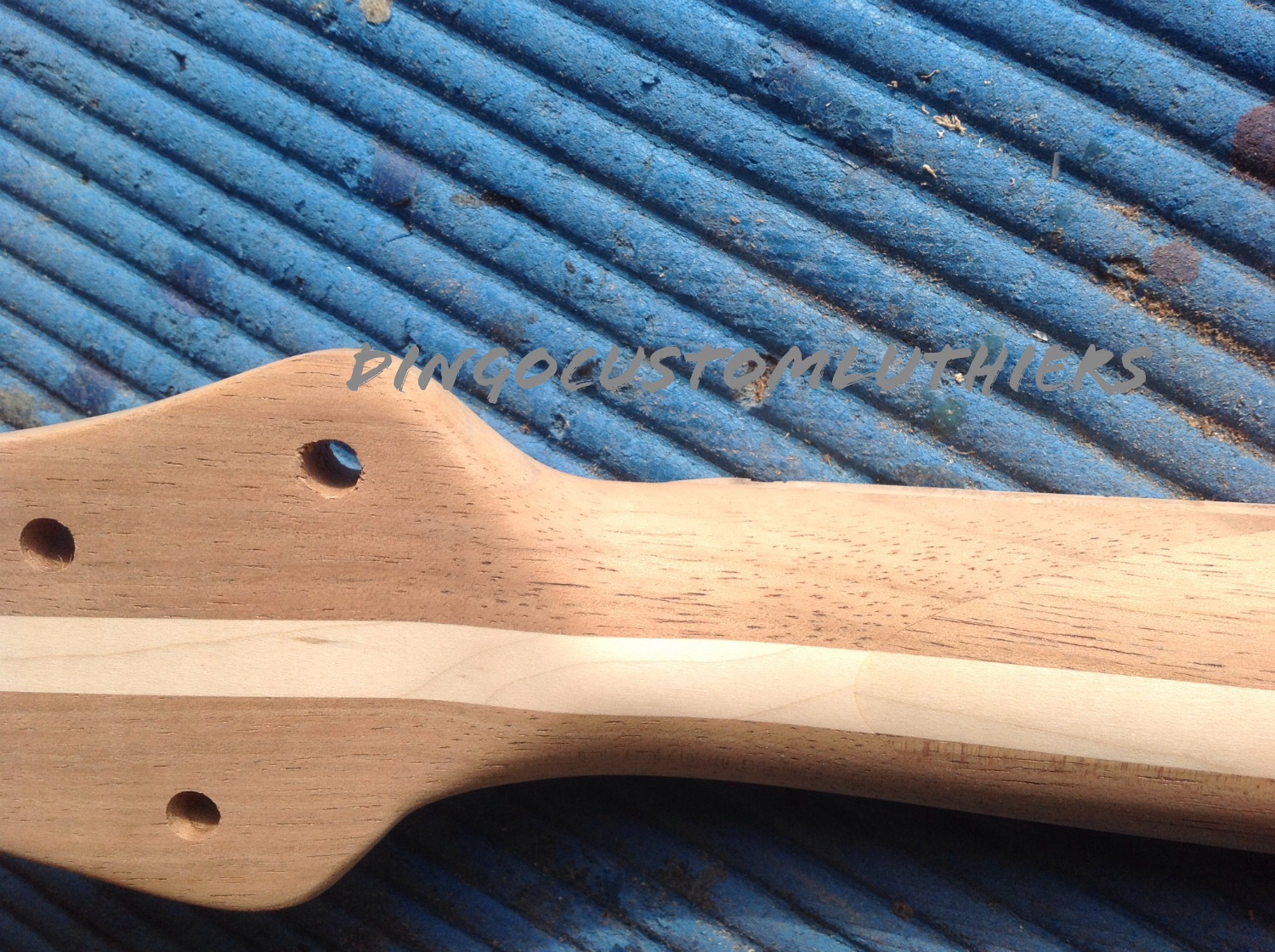

    Check out the sexy scarf joint
ID:	5060   Click image for larger version.
ID:	5061   Click image for larger version.
ID:	5062   Click image for larger version.
ID:	5063   Click image for larger version.
